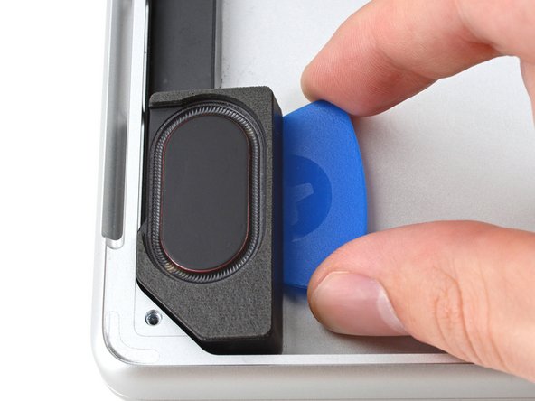

  3. MacBook Pro 16" 2021 Speaker Assembly Replacement, Release the rear cover's right clips: crwdns2935265:03crwdnd2935265:01crwdnd2935265:03crwdne2935265:0 MacBook Pro 16" 2021 Speaker Assembly Replacement, Release the rear cover's right clips: crwdns2935265:03crwdnd2935265:02crwdnd2935265:03crwdne2935265:0 MacBook Pro 16" 2021 Speaker Assembly Replacement, Release the rear cover's right clips: crwdns2935265:03crwdnd2935265:03crwdnd2935265:03crwdne2935265:0
    • Insert an opening pick into the gap you just created.
    • Slide the opening pick around the nearest corner and then halfway up the side of the MacBook Pro.
    • This releases the first of the hidden clips securing the lower case. You should feel and hear the clip pop free.

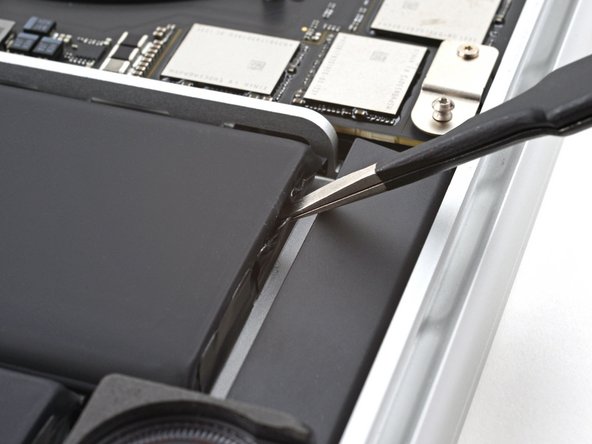

  64. MacBook Pro 16" 2021 Speaker Assembly Replacement, Remove the stretch release adhesive: crwdns2935265:064crwdnd2935265:01crwdnd2935265:02crwdne2935265:0 MacBook Pro 16" 2021 Speaker Assembly Replacement, Remove the stretch release adhesive: crwdns2935265:064crwdnd2935265:02crwdnd2935265:02crwdne2935265:0
    • Use tweezers, or your fingers, to grasp the black pull-tab on one of the adhesive strips.
  65. MacBook Pro 16" 2021 Speaker Assembly Replacement: crwdns2935265:065crwdnd2935265:01crwdnd2935265:01crwdne2935265:0
    • Pull the strip out slowly and steadily at a low angle. Give it plenty of time to stretch and un-stick from under the battery.
    • If the adhesive strip breaks off, try to retrieve it using your fingers or blunt tweezers, and continue pulling—but do not pry under the battery.
    • Repeat the process for all 14 stretch release adhesive strips.

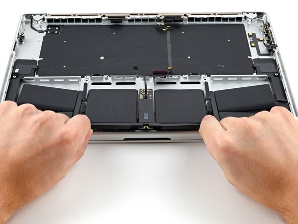

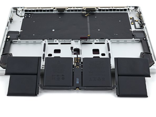

  66. MacBook Pro 16" 2021 Speaker Assembly Replacement, Remove the battery: crwdns2935265:066crwdnd2935265:01crwdnd2935265:03crwdne2935265:0 MacBook Pro 16" 2021 Speaker Assembly Replacement, Remove the battery: crwdns2935265:066crwdnd2935265:02crwdnd2935265:03crwdne2935265:0 MacBook Pro 16" 2021 Speaker Assembly Replacement, Remove the battery: crwdns2935265:066crwdnd2935265:03crwdnd2935265:03crwdne2935265:0
    • Slide the battery out of the frame to remove it.

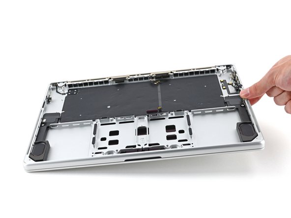

  67. MacBook Pro 16" 2021 Speaker Assembly Replacement, Apply isopropyl alcohol: crwdns2935265:067crwdnd2935265:01crwdnd2935265:03crwdne2935265:0 MacBook Pro 16" 2021 Speaker Assembly Replacement, Apply isopropyl alcohol: crwdns2935265:067crwdnd2935265:02crwdnd2935265:03crwdne2935265:0 MacBook Pro 16" 2021 Speaker Assembly Replacement, Apply isopropyl alcohol: crwdns2935265:067crwdnd2935265:03crwdnd2935265:03crwdne2935265:0
    • Apply a few drops of isopropyl alcohol along the edges of the speaker.
  68. MacBook Pro 16" 2021 Speaker Assembly Replacement: crwdns2935265:068crwdnd2935265:01crwdnd2935265:02crwdne2935265:0 MacBook Pro 16" 2021 Speaker Assembly Replacement: crwdns2935265:068crwdnd2935265:02crwdnd2935265:02crwdne2935265:0
    • Tilt the right edge of the device upward to allow the isopropyl alcohol to work its way underneath the speaker.
    • Hold for 1–2 minutes to allow time for the isopropyl alcohol to weaken the adhesive.
  69. MacBook Pro 16" 2021 Speaker Assembly Replacement: crwdns2935265:069crwdnd2935265:01crwdnd2935265:02crwdne2935265:0 MacBook Pro 16" 2021 Speaker Assembly Replacement: crwdns2935265:069crwdnd2935265:02crwdnd2935265:02crwdne2935265:0
    • While you're waiting for the adhesive to loosen, note where the adhesive is located underneath the speaker.

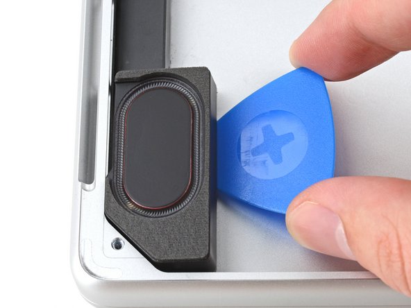

  70. MacBook Pro 16" 2021 Speaker Assembly Replacement, Separate the bottom adhesive: crwdns2935265:070crwdnd2935265:01crwdnd2935265:03crwdne2935265:0 MacBook Pro 16" 2021 Speaker Assembly Replacement, Separate the bottom adhesive: crwdns2935265:070crwdnd2935265:02crwdnd2935265:03crwdne2935265:0 MacBook Pro 16" 2021 Speaker Assembly Replacement, Separate the bottom adhesive: crwdns2935265:070crwdnd2935265:03crwdnd2935265:03crwdne2935265:0
    • Insert the tip of an opening pick between the bottom of the speaker and the frame.
  71. MacBook Pro 16" 2021 Speaker Assembly Replacement: crwdns2935265:071crwdnd2935265:01crwdnd2935265:02crwdne2935265:0 MacBook Pro 16" 2021 Speaker Assembly Replacement: crwdns2935265:071crwdnd2935265:02crwdnd2935265:02crwdne2935265:0
    • Slide the pick upwards to separate the adhesive along the bottom length of the speaker.
    • Leave the pick in to prevent the adhesive from resealing.

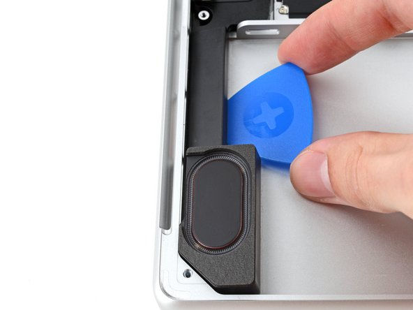

  72. MacBook Pro 16" 2021 Speaker Assembly Replacement, Separate the top adhesive: crwdns2935265:072crwdnd2935265:01crwdnd2935265:03crwdne2935265:0 MacBook Pro 16" 2021 Speaker Assembly Replacement, Separate the top adhesive: crwdns2935265:072crwdnd2935265:02crwdnd2935265:03crwdne2935265:0 MacBook Pro 16" 2021 Speaker Assembly Replacement, Separate the top adhesive: crwdns2935265:072crwdnd2935265:03crwdnd2935265:03crwdne2935265:0
    • Insert the tip of an opening pick between the top of the speaker and the frame.
  73. MacBook Pro 16" 2021 Speaker Assembly Replacement, Remove the speaker: crwdns2935265:073crwdnd2935265:01crwdnd2935265:03crwdne2935265:0 MacBook Pro 16" 2021 Speaker Assembly Replacement, Remove the speaker: crwdns2935265:073crwdnd2935265:02crwdnd2935265:03crwdne2935265:0 MacBook Pro 16" 2021 Speaker Assembly Replacement, Remove the speaker: crwdns2935265:073crwdnd2935265:03crwdnd2935265:03crwdne2935265:0
    • Pry up with the pick to completely separate the top adhesive.
    • Remove the speaker.
    • If you're still feeling resistance, slice along the perimeter of the speaker or apply a few more drops of isopropyl alcohol.
    • Repeat the loosening and separating process for the other speaker.
