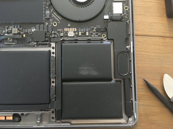

  3. MacBook Pro 16" 2019 Speaker Replacement, The part: crwdns2935265:03crwdnd2935265:01crwdnd2935265:02crwdne2935265:0 MacBook Pro 16" 2019 Speaker Replacement, The part: crwdns2935265:03crwdnd2935265:02crwdnd2935265:02crwdne2935265:0
    • I'm going to replace the left and right speaker. I bought a few on AliExpress, since they were sold out on iFixit, however they arrived damaged. Hopefully they work.

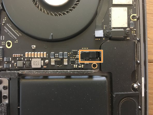

  4. MacBook Pro 16" 2019 Speaker Replacement, Disconnect the speaker: crwdns2935265:04crwdnd2935265:01crwdnd2935265:02crwdne2935265:0 MacBook Pro 16" 2019 Speaker Replacement, Disconnect the speaker: crwdns2935265:04crwdnd2935265:02crwdnd2935265:02crwdne2935265:0
    • On both sides, open up the connector and take out the cable.

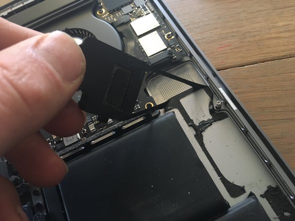

  5. MacBook Pro 16" 2019 Speaker Replacement, Remove the Speaker: crwdns2935265:05crwdnd2935265:01crwdnd2935265:02crwdne2935265:0 MacBook Pro 16" 2019 Speaker Replacement, Remove the Speaker: crwdns2935265:05crwdnd2935265:02crwdnd2935265:02crwdne2935265:0
    • Taking out the speaker is where it gets sketchy. It's hanging in there with VERY strong adhesive. Luckily, I'm going to replace the speakers and am not going to keep them so I can be rough. If you want to keep the speaker, I would advise another approach.

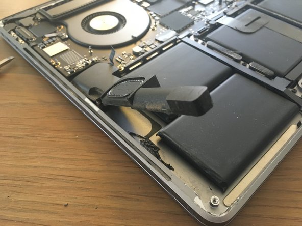

  6. MacBook Pro 16" 2019 Speaker Replacement, Take out the other side: crwdns2935265:06crwdnd2935265:01crwdnd2935265:02crwdne2935265:0 MacBook Pro 16" 2019 Speaker Replacement, Take out the other side: crwdns2935265:06crwdnd2935265:02crwdnd2935265:02crwdne2935265:0
    • Same story on the other side. Wiggle your tool underneath and force it out.

This was very helpful... I managed to successfully replace mine... but unfortunately on step 5 I made the mistake of scuffing the battery, revealing the aluminum layer inside and it gave off a sweet smell (which i now understand is dangerous)
Painfully had to have the battery replaced for about 300$ (I'm in Nairobi, Kenya)
Maybe update the steps to avoid the nearby battery which is really sensitive.
Cheers
