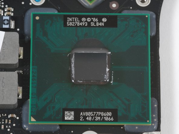

  21. MacBook Pro 15" Unibody Teardown: crwdns2935265:021crwdnd2935265:01crwdnd2935265:02crwdne2935265:0 MacBook Pro 15" Unibody Teardown: crwdns2935265:021crwdnd2935265:02crwdnd2935265:02crwdne2935265:0
    • Logic board top with heatsink removed.
    • The large chip on top is the Intel 2.4 GHz Montevina processor. It has 3M L2 cache and a 1066 MHz bus. Markings: 5827B493 SLB4N AV80577P8600
    • The other two large chips are Nvidia graphics chips.
    • We'll post part numbers as we identify them.
