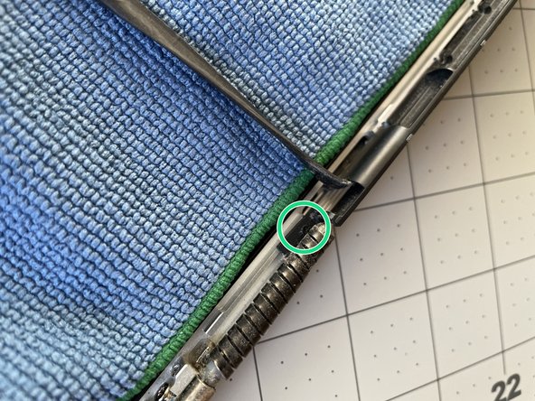

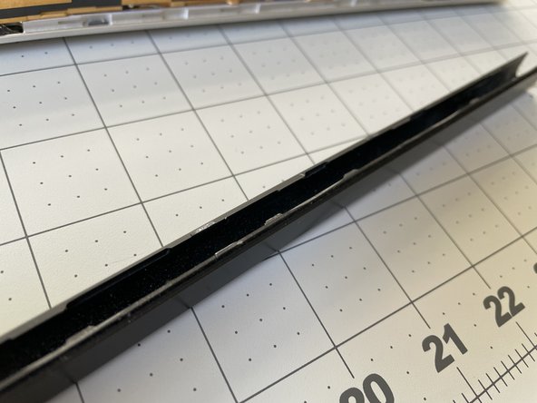

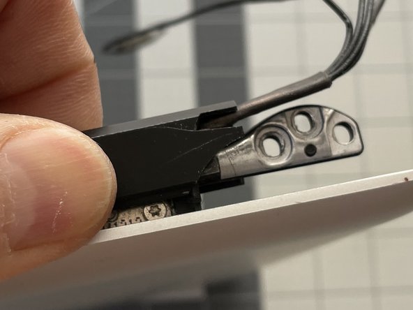

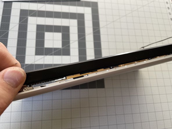

  19. MacBook Pro 15" Unibody Mid 2012 Airport and Bluetooth Antenna Replacement, Airport and Bluetooth Antenna: crwdns2935265:019crwdnd2935265:01crwdnd2935265:03crwdne2935265:0 MacBook Pro 15" Unibody Mid 2012 Airport and Bluetooth Antenna Replacement, Airport and Bluetooth Antenna: crwdns2935265:019crwdnd2935265:02crwdnd2935265:03crwdne2935265:0 MacBook Pro 15" Unibody Mid 2012 Airport and Bluetooth Antenna Replacement, Airport and Bluetooth Antenna: crwdns2935265:019crwdnd2935265:03crwdnd2935265:03crwdne2935265:0
    • The plastic cover has retaining tabs on its bottom -- see the third picture.
    • Starting on the right side of the display, slide the antenna's plastic cover approximately 1/4" to the right.
    • Then, lift up the right edge of the plastic cover just enough to separate it from the display.
    • Continue lifting the cover along its length, until the entire cover is separated.
    • Remove the plastic cover and retain for reassembly.
    • When putting back the cover, follow the instructions in reverse -- put it into its channel about 1/4" to the right of where it should normally reside, then slide it into its location.

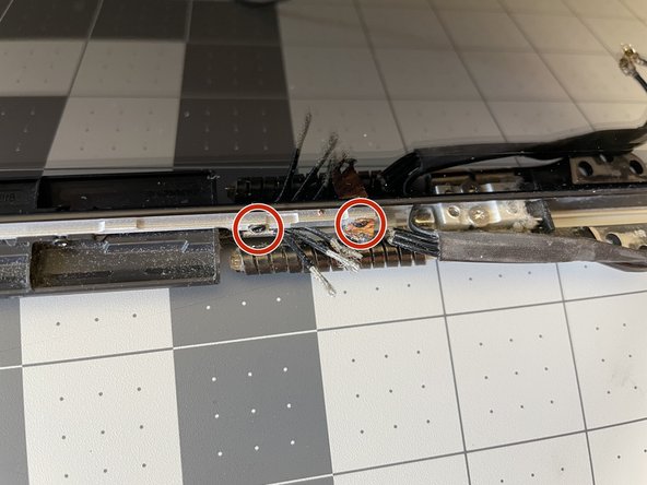

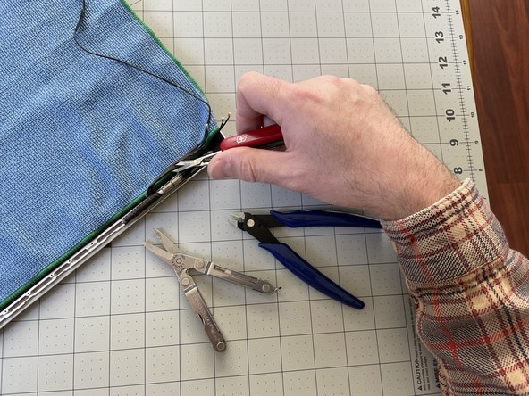

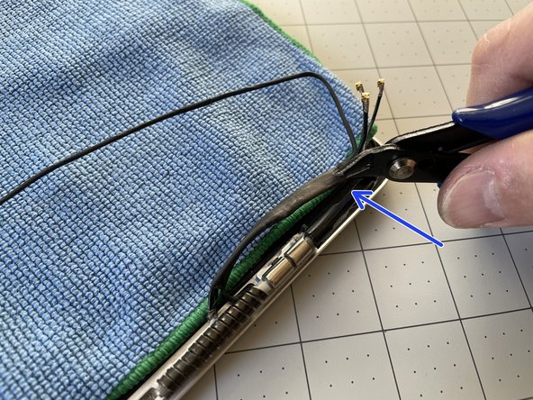

  20. MacBook Pro 15" Unibody Mid 2012 Airport and Bluetooth Antenna Replacement: crwdns2935265:020crwdnd2935265:01crwdnd2935265:03crwdne2935265:0 MacBook Pro 15" Unibody Mid 2012 Airport and Bluetooth Antenna Replacement: crwdns2935265:020crwdnd2935265:02crwdnd2935265:03crwdne2935265:0 MacBook Pro 15" Unibody Mid 2012 Airport and Bluetooth Antenna Replacement: crwdns2935265:020crwdnd2935265:03crwdnd2935265:03crwdne2935265:0
    • Unwrap the black tape to separate the iSight camera cable from the Airport/Bluetooth cables.
    • If unwrapping is not possible, carefully cut the black tape lengthwise, making sure not to accidentally cut any of the cables -- especially the iSight cable.
    • A variety of tools can be used for this cut, but the smaller the cutting instrument, the better. I found that the scissors from a mini Swiss Army pocketknife worked best, although iFixit's Flush Cutter worked fine as well.
