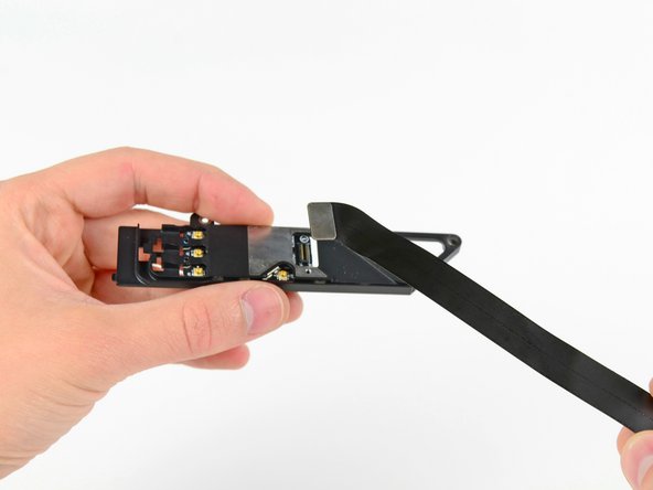

  12. MacBook Pro 15" Unibody Mid 2012 AirPort/Bluetooth Board Replacement: crwdns2935265:012crwdnd2935265:01crwdnd2935265:02crwdne2935265:0 MacBook Pro 15" Unibody Mid 2012 AirPort/Bluetooth Board Replacement: crwdns2935265:012crwdnd2935265:02crwdnd2935265:02crwdne2935265:0
    • Use the flat end of a spudger to pry the AirPort/Bluetooth cable away from its socket on the AirPort/Bluetooth board.
    • Remove the AirPort/Bluetooth cable from the AirPort/Bluetooth assembly.
