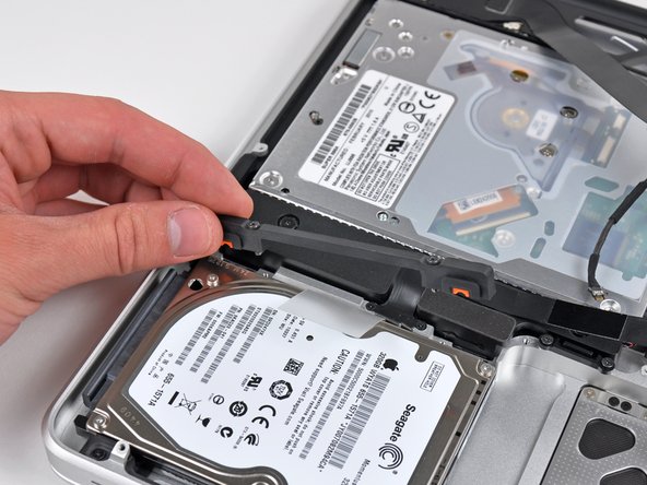

  27. MacBook Pro 15" Unibody Mid 2010 Upper Case Replacement, Upper Case: crwdns2935265:027crwdnd2935265:01crwdnd2935265:02crwdne2935265:0 MacBook Pro 15" Unibody Mid 2010 Upper Case Replacement, Upper Case: crwdns2935265:027crwdnd2935265:02crwdnd2935265:02crwdne2935265:0
    • Remove the two Phillips screws securing the hard drive bracket to the upper case.
    • These screws are captive in the hard drive bracket.
    • Remove the hard drive bracket from the upper case.

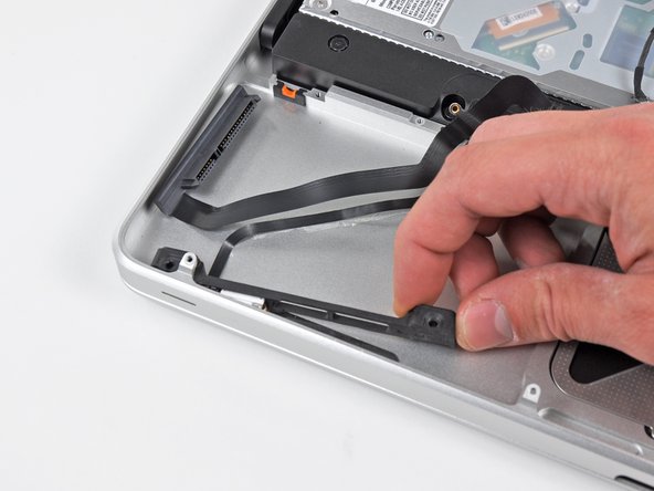

  30. MacBook Pro 15" Unibody Mid 2010 Upper Case Replacement: crwdns2935265:030crwdnd2935265:01crwdnd2935265:01crwdne2935265:0
    • Remove the following four screws securing the hard drive/IR sensor cable to the upper case:
    • Two 2.5 mm Phillips screws.
    • Two 10 mm Phillips screws.
  31. MacBook Pro 15" Unibody Mid 2010 Upper Case Replacement: crwdns2935265:031crwdnd2935265:01crwdnd2935265:02crwdne2935265:0 MacBook Pro 15" Unibody Mid 2010 Upper Case Replacement: crwdns2935265:031crwdnd2935265:02crwdnd2935265:02crwdne2935265:0
    • Carefully peel the IR sensor cable off the adhesive securing it to the upper case.
    • Pull the hard drive bracket/IR sensor housing away from the side of the upper case.
    • Remove the hard drive/IR sensor cable from the upper case.

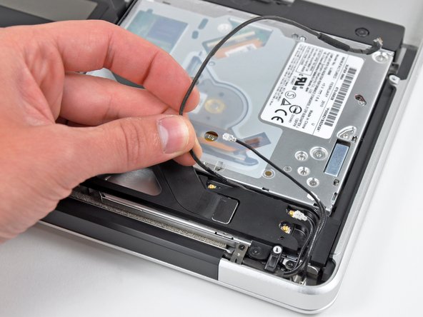

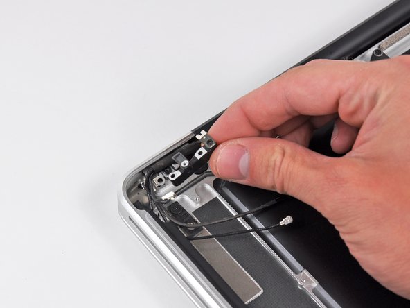

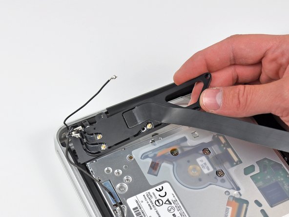

  32. MacBook Pro 15" Unibody Mid 2010 Upper Case Replacement: crwdns2935265:032crwdnd2935265:01crwdnd2935265:01crwdne2935265:0
    • Use the tip of a spudger to pry all three AirPort/Bluetooth antenna connectors up off the AirPort/Bluetooth board.
  33. MacBook Pro 15" Unibody Mid 2010 Upper Case Replacement: crwdns2935265:033crwdnd2935265:01crwdnd2935265:02crwdne2935265:0 MacBook Pro 15" Unibody Mid 2010 Upper Case Replacement: crwdns2935265:033crwdnd2935265:02crwdnd2935265:02crwdne2935265:0
    • De-route the three antenna cables from their channels in the AirPort/Bluetooth housing.
    • De-route the camera cable from its channel in the AirPort/Bluetooth housing.

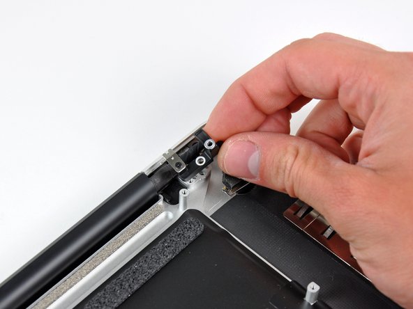

  34. MacBook Pro 15" Unibody Mid 2010 Upper Case Replacement: crwdns2935265:034crwdnd2935265:01crwdnd2935265:02crwdne2935265:0 MacBook Pro 15" Unibody Mid 2010 Upper Case Replacement: crwdns2935265:034crwdnd2935265:02crwdnd2935265:02crwdne2935265:0
    • Remove the following two screws securing the AirPort/Bluetooth housing to the upper case:
    • One 3.8 mm Phillips
    • One 8.6 mm Phillips
    • Remove the AirPort/Bluetooth assembly from the upper case, minding any cables that may get caught.

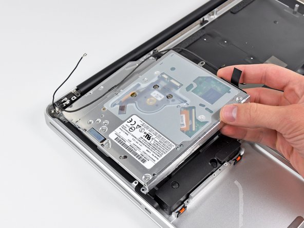

  35. MacBook Pro 15" Unibody Mid 2010 Upper Case Replacement: crwdns2935265:035crwdnd2935265:01crwdnd2935265:02crwdne2935265:0 MacBook Pro 15" Unibody Mid 2010 Upper Case Replacement: crwdns2935265:035crwdnd2935265:02crwdnd2935265:02crwdne2935265:0
    • Remove the following three Phillips screws securing the optical drive to the upper case:
    • One 4.5 mm Phillips screw securing the optical drive bracket to the upper case near the fan.
    • Two 2.5 mm Phillips screws securing the optical drive to the upper case near the optical drive opening.
    • In some cases, all three may be 2.5mm screws.
    • Remove the optical drive from the upper case.

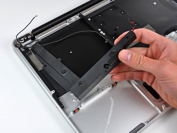

  36. MacBook Pro 15" Unibody Mid 2010 Upper Case Replacement: crwdns2935265:036crwdnd2935265:01crwdnd2935265:02crwdne2935265:0 MacBook Pro 15" Unibody Mid 2010 Upper Case Replacement: crwdns2935265:036crwdnd2935265:02crwdnd2935265:02crwdne2935265:0
    • Remove the following six screws securing the subwoofer and right speaker to the upper case:
    • Two 3.2 mm Phillips screws.
    • Two 12.3 mm Phillips screws.
    • One 2.5 mm Phillips screw.
    • One 8.3 mm Phillips screw.
    • Remove the subwoofer/right speaker from the upper case.

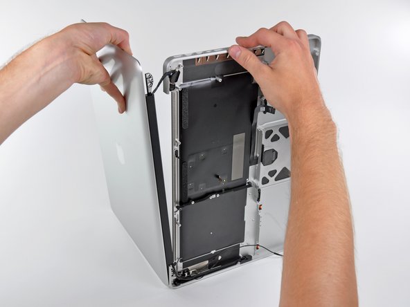

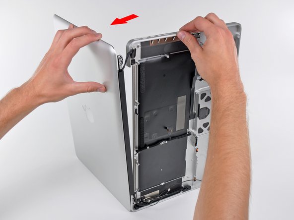

  39. MacBook Pro 15" Unibody Mid 2010 Upper Case Replacement: crwdns2935265:039crwdnd2935265:01crwdnd2935265:01crwdne2935265:0
    • Remove two of the three 6 mm T6 Torx screws securing the right side of the display to the upper case.
    • We purposely have you leave one screw attaching the display to the upper case to aid in future steps.

  41. MacBook Pro 15" Unibody Mid 2010 Upper Case Replacement: crwdns2935265:041crwdnd2935265:01crwdnd2935265:01crwdne2935265:0
    • Open your MacBook Pro so the display is perpendicular to the upper case.
    • Place your opened MacBook Pro on a table as pictured.
    • While holding the display and upper case together with your left hand, remove the remaining T6 Torx screw from the upper display bracket.
  42. MacBook Pro 15" Unibody Mid 2010 Upper Case Replacement: crwdns2935265:042crwdnd2935265:01crwdnd2935265:01crwdne2935265:0
    • Be sure to hold the display and upper case together with your left hand. Failure to do so may cause the freed display/upper case to fall, potentially damaging each component.
    • Remove the last remaining T6 Torx screw securing the display to the upper case.
  43. MacBook Pro 15" Unibody Mid 2010 Upper Case Replacement: crwdns2935265:043crwdnd2935265:01crwdnd2935265:03crwdne2935265:0 MacBook Pro 15" Unibody Mid 2010 Upper Case Replacement: crwdns2935265:043crwdnd2935265:02crwdnd2935265:03crwdne2935265:0 MacBook Pro 15" Unibody Mid 2010 Upper Case Replacement: crwdns2935265:043crwdnd2935265:03crwdnd2935265:03crwdne2935265:0
    • Grab the upper case with your right hand and rotate it slightly toward the top of the display so the upper display bracket clears the edge of the upper case.
    • Rotate the display slightly away from the upper case.
    • Lift the display up and away from the upper case, minding any brackets or cables that may get caught.
