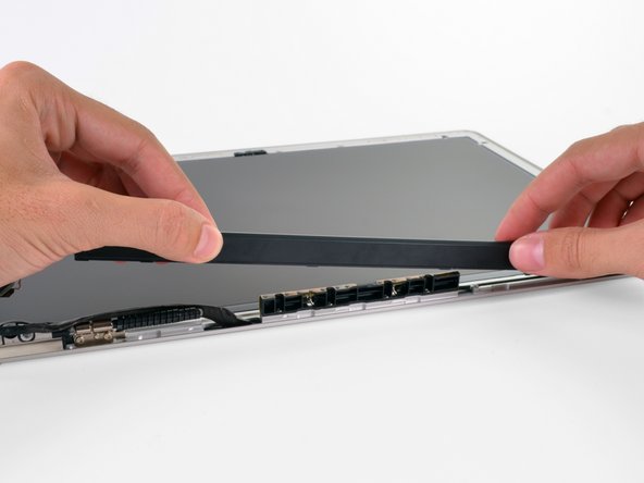

  35. MacBook Pro 15" Unibody Mid 2010 Matte LCD Replacement, Clutch Cover: crwdns2935265:035crwdnd2935265:01crwdnd2935265:02crwdne2935265:0 MacBook Pro 15" Unibody Mid 2010 Matte LCD Replacement, Clutch Cover: crwdns2935265:035crwdnd2935265:02crwdnd2935265:02crwdne2935265:0
    • Lifting the left edge of the clutch cover, gently rock it back and forth on its long axis while pulling it away from the display.
    • Remove the clutch cover from the display, minding any cables that may get caught.
    • When reinstalling the clutch cover, be sure to widen the opening when slipping it over the small black plastic cosmetic cover that fills the open end of the clutch cover when it is in place. The cosmetic cover has very thin and delicate plastic arms that hold it to the right clutch hinge.

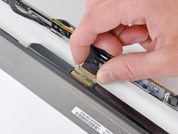

  38. MacBook Pro 15" Unibody Mid 2010 Matte LCD Replacement: crwdns2935265:038crwdnd2935265:01crwdnd2935265:01crwdne2935265:0
    • Peel the piece of tape covering the display data cable connector away from the edge closest to the LCD.
  39. MacBook Pro 15" Unibody Mid 2010 Matte LCD Replacement: crwdns2935265:039crwdnd2935265:01crwdnd2935265:02crwdne2935265:0 MacBook Pro 15" Unibody Mid 2010 Matte LCD Replacement: crwdns2935265:039crwdnd2935265:02crwdnd2935265:02crwdne2935265:0
    • Use the tip of a spudger to flip up the thin steel retaining clip securing the display data cable to its socket on the LCD.
    • Pull the display data cable straight away from its socket on the LCD.
    • Lift the LCD out of the display assembly and set it aside.
    • If you are replacing the LVDS/display data cable, simply de-route it from its slot cut into the display casing.

Does the gasket reapply easily? It seems like once you get it off it wouldn’t like to go back on.
[deleted] - crwdns2934203:0crwdne2934203:0
I had no problem with reapplying the gasket as it fits nicely into the notch.
A big THANKS to Walter! It is in deed not easy but thanks to this detailed instructions I got it working!! :)
