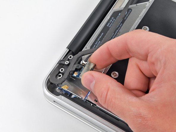

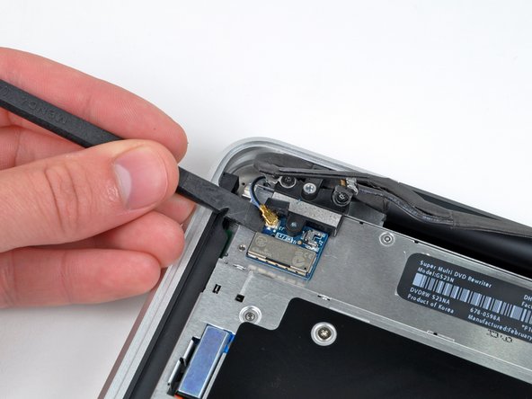

    • This step is for anti-glare display machines only. Skip this step if you have a glossy display.
    • Disconnect the Bluetooth cable by pulling the male end straight away from its socket.
    • Use the flat end of a spudger to carefully pry the AirPort antenna off its socket on the AirPort card.
    • Pull the connector parallel to the face of the logic board, not straight up.
  37. MacBook Pro 15" Unibody Mid 2009 Upper Case Replacement: crwdns2935265:037crwdnd2935265:01crwdnd2935265:02crwdne2935265:0 MacBook Pro 15" Unibody Mid 2009 Upper Case Replacement: crwdns2935265:037crwdnd2935265:02crwdnd2935265:02crwdne2935265:0
    • Remove the two 8 mm Phillips screws securing the Bluetooth/camera cable retainer to the upper case.
    • One of the screws may remain captive in the Bluetooth/camera cable ground loop. If replacing the display, be sure to transfer this screw to the new unit.
    • Lift the AirPort board/cable retainer assembly out of the upper case.

    • This step is for glossy display machines only. If you have an anti-glare display, skip this step.
    • Remove the two 8 mm Phillips screws securing the camera cable retainer to the upper case.
    • One of the screws may remain captive in the camera cable ground loop. If replacing the display, be sure to transfer this screw to the new unit.
    • Lift the camera cable retainer out of the upper case.

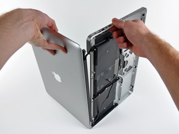

    • Open your MacBook Pro so the display is perpendicular to the upper case.
    • Place your opened MacBook Pro on a table as pictured.
    • While holding the display and upper case together with your left hand, remove the remaining T6 Torx screw from the lower display bracket.
  46. MacBook Pro 15" Unibody Mid 2009 Upper Case Replacement: crwdns2935265:046crwdnd2935265:01crwdnd2935265:01crwdne2935265:0
    • Be sure to hold the display and upper case together with your other hand. Failure to do so may cause the freed display/upper case to fall, potentially damaging each component.
    • Remove the last remaining 6 mm Torx screw securing the display to the upper case.
  47. MacBook Pro 15" Unibody Mid 2009 Upper Case Replacement: crwdns2935265:047crwdnd2935265:01crwdnd2935265:03crwdne2935265:0 MacBook Pro 15" Unibody Mid 2009 Upper Case Replacement: crwdns2935265:047crwdnd2935265:02crwdnd2935265:03crwdne2935265:0 MacBook Pro 15" Unibody Mid 2009 Upper Case Replacement: crwdns2935265:047crwdnd2935265:03crwdnd2935265:03crwdne2935265:0
    • Grab the upper case with your right hand and rotate it slightly toward the top of the display so the upper display bracket clears the edge of the upper case.
    • Rotate the display slightly away from the upper case.
    • Lift the display away from the upper case, minding any brackets or cables that may get caught.
