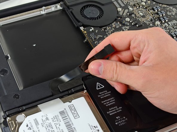

  11. MacBook Pro 15" Unibody Late 2011 Subwoofer & Right Speaker Replacement, Subwoofer & Right Speaker: crwdns2935265:011crwdnd2935265:01crwdnd2935265:02crwdne2935265:0 MacBook Pro 15" Unibody Late 2011 Subwoofer & Right Speaker Replacement, Subwoofer & Right Speaker: crwdns2935265:011crwdnd2935265:02crwdnd2935265:02crwdne2935265:0
    • Use the flat end of a spudger to pry the hard drive/IR sensor cable connector up off the logic board.
    • Peel the hard drive cable up from the channel within the subwoofer and right speaker.
