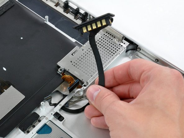

  28. MacBook Pro 15" Unibody Late 2008 and Early 2009 Upper Case Replacement, Battery Connector: crwdns2935265:028crwdnd2935265:01crwdnd2935265:01crwdne2935265:0
    • Remove three 2 mm Phillips screws securing the battery connector cover to the upper case.
  29. MacBook Pro 15" Unibody Late 2008 and Early 2009 Upper Case Replacement: crwdns2935265:029crwdnd2935265:01crwdnd2935265:02crwdne2935265:0 MacBook Pro 15" Unibody Late 2008 and Early 2009 Upper Case Replacement: crwdns2935265:029crwdnd2935265:02crwdnd2935265:02crwdne2935265:0
    • The battery connector cover is held onto the upper case by a strong adhesive. Use a spudger to loosen the adhesive around the edges of the battery connector.
    • Lift the battery connector cover out of the upper case.
  30. MacBook Pro 15" Unibody Late 2008 and Early 2009 Upper Case Replacement: crwdns2935265:030crwdnd2935265:01crwdnd2935265:02crwdne2935265:0 MacBook Pro 15" Unibody Late 2008 and Early 2009 Upper Case Replacement: crwdns2935265:030crwdnd2935265:02crwdnd2935265:02crwdne2935265:0
    • Peel the battery connector cable off the adhesive securing it to the upper case.
    • De-route the battery connector cable through the gap in the upper case and remove it from the computer.

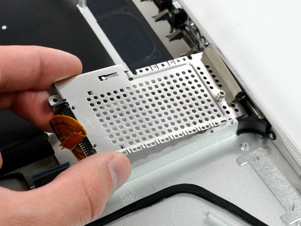

  31. MacBook Pro 15" Unibody Late 2008 and Early 2009 Upper Case Replacement, Upper Case: crwdns2935265:031crwdnd2935265:01crwdnd2935265:02crwdne2935265:0 MacBook Pro 15" Unibody Late 2008 and Early 2009 Upper Case Replacement, Upper Case: crwdns2935265:031crwdnd2935265:02crwdnd2935265:02crwdne2935265:0
    • Remove the following screws securing the ExpressCard Cage to the upper case:
    • Two 4 mm Phillips screws.
    • Two 1.9 mm Phillips screws.
    • Lift the the ExpressCard Cage out of the upper case.

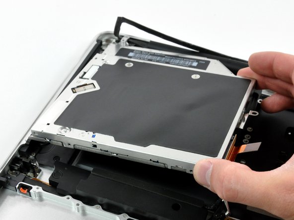

  35. MacBook Pro 15" Unibody Late 2008 and Early 2009 Upper Case Replacement: crwdns2935265:035crwdnd2935265:01crwdnd2935265:02crwdne2935265:0 MacBook Pro 15" Unibody Late 2008 and Early 2009 Upper Case Replacement: crwdns2935265:035crwdnd2935265:02crwdnd2935265:02crwdne2935265:0
    • Remove the following three Phillips screws securing the optical drive to the upper case:
    • One 3.5 mm Phillips screw.
    • Two 2.5 mm Phillips screws.
    • Lift the optical drive from its right edge and pull it out of the computer.

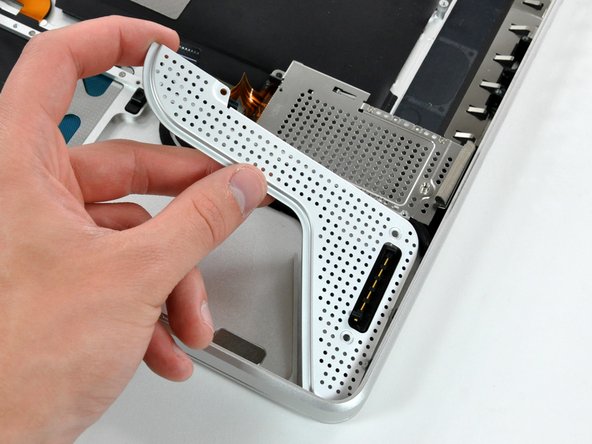

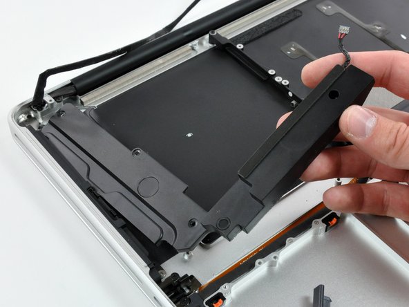

  36. MacBook Pro 15" Unibody Late 2008 and Early 2009 Upper Case Replacement: crwdns2935265:036crwdnd2935265:01crwdnd2935265:02crwdne2935265:0 MacBook Pro 15" Unibody Late 2008 and Early 2009 Upper Case Replacement: crwdns2935265:036crwdnd2935265:02crwdnd2935265:02crwdne2935265:0
    • Remove the following four screws securing the subwoofer and right speaker to the upper case:
    • Two 3.2 mm Phillips screws.
    • One 2.6 mm Phillips screw.
    • One 5.0 mm Phillips screw.
    • Lift the subwoofer and right speaker assembly out of the upper case.

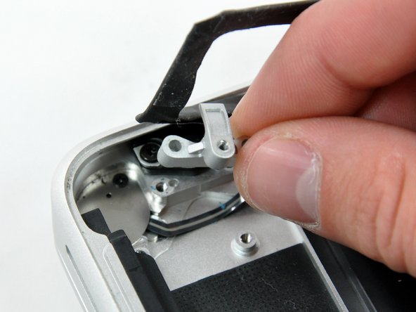

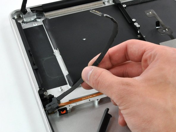

  38. MacBook Pro 15" Unibody Late 2008 and Early 2009 Upper Case Replacement: crwdns2935265:038crwdnd2935265:01crwdnd2935265:02crwdne2935265:0 MacBook Pro 15" Unibody Late 2008 and Early 2009 Upper Case Replacement: crwdns2935265:038crwdnd2935265:02crwdnd2935265:02crwdne2935265:0
    • Remove two 8 mm Phillips screws securing the camera cable bracket to the upper case.
    • The rightmost screw may remain captive in the camera cable.
    • Seperate the camera cable bracket from the camera cable and remove it from the computer.

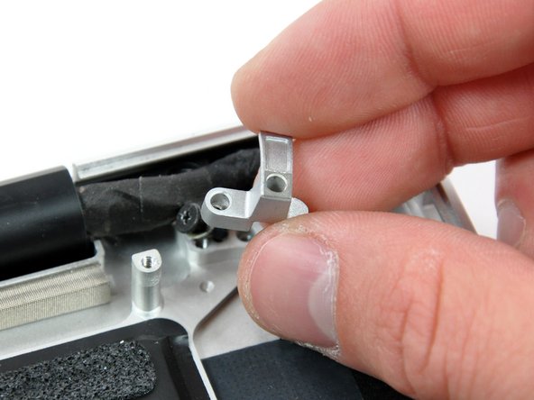

  39. MacBook Pro 15" Unibody Late 2008 and Early 2009 Upper Case Replacement: crwdns2935265:039crwdnd2935265:01crwdnd2935265:02crwdne2935265:0 MacBook Pro 15" Unibody Late 2008 and Early 2009 Upper Case Replacement: crwdns2935265:039crwdnd2935265:02crwdnd2935265:02crwdne2935265:0
    • Remove the 7 mm Phillips screw from the LVDS cable bracket.
    • This screw may remain captive in the LVDS cable.
    • Lift the LVDS cable bracket out of the upper case.

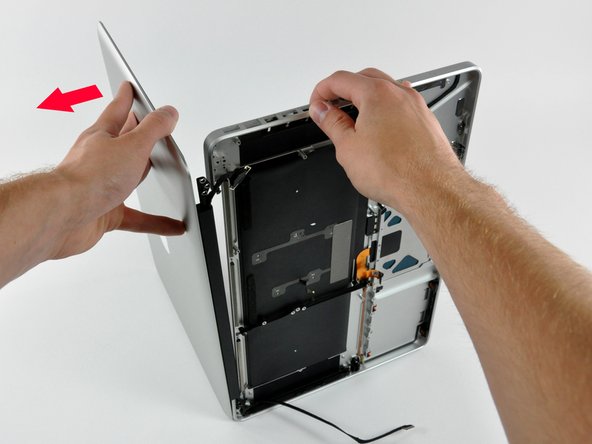

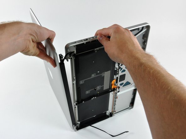

  40. MacBook Pro 15" Unibody Late 2008 and Early 2009 Upper Case Replacement: crwdns2935265:040crwdnd2935265:01crwdnd2935265:01crwdne2935265:0
    • Remove two outer 6 mm T6 Torx screws securing each side of the display to the upper case (4 screws total).

  41. MacBook Pro 15" Unibody Late 2008 and Early 2009 Upper Case Replacement: crwdns2935265:041crwdnd2935265:01crwdnd2935265:01crwdne2935265:0
    • Open your MacBook Pro so the display is perpendicular to the upper case.
    • Place your opened MacBook Pro on a table as pictured.
    • While holding the display and upper case together with your other hand, remove the 6 mm Torx screw from the lower display bracket.
  42. MacBook Pro 15" Unibody Late 2008 and Early 2009 Upper Case Replacement: crwdns2935265:042crwdnd2935265:01crwdnd2935265:01crwdne2935265:0
    • Be sure to hold the display and upper case together with your other hand. Failure to do so may cause the freed display/upper case to fall, potentially damaging each component.
    • Remove the last remaining 6 mm Torx screw securing the display to the upper case.
  43. MacBook Pro 15" Unibody Late 2008 and Early 2009 Upper Case Replacement: crwdns2935265:043crwdnd2935265:01crwdnd2935265:03crwdne2935265:0 MacBook Pro 15" Unibody Late 2008 and Early 2009 Upper Case Replacement: crwdns2935265:043crwdnd2935265:02crwdnd2935265:03crwdne2935265:0 MacBook Pro 15" Unibody Late 2008 and Early 2009 Upper Case Replacement: crwdns2935265:043crwdnd2935265:03crwdnd2935265:03crwdne2935265:0
    • Grab the upper case with your right hand and rotate it slightly toward the top of the display so the upper display bracket clears the edge of the upper case.
    • Rotate the display slightly away from the upper case.
    • Lift the display away from the upper case, minding any brackets or cables that may get caught.
