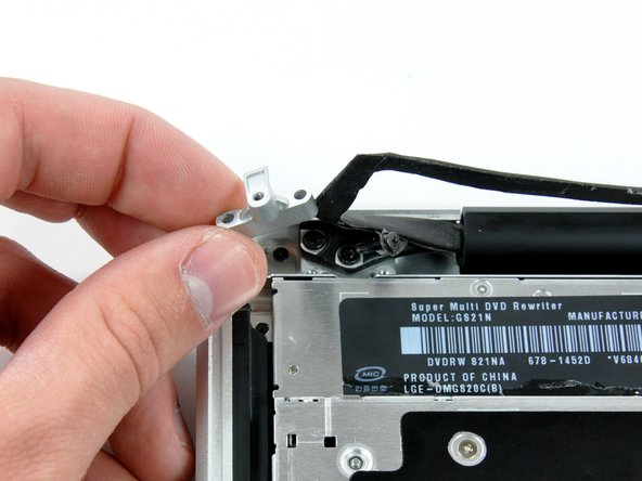

    • Remove two 8 mm Phillips screws securing the camera cable bracket to the upper case.
    • The rightmost screw may remain captive in the camera cable.
    • Lift the camera cable bracket out from the upper case.

Be extremely careful removing the drive retainer bracket screws. Stop immediately if they resist. These were extremely tight in my case, and I (carelessly) ended up stripping two, even using the correct screwdriver. Keep your extractor handy. (Apple technicians suggest the Alden Grabit-Micro.)
