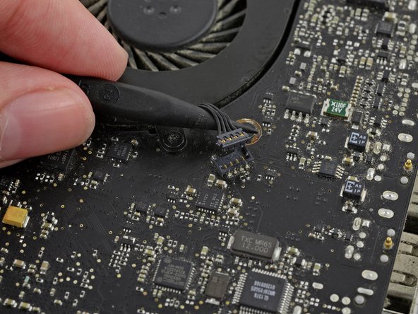

    • Use the tip of a spudger to lift the right fan connector straight up from its socket on the logic board.
    • Be sure to only pry up on the connector itself not on the socket or you may damage the machine.
    • It is useful to twist the spudger axially from beneath the fan cable wires to release the connector.
    • Remove the right fan from the case.

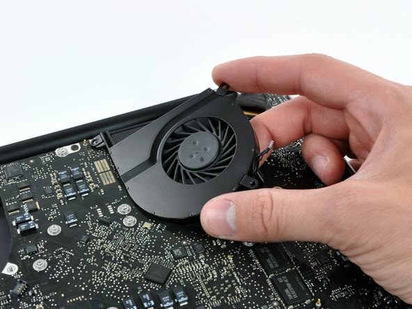

    • Use the tip of a spudger to lift the left fan connector straight up from its socket on the logic board.
    • Remove the left fan from the case.

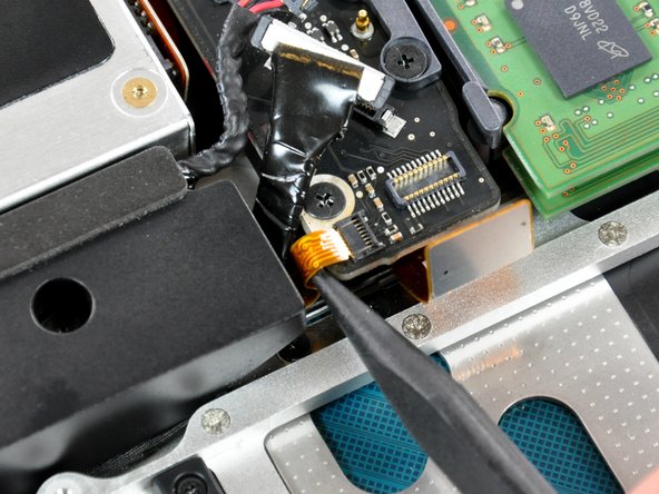

    • Use a spudger to pry the trackpad connector straight up out of its socket on the logic board.
