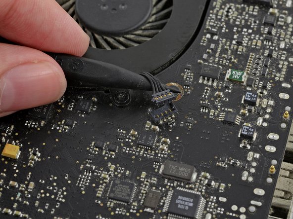

  6. MacBook Pro 15" Unibody Late 2008 and Early 2009 Left Fan Replacement, Left Fan: crwdns2935265:06crwdnd2935265:01crwdnd2935265:02crwdne2935265:0 MacBook Pro 15" Unibody Late 2008 and Early 2009 Left Fan Replacement, Left Fan: crwdns2935265:06crwdnd2935265:02crwdnd2935265:02crwdne2935265:0
    • Use a spudger to pry the fan connector straight up off the logic board.
    • Be sure to only pry up on the connector itself not on the socket or you may damage the machine.
    • It is useful to twist the spudger axially from beneath the fan cable wires to release the connector.
