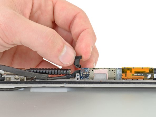

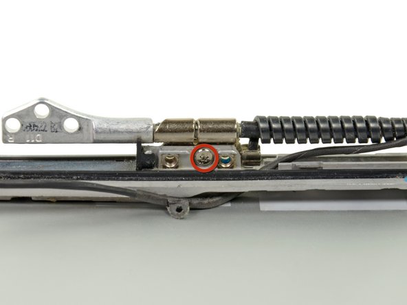

  30. MacBook Pro 15" Unibody Late 2008 and Early 2009 AirPort/iSight Cable Replacement, AirPort/iSight Cable: crwdns2935265:030crwdnd2935265:01crwdnd2935265:01crwdne2935265:0
    • Remove the 2.2 mm Phillips screw located near the bottom right corner securing the AirPort/iSight cable to the display assembly

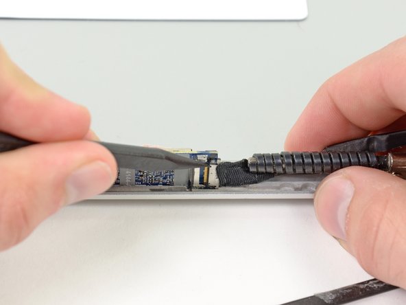

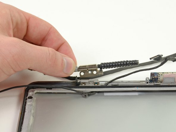

  32. MacBook Pro 15" Unibody Late 2008 and Early 2009 AirPort/iSight Cable Replacement: crwdns2935265:032crwdnd2935265:01crwdnd2935265:02crwdne2935265:0 MacBook Pro 15" Unibody Late 2008 and Early 2009 AirPort/iSight Cable Replacement: crwdns2935265:032crwdnd2935265:02crwdnd2935265:02crwdne2935265:0
    • Use the tip of a spudger to flip up the retaining flap on the iSight ribbon cable ZIF socket on the iSight board.
    • Use the tip of a spudger to pull the iSight ribbon cable out of its socket.

    • Use the tip of a spudger to push the AirPort cable retaining lock away from its socket on the AirPort board.
    • Pull the AirPort cable straight out of its socket on the AirPort board.
    • Do not lift up on the AirPort cable, as its socket is very fragile. Pull the cable parallel to the face of the AirPort board.

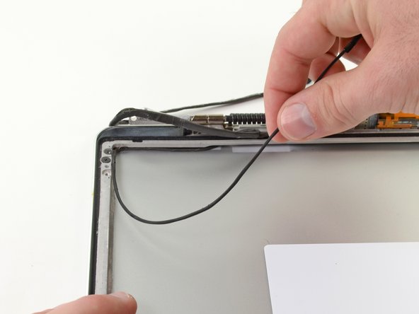

    • De-route the iSight ribbon cable from its channel near the top right corner of the display assembly.
    • Continue de-routing the AirPort/iSight cable from the right side of the display assembly.

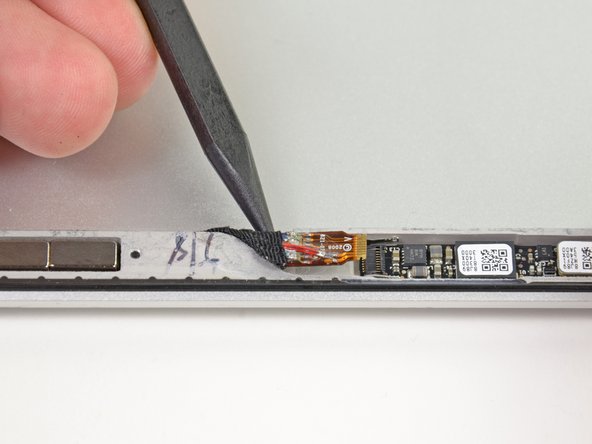

  35. MacBook Pro 15" Unibody Late 2008 and Early 2009 AirPort/iSight Cable Replacement: crwdns2935265:035crwdnd2935265:01crwdnd2935265:01crwdne2935265:0
    • Carefully pull half of the AirPort/iSight cable through the opening located underneath the right hinge.
    • Do not pull the AirPort/iSight cable completely through the opening. The right hinge prevents the cable from complete removal. Forcing the cable through the opening may cause severe damage to your AirPort/iSight cable.

    • Remove three 2.5 mm T6 Torx screws securing the right hinge to the display assembly.
    • Remove the right hinge up off the display assembly.
  37. MacBook Pro 15" Unibody Late 2008 and Early 2009 AirPort/iSight Cable Replacement: crwdns2935265:037crwdnd2935265:01crwdnd2935265:01crwdne2935265:0
    • Pull the AirPort/iSight cable through the opening located near the bottom right corner of the display assembly.
    • Remove the AirPort/iSight cable from the display assembly.
