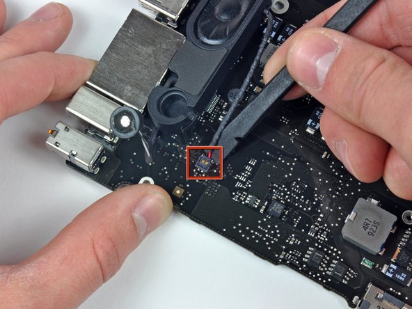

    • Use a spudger to pry the microphone cable connector up off the logic board.

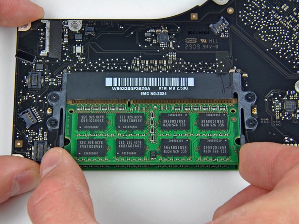

  33. MacBook Pro 15" Unibody 2.53 GHz Mid 2009 Logic Board Replacement: crwdns2935265:033crwdnd2935265:01crwdnd2935265:02crwdne2935265:0 MacBook Pro 15" Unibody 2.53 GHz Mid 2009 Logic Board Replacement: crwdns2935265:033crwdnd2935265:02crwdnd2935265:02crwdne2935265:0
    • Release the tabs on each side of the RAM chip by simultaneously pushing each tab away from the chip.
    • These tabs lock the chip in place and releasing them will cause the chip to "pop" up.
    • After the RAM chip has popped up, pull it straight out of its socket.
    • Repeat this process if a second RAM chip is installed.
    • When reinstalling your logic board, don't forget to apply a new layer of thermal paste.

Hello,
Do you know the purpose of the component that is not welded in the lower right corner of the red square on the picture of step 12: http://d3nevzfk7ii3be.cloudfront.net/igi...
Someone tells me I can not have my backlight re-working without this component, but I think it simply does not work because of a liquid.
Any ideas ?
Thanks in advance
