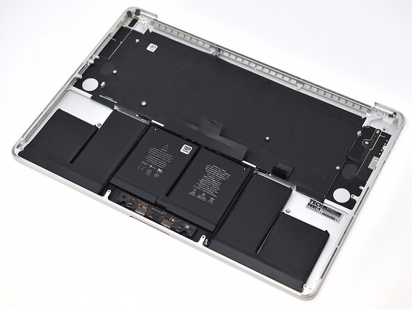

    • Before we begin it is advised to carefully read through the whole guide to get the full idea on the processes involved.
    • We begin at the stage where the top case with all its components have already been removed, except for the battery, microphone, backlight and keyboard. We can now begin the process to remove them, install a new keyboard & if necessary a new backlight.

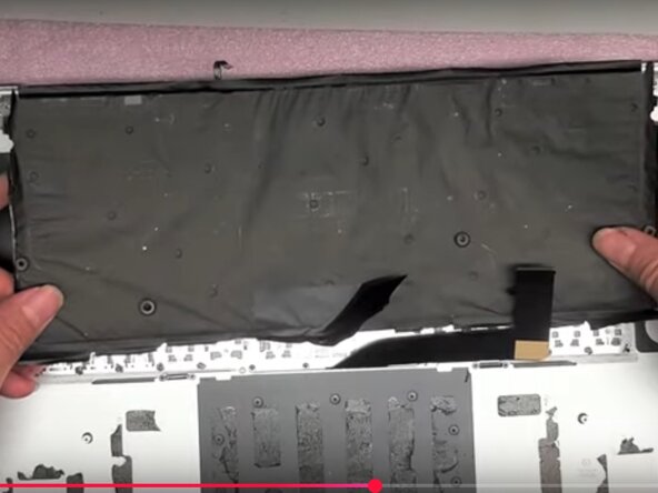

  2. MacBook Pro 15" Retina Display Mid 2015 keyboard Replacement, Removing the backlight: crwdns2935265:02crwdnd2935265:01crwdnd2935265:01crwdne2935265:0
    • We have to remove the backlight carefully as not to damage it, if you are replacing this component then you can simply pull it off.
    • The backlight consists of 3 layers, the very fragile backlight covering, a clear plastic layer and a very fragile keyboard layout template. We DO NOT want to damage these in any way if we are to use them again, so ultimate care is needed. They are stuck together but with plenty of care they can be separated.
    • Using a sharp small craft knife or similar, very carefully lift up the surrounding edge of the backlight by running the blade underneath where the adhesive is located, as we do not want to tear this extremely fragile component.
    • Some may suggest to use a heat gun but this will more than likely deform the backlight from the heat, rendering it useless.
    • Once we have a fair sized area lifted we can very gently pull away the backlight using extra care not to tear it. We can use the strength of the middle plastic sheet to assist in lifting it away. Once removed put it to the side as it will be used again in a later stage.
    • We can gently brush or wipe off any stains or debris that may have built up over time using a soft brush or cloth with some alcohol making the part nice and clean ready for re-installation.

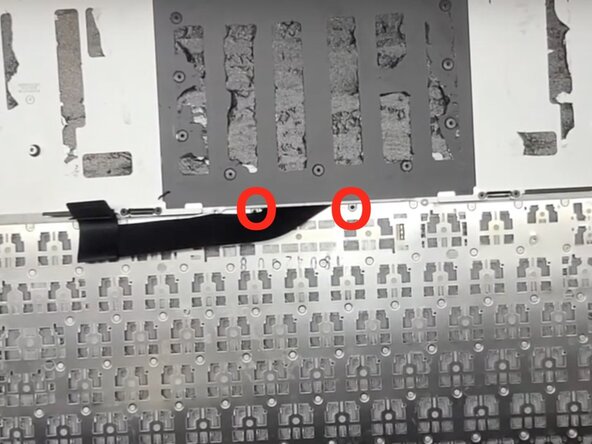

  3. MacBook Pro 15" Retina Display Mid 2015 keyboard Replacement, Remove the 2 screws: crwdns2935265:03crwdnd2935265:01crwdnd2935265:02crwdne2935265:0 MacBook Pro 15" Retina Display Mid 2015 keyboard Replacement, Remove the 2 screws: crwdns2935265:03crwdnd2935265:02crwdnd2935265:02crwdne2935265:0
    • There should be 2 small Phillips 00 screws located behind the battery connector, these need to be removed.

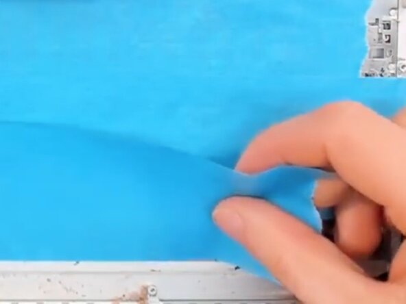

  4. MacBook Pro 15" Retina Display Mid 2015 keyboard Replacement, Covering the keyboard: crwdns2935265:04crwdnd2935265:01crwdnd2935265:02crwdne2935265:0 MacBook Pro 15" Retina Display Mid 2015 keyboard Replacement, Covering the keyboard: crwdns2935265:04crwdnd2935265:02crwdnd2935265:02crwdne2935265:0
    • Once the backlight has been removed from the case we can now proceed to cover the back of the keyboard with some masking tape, this will help to catch all the rivets that will fly off when tearing out the keyboard.

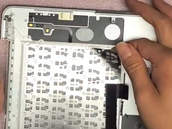

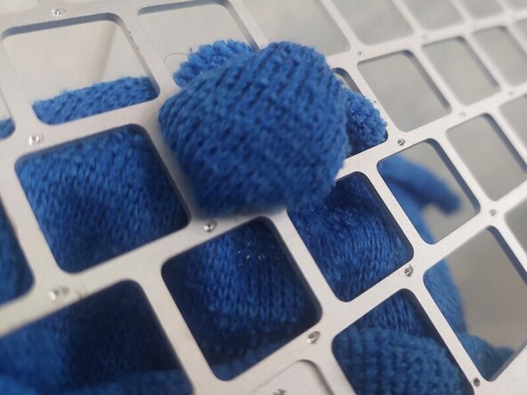

  5. MacBook Pro 15" Retina Display Mid 2015 keyboard Replacement, Removing the keyboard: crwdns2935265:05crwdnd2935265:01crwdnd2935265:02crwdne2935265:0 MacBook Pro 15" Retina Display Mid 2015 keyboard Replacement, Removing the keyboard: crwdns2935265:05crwdnd2935265:02crwdnd2935265:02crwdne2935265:0
    • Once the 2 screws have been removed and we have covered the backside of the keyboard we are ready to pull or rip it out. We DO NOT want to bend the top case in any way shape or form, so extra care has the be taken here.
    • We can either slowly tear the keyboard away from the case or we can literally but carefully stand on the edges to prevent the case from getting deformed or bent in the process when we tear or rip it out.
    • It is STRONGLY advised to to put on a good pair of strong thick gloves so we can first lift up the edge of the keyboard and gently bend it back enough to get a good strong grip on it. The edges of the Keyboard are VERY SHARP and will easily slice through weak materials or skin, so EXTRA CAUTION is required.
    • ''You can alternatively just use an old rag or a thick strong cloth to protect yourself against what can be potentially severe cuts to your fingers and knuckles when removing the keyboard'.'
    • * It is a good idea also to remove as many key caps as possible including their fixtures beforehand as it is always good to have some spares of these, especially if you are into repairing apple laptops or just in case your new keyboard suffers a damaged key in the future, as they will fly off everywhere when removing the keyboard.
    • * You can also put a sheet of paper or plastic under the laptop to help prevent any scratches that may occur if the case moves during the big pull, a cloth or rag will allow some flex during the violent pulling away of the keyboard which can potentially disfigure the case, something we definitely need to avoid from happening.
    • Once you are set, get a TIGHT FIRM GRIP and just count to three.... 1-2-3 & RIP IT OUT in one go as fast as you can. Keys and rivets will fly everywhere so be prepared! The slower you do it the more chance there is of bending the casing or injury. Again, the edge of the keyboard is VERY SHARP and shows no mercy to hands & fingers.
    • Try not to pull upwards to much, instead pull at a level to the keyboard, as this will reduce upward stress on the case.
