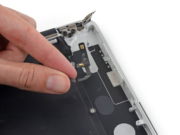

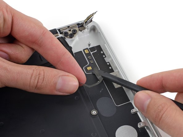

    1. MacBook Pro 15" Retina Display Mid 2015 Upper Case Assembly Replacement, Left Speaker: crwdns2935265:041crwdnd2935265:01crwdnd2935265:01crwdne2935265:0
      • Remove the following screws securing the left speaker to the upper case:
      • 2.7 mm T5 Torx screw
      • 6.9 mm T5 Torx screw (with 4.5 mm shoulder)
      • 5.6 mm T5 Torx screw
    2. MacBook Pro 15" Retina Display Mid 2015 Upper Case Assembly Replacement: crwdns2935265:042crwdnd2935265:01crwdnd2935265:02crwdne2935265:0 MacBook Pro 15" Retina Display Mid 2015 Upper Case Assembly Replacement: crwdns2935265:042crwdnd2935265:02crwdnd2935265:02crwdne2935265:0

    1. MacBook Pro 15" Retina Display Mid 2015 Upper Case Assembly Replacement, Microphones: crwdns2935265:046crwdnd2935265:01crwdnd2935265:03crwdne2935265:0 MacBook Pro 15" Retina Display Mid 2015 Upper Case Assembly Replacement, Microphones: crwdns2935265:046crwdnd2935265:02crwdnd2935265:03crwdne2935265:0 MacBook Pro 15" Retina Display Mid 2015 Upper Case Assembly Replacement, Microphones: crwdns2935265:046crwdnd2935265:03crwdnd2935265:03crwdne2935265:0
      • While gently pulling up on the microphone cable, push the flat end of a spudger underneath the cable, to cut the adhesive securing it to the upper case.
      • Remove the microphone cable.
