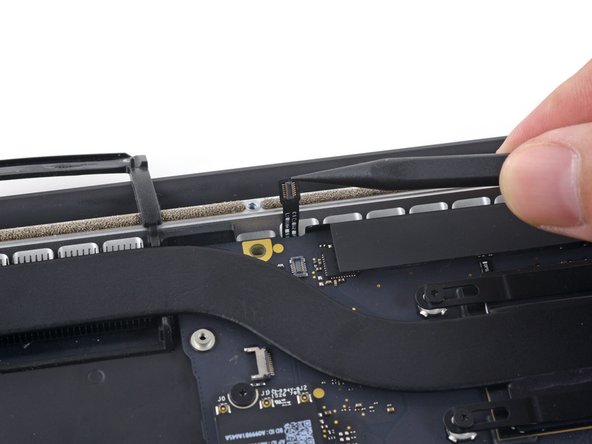

  4. MacBook Pro 15" Retina Display Mid 2015 Left Speaker Replacement, Battery Connector: crwdns2935265:04crwdnd2935265:01crwdnd2935265:01crwdne2935265:0
    • Peel back the sticker covering the battery connector.
    You only need to remove the tape to the edge of the flap. This is enough to be able to pry the battery connector up.
    Aaron Freidus - crwdns2934203:0crwdne2934203:0
    Note that the photo is taken from the hinge side - the other way to the photo in step 3
    Toby Thurston - crwdns2934203:0crwdne2934203:0
    I chanced it, didnt disconnect the battery and all is well even after giving the insides a good vacuuming before changing the SSD.
    Dermot O Logical - crwdns2934203:0crwdne2934203:0
    It is just the top layer of tape that you want to lift, you need to seperate it from the bottom layer.
    Kelv - crwdns2934203:0crwdne2934203:0
    You don’t actually need to remove the tape or even peel it off at all. Just pull up the battery connector up with the tape still attached.
    AJ Lorenzo - crwdns2934203:0crwdne2934203:0
    pay attention that the macbook in this picture is presented the “wrong side”: if you accidentally remove the tape covering the trackpad cable and thereby also take the trackpad cable out of the zif-socket, your keyboard and trackpad won’t work anymore. putting the trackpad cable back into the (tiny) socket will fix the issue though.

  8. MacBook Pro 15" Retina Display Mid 2015 Left Speaker Replacement: crwdns2935265:08crwdnd2935265:01crwdnd2935265:02crwdne2935265:0 MacBook Pro 15" Retina Display Mid 2015 Left Speaker Replacement: crwdns2935265:08crwdnd2935265:02crwdnd2935265:02crwdne2935265:0
    • Use the tip of a spudger to push the camera cable connector out of its socket on the logic board.
    • Be sure to push parallel to the board, pushing first on one side, then the other to "walk" the connector out of its socket.
    This connector is very fragile, the left edge of mine cracked off and ended up in the socket. And during figuring that out the cable or the socket appears to have got damaged because “no camera detected”.
    malhal - crwdns2934203:0crwdne2934203:0
    Yeah, same here.. Not sure what to do now
    Roman Kroupoderov -
    Have you found a solution to this problem ? I have the same issue
    Tim Rault -
    All connectors are incredibly fragile. I damaged the fan connector locking latch just by trying to lock it back in place. Fortunately the cable, by the way it inserts, it’s being pushed in rather than pulled on, however, I do have concerns with it not making a proper connection. Malcolm, I am wondering how you fixed your damaged connector?
    Robert Habib - crwdns2934203:0crwdne2934203:0
    The connector slides into the socket so using the flat end of the Splunger under the cable and gently lifting draws the connector apart.
    Dennis Newton - crwdns2934203:0crwdne2934203:0
    Don’t use the flat edge of the spudger. Instead, use the pointed end to gently slide off by the dog ears of the plug. If you look closely you’ll see a notch on each side.
    John Xeno -
    supplied tool does not have a fine enough point here - won’t move at all
    Paul Forgey - crwdns2934203:0crwdne2934203:0
    I used the fine point and also used the tweezers under the plug to relieve some pressure. I was very, very careful and made small moves. I seemed to get it out with no damage.
    Al Moulder - crwdns2934203:0crwdne2934203:0
    I personally used my tweezers and this came out with ease and without issue.
    Metz Jnr - crwdns2934203:0crwdne2934203:0
    Thanks for your comments guys! The ones about the twiners were a BINGO! :-)
    Einstein (not Albert) - crwdns2934203:0crwdne2934203:0
    The placement of the tool should be to the side of the connector where is has a notch. There is nothing to push against on top. Alternate from side to side using ver light pressure. The connector will want to push back in to slot so tweezers were handy to gently hold until connector was fully released.
    The “Skynet76” - crwdns2934203:0crwdne2934203:0

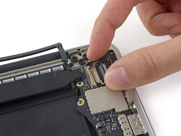

  15. MacBook Pro 15" Retina Display Mid 2015 Left Speaker Replacement: crwdns2935265:015crwdnd2935265:01crwdnd2935265:03crwdne2935265:0 MacBook Pro 15" Retina Display Mid 2015 Left Speaker Replacement: crwdns2935265:015crwdnd2935265:02crwdnd2935265:03crwdne2935265:0 MacBook Pro 15" Retina Display Mid 2015 Left Speaker Replacement: crwdns2935265:015crwdnd2935265:03crwdnd2935265:03crwdne2935265:0
    • Use the tip of a spudger to flip up the retaining flap on the right fan ribbon cable ZIF socket.
    A note about these ZIF sockets - the retaining flap is just held in place by the small amount of friction, and on reassembly they can separate. I learned to push them down with my finger when possible, or else with a flat end, carefully walking them down side by side to keep it as even as possible. If the flap separates all is not lost ! It’s quite difficult (I did almost everything in this guide with tweezers under magnifiers) but if you remove the cable first, you can get the plastic “comb” back under the pins and up into it’s original position, then replace the cable and try again.
    Matt Fisher - crwdns2934203:0crwdne2934203:0
    I was gonna comment that I broke the retaining flap off the connector, but per Matt’s comment above I guess it just separated off.
    Anyways while holding the flap part in a pair of needle nose tweezers the tweezers closed and shot the flap off like a bullet somewhere in my living room lol. So be careful if it does separate on you haha.
    artistname - crwdns2934203:0crwdne2934203:0
    These plugs are HORRIBLE. Make sure you only pull the ribbon. All three of my ribbons came off with the plastic clip, and they are impossible to put back on. I broke all three of these the same way. (Both fans and the mic) Everything else was pretty easy. Anyone need a door stop?
    Fernando Segura - crwdns2934203:0crwdne2934203:0

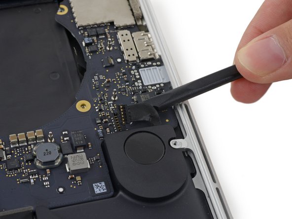

  16. MacBook Pro 15" Retina Display Mid 2015 Left Speaker Replacement: crwdns2935265:016crwdnd2935265:01crwdnd2935265:02crwdne2935265:0 MacBook Pro 15" Retina Display Mid 2015 Left Speaker Replacement: crwdns2935265:016crwdnd2935265:02crwdnd2935265:02crwdne2935265:0
    • Lift the fan and push it gently towards the back edge of the MacBook to free the fan cable from its socket.
    • The fan cable may be adhered to the logic board—to avoid tearing the cable, gently peel it up while lifting the fan.
    • Remove the fan.
    I recommend pushing the cable connector away with a spudger instead of using the fan to pull it away…there seems to be too much stress put on the cable using the method proposed here.
    Bill Klemme - crwdns2934203:0crwdne2934203:0
    Using a spudger does help alleviate stress on the cable. I also used it to help get the cable up from being adhered to the logic board.
    Joshua McMillan - crwdns2934203:0crwdne2934203:0
    Adding to the other comments, the fan is very light and has no resistance lifting out of the place it sits in.

    • Use the tip of a spudger to pry the right speaker connector up and out of its socket on the logic board.
    • Be sure to pry on the cable connector and not on the socket on the logic board. Prying on the socket may cause it to separate from the logic board.
    • Gently fold the cable up and out of the way of the logic board.
    There's not much space here to work with. I found it helpful to remove the screws holding down the battery board, which allowed it to be lifted out a bit for easier access to this connector.
    maccentric - crwdns2934203:0crwdne2934203:0
    I used the tweezers on this and that was very effective in popping this cable out.

    • Use the point of a spudger to pry the keyboard backlight connector up from its socket on the logic board.
    On reassembly it would be great to have some tips on how to properly locate this connector…it’s kind of fussy.
    Thanks for calling this out. I took a picture of the socket after disconnecting. I can see why it might have been less obvious on reassembly.
    David Carroll -
    Also on reassembly - when putting in the logic board make sure this connector is not underneath. Once you have the logic board in, double check and if needed you can slightly lift up the logic board (like to take it out) and use the spudger to scoop it out.
    Jason Joyner - crwdns2934203:0crwdne2934203:0

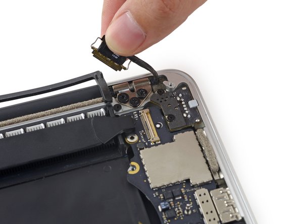

    • Use the tip of a spudger to flip up the display data cable lock and rotate it toward the MagSafe 2 power port side of the computer.
    +(mit dem schwarzen Klebeband zusammen)
    Verwende die Spitze eines Spudgers, um den Verschluss des Displaydatenkabels nach oben zu klappen (mit dem schwarzen Klebeband zusammen) und ihn in Richtung MagSafe 2-Powerport zu drehen.
    Mihály Plajner - crwdns2934203:0crwdne2934203:0
    My mid-2015 has a flexible plastic tape on the cable lock bar, pulling the tape up with tweezers easily rotated the locking bar.

  38. MacBook Pro 15" Retina Display Mid 2015 Left Speaker Replacement: crwdns2935265:038crwdnd2935265:01crwdnd2935265:03crwdne2935265:0 MacBook Pro 15" Retina Display Mid 2015 Left Speaker Replacement: crwdns2935265:038crwdnd2935265:02crwdnd2935265:03crwdne2935265:0 MacBook Pro 15" Retina Display Mid 2015 Left Speaker Replacement: crwdns2935265:038crwdnd2935265:03crwdnd2935265:03crwdne2935265:0
    • Pull the display data cable straight out of its socket on the logic board.
    • Do not lift up on the display data cable, as its socket is very fragile. Pull the cable parallel to the face of the logic board.
    • Do not touch the contacts on the data connector or its socket with your fingers or any tools, as you may deposit oils or damage the pins.
    • Gently bend the display data cable toward the display hinge, to expose the screws on the MagSafe 2 board.
    The wording of the instruction: “Pull the display data cable STRAIGHT OUT of its socket on the logic board” could lead to errors. It almost happened to me.
    Instead you should word it: “Pull the display data cable parallel to the face of the logic board being careful to keep it straight and NOT LIFT UP on the cable”.
    I realize you mention it later in the warning immediately below, however, by first saying “pull the cable straight out” leads to confusion and could lead the user to attempt to interpret “PULL STRAIGHT OUT” as “PULL UP” unsuccesfully only to later notice, maybe after breaking it, that there was a warning.
    Wording it properly the first time will make the warning unnecessary.
    I had the same thought as I almost proceeded without noticing the red text warning.
    I especially think the second warning about not touching the contacts on the data connectors should be listed before the instructions on removing it.
    David Carroll -
    Agree with Robert. Suggest “SLIDE the display cable to the right, out of its socket…” would be less misleading.
    prreitz - crwdns2934203:0crwdne2934203:0
    I think it bears repeating just how fragile this connector is, particularly on reinsertion. The problem isn’t just technicians touching the connector end; you can damage the pins simply by inserting it slightly out of alignment, or at an angle, because the outermost pins are VERY close to the edge and are very fragile. They have the appearance of being embedded in the connector but they’re actually spring traces just lying on top of it. I managed to bend the southmost pin upwards reinserting it; luckily it flattened out again and worked, but if it had not been possible to do that it’d have been a whole new screen assembly.
    Jerome - crwdns2934203:0crwdne2934203:0
    I’m pretty sure I inadvertently touched the connectors. Would this cause immediate errors or obscure, difficult-to-diagnose problems later in life ? Also strongly suggest using magnification when disconnecting and reconnecting this connector and others to ensure proper alignment. As Jerome said these are some of the most fragile parts of the system.
    I'm jumping on the bandwagon here and saying that yes, pull the cable out towards the right (where the MagSafe connector) and not up. I also found using the tweezers made this easier.
    Big fan of the tweezers.

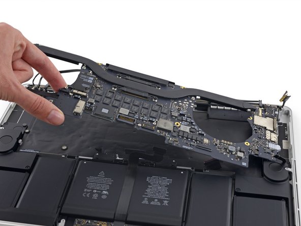

  40. MacBook Pro 15" Retina Display Mid 2015 Left Speaker Replacement: crwdns2935265:040crwdnd2935265:01crwdnd2935265:03crwdne2935265:0 MacBook Pro 15" Retina Display Mid 2015 Left Speaker Replacement: crwdns2935265:040crwdnd2935265:02crwdnd2935265:03crwdne2935265:0 MacBook Pro 15" Retina Display Mid 2015 Left Speaker Replacement: crwdns2935265:040crwdnd2935265:03crwdnd2935265:03crwdne2935265:0
    • Lift and pull the entire logic board assembly away from the wall of the upper case.
    • When reassembling, be sure to line up the ports with their cutouts in the upper case.
    When reassembling, be careful not to leave any cables (such as keyboard backlight connector, step 36) under the board.
    Andrey Pirozhenko - crwdns2934203:0crwdne2934203:0
    I had to tape most of the cables out of the way while reinstalling the logic board, because they kept returning to their plugged-in shape under the logic board as I tried to position it properly.
    Jamie Flournoy -
    Also, make sure to align the right (and left) I/O properly, making sure the tabs on each port are underneath the lip of the aluminum frame. In my case, I couldn’t push the logic board far enough to align the screws until I had done this.
    Alek Curless - crwdns2934203:0crwdne2934203:0
    Yes. This step is crucial. Thanks for pointing it out!
    jonvdez -
    I was struggling to align it and was beginning to get frustrated. I had to look back at photos to make sure the tabs had to go under the lip of the aluminum frame. Unfortunately I read your comment after the fact. Thank you.
    Robert Habib -
    if you’re only removing the right speaker, no need to remove the logic board. Simply lift the edge of the logic board to remove the speaker cable.
    Gareth Jones - crwdns2934203:0crwdne2934203:0
    I had to remove one of the screws from the battery board before the logic board had enough clearance to lift up.
    Jim Guyton - crwdns2934203:0crwdne2934203:0
    We (husband/wife team) just slid the logic board out to right, and did not entirely remove. For reassembly, we reviewed all the cables and made sure they were positioned out of the way, or taped back, before repositioning the logic board back into position. Worth it to review before getting it back into position.
    Ann Brainard - crwdns2934203:0crwdne2934203:0
    There are 2 more screws to be removed before the motherboard comes out. One were SSD was and one at 40 Degree position to right fan. It has a golden base ring. Easy to spot
    anupraje - crwdns2934203:0crwdne2934203:0
    Yes, I missed those two screws from Step 29 -- funny that we both missed that!
    kevin -
    Does the logic board prevent us from removing the battery? I’m trying to figure out why we are removing it.
    John Sikking - crwdns2934203:0crwdne2934203:0
    I agree John, tearing everything out is more of a risk then could be done ungluing the battery
    Russell G Stewart -
    Because the acetone can damage the board and connections -- in case of accident ;)
    kevin -
    why is the heatsink still attached?
