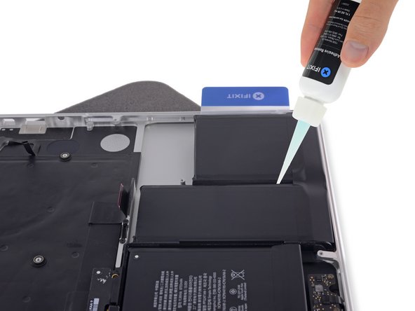

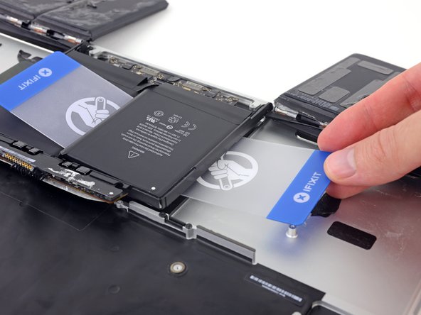

Use this guide to safely remove the glued-in battery from your MacBook Pro with the help of an iFixit battery replacement kit. The adhesive remover in your kit will dissolve the adhesive securing the battery, allowing you to remove it with ease.
Note: This guide instructs you to remove the speakers, logic board, and several other components before proceeding to the battery. This protects the components from being potentially damaged by the adhesive remover. If you're only using a mild solvent such as isopropyl alcohol to loosen the battery, you can choose to leave these components in and skip steps 6-45.
Apple issued a battery recall for this model in June of 2019—so before replacing your battery, you can check to see if you are eligible to receive a replacement for free from Apple.
iFixit adhesive remover is highly flammable. Perform this procedure in a well-ventilated area. Do not smoke or work near an open flame during this procedure.
To minimize risk of damage, turn on your MacBook and allow the battery to fully discharge before starting this procedure. A charged lithium-ion battery can create a dangerous and uncontrollable fire if accidentally punctured. If your battery is swollen, take extra precautions.

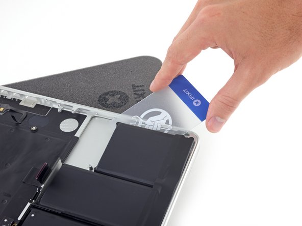

Remove the following P5 pentalobe screws securing the lower case to the MacBook Pro:
Eight 3.1 mm
Two 2.3 mm
Lifting from the edge nearest the clutch cover, lift the lower case off the MacBook Pro.

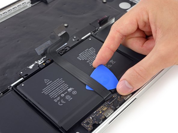

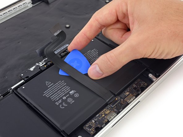

Peel back the sticker covering the battery connector.
You only need to remove the tape to the edge of the flap. This is enough to be able to pry the battery connector up.
+1 to above comment
Note that the photo is taken from the hinge side - the other way to the photo in step 3
I chanced it, didnt disconnect the battery and all is well even after giving the insides a good vacuuming before changing the SSD.
It is just the top layer of tape that you want to lift, you need to seperate it from the bottom layer.
You don’t actually need to remove the tape or even peel it off at all. Just pull up the battery connector up with the tape still attached.
pay attention that the macbook in this picture is presented the “wrong side”: if you accidentally remove the tape covering the trackpad cable and thereby also take the trackpad cable out of the zif-socket, your keyboard and trackpad won’t work anymore. putting the trackpad cable back into the (tiny) socket will fix the issue though.
Gently lift each side of the battery connector to pry the connector out of its socket on the logic board.
Bend the connector back toward the battery, ensuring that the battery connector doesn't accidentally make contact with the logic board.

After separating the battery connector, I took the addd precaution of placing a folded post-it between the connector bank and the socket.
You can also use a plastic tool to hold back the battery connector. My connector was under the plastic tab and had no screws. You may need to check the build version as there are a number of A1398 versions.
When you install the new battery, it may look like the holes in the connector need to be slid on to the connector toward the rear of the mac. I tried bending the cable to make it work. This could damage the cables. You really need only push directly downward on the connector, as you pulled up on it to remove it initially. It will pop into place with a little pressure, just make sure it's lined up properly.
I had to use quite a lot of pressure to make the connector on my new battery pop all the way down. I thought it was down already when it was only half way, as I was afraid to use too much force. Maybe it varies between different battery brands, but just make sure that the connector should go all the way down and not have a gap between the two parts.

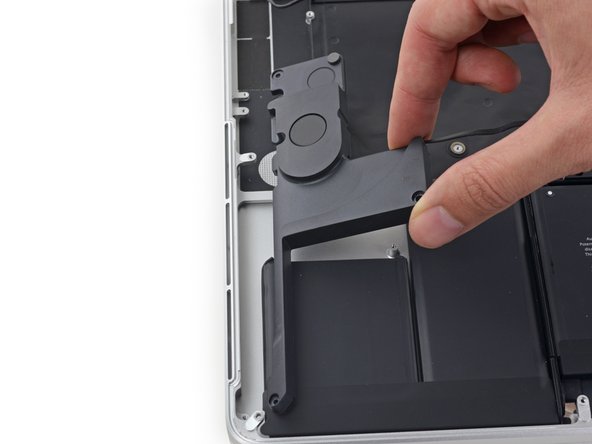

Just finished replacing both speakers using this guide. VERY good. I did not remove the individual wires - just removed the card with wires attached. Seemed to be the safer, easier way to go.

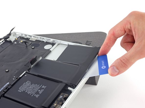

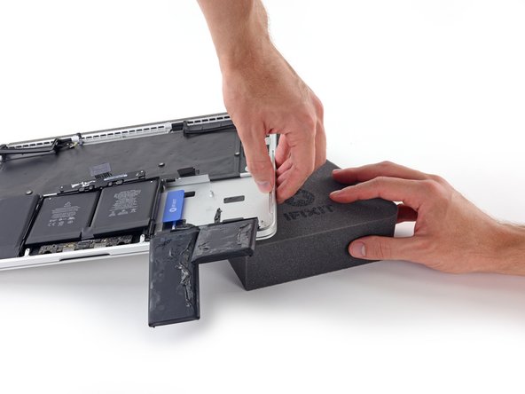

I did not bother with the danger of removing cables or cards or logic board. I spent 30 mins removing my battery carefully, using string and CT1 multisolve which isn’t dangerous to plastic.

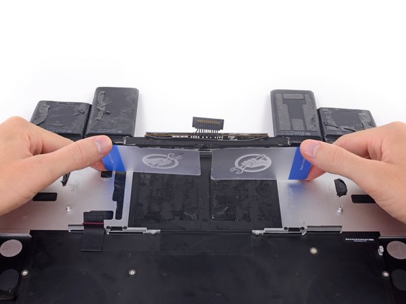

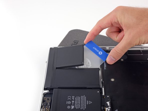

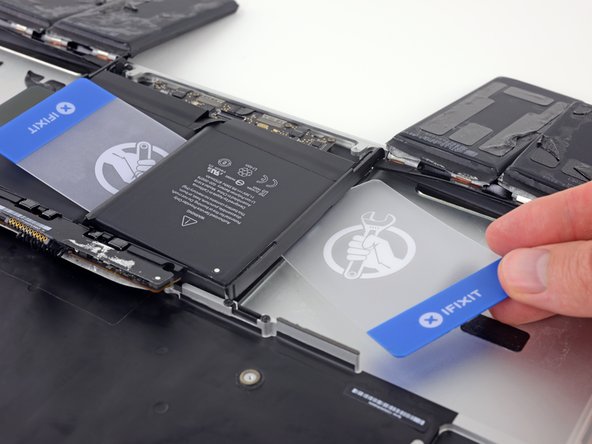

i slid my string under the battery and see-saw underneath and sprayed Ct1 Multisolve underneath. I’ve now done both my macbooks. Didn’t destroy any cables or risk it. I put a few paper sheets over my logic board to cover any spray back. Simple see-saw and a palstic card, the blue spludger and the black long spluger.
Yes, I did the full board disassembly on my 2012 macbook last year and once I finished I kind of wondered why I didn’t just work on removing the battery. Is there any real obstacle to doing so here? Can I just spend an hour or so carefully removing the battery? What’s the risk of doing that? again, is there any actual obstacle to removing the battery without pulling out the whole board assembly?
You can go straight for the battery if you’re confident enough to improvise a little. Removing the board makes sense if you’re trying to protect the speakers from getting chewed up by the solvent. Otherwise, it’s faster and easier to leave the board in place.
Agreed. Just replaced the battery on my 15” MacBook Pro 2015 and I skipped all instruction between step 6 and 46. I just unplugged the battery and removed the trackpad connection. Used some dental floss to cut through the adhesives and a card to help with carefully prying the batteries up. After the battery was removed I used some isopropanol to clean up from the old glue. Installed new battery, attached the trackpad connection ribbon and connected battery. All in all it took me less than one hour. I would not recommend removing the whole logic board just to replace the battery.

As we are only replacing the battery, you can safely skip steps 6-26 and 28-48, no need to disassemble the computer to pull out the battery. Use nail polisher remover I was able to pull a super bloated battery out, without disassembling my MacBook.
Can I replace it with early 2015 monitor? Couldn’t find a cheap mid 2015 one but I found a reasonably priced early 2015 one and I would like to have it ?
If you’re just replacing the battery, after step 5 you can skip everything else except 26-27, 34, and 50, and then continue from step 56 onwards. Instead of needing an adhesive removal, I just used a credit card to separate the battery cells from the casing they’re glued to.
After step 5, I would skip 26-27, 34 and just to 46-50. You need to remove the cable from the battery, so even if you do 26-27 and 34, you'll need to do 46-50.

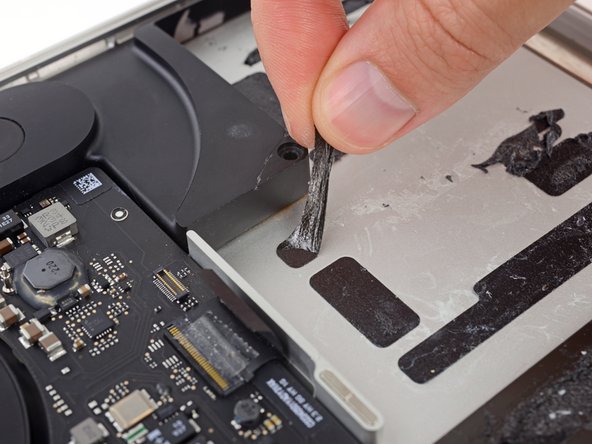

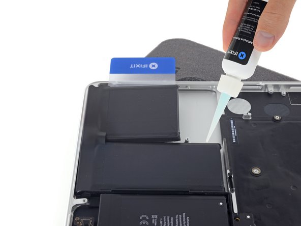

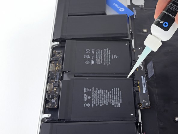

I use the solvent to remove the left over glue after the battery has been removed, but have been able to separate the battery by just sliding a card between the battery and case.

I got to this step and read a few more and was like oh shoot. I cannot be without my laptop if i mess something up and break a cable. The advice was right. I skipped all the extra removal pieces and just removed the battery. I did step 1-5. Then did step 26 and 27. Then steps 33 and 34. The finished with steps 46-51. I didn't have the blocks so i bypassed putting the laptop on a slant. so after step 51 i skipped to 56 and just started prying off the battery with a credit card and other ifix it tools. I do think the adhesive remover would be very helpful. I also wore goggles cause i caused a spark when i accident poked one of the batteries. Laptop is fine but it is very time consuming and difficult. I recommend getting the kit with the battery. Its only 10 bucks more and i think it would have saved me heaps of time!!!
Just don't do it! Like is says at the beginning, if you use a mild solvent like isopropyl alcohol, you can skip steps 6 - 45. My battery was pretty swollen and had already partially detached itself, so a little alcohol and some working with the plastic cards was all it took to get the battery freed up. Saved a lot of risky work!
This video shows how to remove the battery without all the steps explained here https://www.youtube.com/watch?v=JZ_jB9fR...
If you are careful, you can completely skip steps 6-25 and 28-45 and remove the battery pretty easily; I have done this battery replacement several times and did not have to disassemble the entire MacBook to do so.
Holy cow I removed the battery using the linked video’s technique and some patience. The batter is stuck to the chassis with double-sided tape. With care the battery can be removed without dissolving the adhesive or removing all of the parts. It seems to me that the risks of carefully removing the battery from the tape are lower than removing all of the components as presented in these instructions.

Remove the following screws securing the left speaker to the upper case:
2.7 mm T5 Torx screw
6.9 mm T5 Torx screw (with 4.5 mm shoulder)
5.6 mm T5 Torx screw
Remove the left speaker by pulling it slightly away from the side of the upper case, and out from under the aluminum tab blocking it in.
Look for multiple tasks to accomplish when doing a major tear down. I had a bad speaker I was putting off and then the battery bloat hit so put in both speakers to make them the same age. Changing out parts on this machine is easy enough with patience and careful adherence to the guides.
Thoroughly impressed with these guides. Also great to have the zoom photo options and comments are key to get other ideas and/or options as to what works. Thank you for great support and details!
And finally - success ! These guides are a great benefit to everyone bold enough to try it on their own. The photos, the warnings, even the screw descriptions and comments - all just incredibly helpful and well done. Thank you all for your contributions !

Remove the right speaker by pulling it slightly away from the side of the upper case, and out from under the aluminum tab blocking it in.
If you are replacing the LH speaker as well this can be done at this point using steps similar to 41 to 43
Unbelievable how much teardown is required to replace a speaker.
If you just need to expose the speaker, rather than replace it (e.g. to clean it of dust), you don't have to do steps 17-42. You can just leave the cables connected and hold it up

Insert an opening pick between the trackpad ribbon cable and the battery.
Carefully slide your pick underneath the length of the ribbon cable to separate the adhesive securing it to the battery.
Remove the trackpad ribbon cable.
Heads up: I almost destroyed the cable, mistakenly pulling the connector upwards. In stead it needs to be pulled towards the back of the laptop body. The photos do show this, but I didn’t pay enough attention!
I goofed when re-assembling and nearly destroyed this cable. I had installed it *before* removing the plastic film from the replacement battery. Then at the end, when I realized the plastic was still there, I completely forgot the cable was on top of it and pulled it out forcibly while removing the film. Dumb. Happily, it pulled out of the locked slider without damage. But, I am posting this so others can avoid the excitement.
I had trouble with this on reassembly - the cable just wouldn't stay in the socket even after closing the locking mechanism. I thought it looked a bit weird, because I could only get the cable in very little.
After a few tries I took a closer look at the photos here and realised my stupidity - I was putting the black "pull tab" into the connector instead of the actual cable! The pull tab wasn't sticking up at an angle like in the photos here, instead it was flush against the cable, hiding the actual connector on the cable. Very stupid mistake, but very relieving to see that the cable and the connector weren't broken, which I first feared.
They don't tell you to release the locking latch. At the front side of the connector is a small black bar that runs the length of the connector. Lift that up to release the connector from the socket.

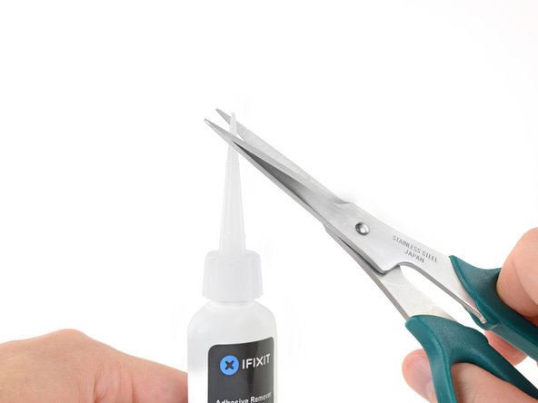

Pull off the black rubber stopper from your bottle of adhesive remover.
Use scissors to cut off the sealed tip of the applicator.
In case you’re not using the ifixit kit, this solution is almost 100% acetone. It just has some scent added to it.
You can use a bottle of acetone and a small syringe.

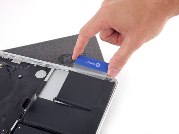

Apply a few drops of adhesive remover evenly along the elevated edge of the outer right battery cell.
Wait 2-3 minutes for the liquid adhesive remover to penetrate underneath the battery cell before you proceed to the next step.
The “You don't need to use very much” advice turned out to be a bit misleading. The acetone evaporates pretty quickly, especially if you are actually in a well-ventilated area. The adhesive does need a decent amount of acetone to soften enough to let go of the battery. The battery I removed had a substantial amount of adhesive, so at least 8-10 drops per battery cell was required.
It’s hard to count the number of drops being dispensed while precisely dispensing the solvent underneath the battery (so it doesn’t just splash around and on the top of the battery and evaporate), so my advice is to moisten the adhesive with plenty of solvent.
I agree with Jamie above. I had to use considerably more than a few drops but then the batteries have been in since 2015 so I would imagine that the adhesive might have become a bit harder. Also my batteries while working fine had become quite inflated and really really had to be replaced. So in inflating like small throw cushions, they also might have lifted up from the adhesive strips and they came out quite easily everything considered. I used old credit cards to keep them from becoming reattached. I also cleaned up the residual adhesive with some carefully applied GooGone and then wiped the inner surface clear with more of the iFixIt remover. It also worked to get the Goo off the little credit card tools. But I used the GooGone on my fingers. I had not touched the aeitone to my skin. Nor was I about too.

Slide one corner of a plastic card under the outer edge of the battery cell.
Slide the card farther underneath the battery cell to separate it from the adhesive securing it to the MacBook Pro's upper case.
Slide the card under a section and use it as a ramp to guide remover under the battery.
Lift the battery cell to separate it from the MacBook Pro's upper case, but don't try to remove it.
Leave the plastic card underneath the battery cell to prevent it from re-adhering as you proceed to the next step.

Slide one corner of your plastic card underneath the second battery cell.
Push the card underneath the second battery cell, and slide it side to side to separate the adhesive underneath.
Leave the plastic card underneath both battery cells (or flip them over) to prevent them from re-adhering as you proceed to the next step.

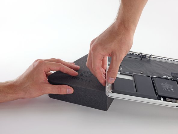

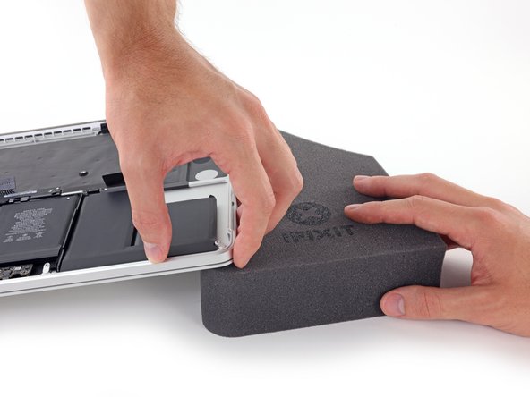

It's time to switch sides. Remove your book or foam block and place it under the opposite side of your MacBook Pro.
Repeat the procedure from the prior steps to separate the two battery cells on this side:
Apply your adhesive remover to the elevated edge of the outer left battery cell, and wait 2-3 minutes for it to penetrate.
Work one corner of a plastic card underneath the battery cell, and slide the card fully underneath the battery cell to separate it.
Do the same for the adjacent cell.
Leave your plastic card in place or flip the battery cells over to prevent them from re-adhering during the following steps.

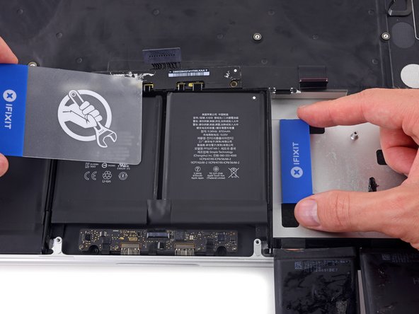

With the left edge of your MacBook Pro still propped up, apply a few drops of adhesive remover down the center line between the two middle battery cells.
Wait 2-3 minutes for the adhesive remover to penetrate before you continue.
If you can’t get the remover to drip between the cells just gently insert one of the cards and use it to funnel the remover in.
Slide one corner of a plastic card between the middle two cells, and under the elevated edge of the center-right battery cell.
Slide the card farther underneath the battery cell to slice through the adhesive securing it in place.
Don't try to fully separate this battery cell yet. Leave your plastic card in place to prevent it from re-adhering.
Unlike the nice flat left center cell illustrated, mine was so swollen and turgid that I couldn't get the angle to slide under the right center. I switched the order of process left to right. That is, the swollen left center battery had to be de-adhered first.

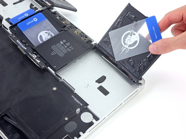

Flip the two de-adhered right-hand battery cells over the front edge of the MacBook Pro, if you haven’t already. This will allow access to the outside edge of the center cell.
Push one corner of a plastic card below the plastic battery frame and underneath the remaining adhered edge of the lower center cell.
Slide your card all the way under the battery cell, and leave it to prevent the battery cell from re-adhering.
Careful! The gap at the bottom is the track pad. You want to insert the card into the slot above this!
What do you mean by “the keyboard ribbon cable”? I don’t see anything under the battery, when I removed it. By the way: after the change, both my trackpad and keyboard are unresponsive. I bought a brand new flex cable for the trackpad and there was no change. Any thoughts will be highly appreciated =(

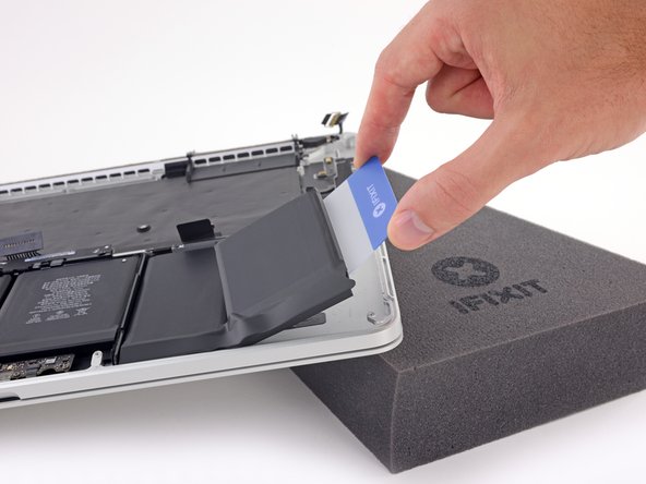

With the front edge of the MacBook Pro facing you, lift the right side and prop it up once again.
Apply a few drops of adhesive remover between the two center battery cells, so that it flows underneath the remaining battery cell.
My battery was severely swollen, to the point where there was absolutely no space between the cells to put any adhesive remover. Instead I lifted the side of the middle cell (on the elevated side of the laptop) and put the plastic card between the battery cell and the touchpad (the black plastic thing the two middle cells are attached to). Then I held the card in like a slope and poured the adhesive remover on the card to make it run down to the adhesive, this worked great. If you just pour the adhesive remover on the aluminum body, it won't reach the adhesives of the two middle cells because the trackpad is elevated above the aluminum.
I worked my way in from the sides of both cells, sliding one corner of the card back and forth and had to use quite a lot of force for the middle cells compared to the outer ones. I suspect the adhesive bonds better to the trackpad than the aluminum.

Note: The 2 center battery cells are adhered to a thin metal cover over the trackpad. Be careful to get the adhesive dissolver under the battery and over the cover. Also, the cover is very thin and can bend. Take caution when prying to not bend or damage the cover.
Remove the first card that you inserted under the final battery cell.
With one plastic card underneath each of the two center battery cells, twist and lift both cards to fully separate the battery cells, together with the plastic frame and battery board, from the MacBook Pro.
Lift and remove the battery.
With a little luck, you can slowly pull out each strip of adhesive with your fingers.
Otherwise, soak each strip of adhesive with a bit of adhesive remover for 2-3 minutes, and then scrape it out with a plastic tool. This can take quite a bit of work, so be patient.
Mop up any remaining adhesive remover and give your MacBook Pro a few minutes to air dry.

This left enough "perspex" for me to hold onto. I held the battery at a very shallow angle, lined up to the 2 screw holes and fixed the 2 screws into place. I then peeled away the "perspex" downwards while holding the outer edge of the battery cells. Be sure to hold at a very shallow angle, there isn't much "bend" between battery and the 2 holes strip.
I then lowered the cells into place and pressed them down well.
I too did this "dry" using steps 1-5, 26 & 27 then 46-50. I found using a hair drier to gently warm the case under the outer cells helped to free them.
I found opening the laptop to 90 deg, then positioning it with the screen pointing down over the edge of a table best.

If you just want to replace the battery without taking the macbook apart, follow the instructions on this video: https://youtu.be/JZ_jB9fRt6g?feature=sha.... It saves you a lot of time and prevents you from running into troubles.

I thought this too and didn't wanna do all that work with the solvent. All I removed was the battery connector and the trackpad cable before attempting to remove the battery. The adhesive Apple uses is bewilderingly strong. I thought I could pry it off with a strong paperclip and a screwdriver but it bent both. I ended up using the backend of a hammer and that worked surprisingly well. But it was super janky and I ended up puncturing the battery outer plastic. It didn't catch fire or anything but you can definitly smell the battery juices or whatever so i opened up my window. If you somewhat know what you're doing and accept the risk of setting fire to your house you can get away with not using solvent but I highly recommend doing so as the battery I ended up pulling out of my MacBook is all mangled. And if you use the solvent you have to take everything out. Apple will be Apple.
I made it within 1 hour doing Steps 1-5, then Steps 46-50.
I removed battery heating the aluminium frame in the location of battery pack on the opposite side of the frame with NTE HG-300D Mini Heat Gun, and then gently peeling this battery pack with plastic spudger. You may need to reheat the area several times.
For 2 central battery elements you can't heat aluminium frame because they are below touchpad, so I peeled batteries a little bit with spudger, heated the underneath gently, and then peeled it again. Also dental floss could help cutting the glue underneath the battery.
Thanks for your fast approach, worked fine for me as well! I did not use any glue dissolver at all.
Same for me, about an hour. I didn’t use a heat gun, just finagled the tip of the adhesive dissolver around the edges and otherwise followed the directions using the plastic cards. That dissolver is great stuff, worked twice as fast as the instructions.
Thanks for posting your short version. I did mine in about an hour with dental floss and the plastic cards. No heat. No solvent.
So glad I read the comments before going down the path of insanity.
I followed your comment to skip most of the steps and just remove the keyboard cable and the batteries. The replacement of batteries revived my water damaged MacBook Pro which stucked in boot loop.
In the beginning I tried to avoid “finagled“ situation thus only dripped a drop or 2 of dissolver each time. I also use a thin tip to induct the dissolver into the gap. But it’s very hard to do the flossing work and very slow. For the last 2 central pieces I had to drip 10 or more drops for each line of tapes which eventually helped me to remove them.
For someone who can’t order ifixit dissolver, I got my “Arctic Thermal Material Remover” from canadacomputers.com. It may not be perfect but helps. I didn’t use heat gun.

I’d recommend to do steps 26 and 27 and remove both ends of the touch pad cable!
If you are careful and tilt the whole Powerbook a bit downwards the solvent doesn’t pose any risk as it will run away from the speakers tec..

I followed the same steps and used fishing line to "rip" the glue between the battery and case. Found a video that showed it on youtube. It worked great!
Had to have a friend hold the computer in place for one "battery block" to "cut" it, but other than that, it was quite easy. :)
I also used that method - I very carefully used the minimum amount of solvent to incrementally loosen the battery for removal.
I was concerned about using heat since the old battery was pretty badly swollen - I used the solvent instead.

The dental floss suggestion is interesting. I did this (1-5, 26-27, 46-50) using IPA. Using the plastic cards from the kit, the side cells came out pretty easy, but the central cells took a while. Doing 26&27 was probably not necessary

I recommend people to check out the thread trick soo you dont need to remove all the components inside! You basicllyy just need to take of the backplate. remove two screws on the battery frame and then use a thread to cut the gluestrips between battery and bessel. I used builder string for leveling as its strong and thin. I used roughly 5 min to remove the battery from the bessel, and then another 30min to clean of the old glue. I recommend the Arctic Thermal removal (mainly for cleaning cpu), it resolves the glue at makes it gel like, then use a spachelor like the one you get un screen replacement kit and scrape it of, use a cloth or toilet paper to remove the liquid undderway. Since its in such a small bottle with drop adding you do not risk damaging the screen etc due to the acid. One of my most easiest repairs i have done! ifixit should update their approach with an alternative. Youtube “macbook retina battery replacement“ ;)
I agree with everyone that you don’t need to go through the entire process. Do Steps 1-5, then 46-50. WARNING: use as little force as possible when removing the battery, as you most certainly will rip or disconnect something else if you are not careful. Take special care with the keyboard/trackpad ribbon. When I did this repair I somehow ruined the keyboard/trackpad ribbon, and neither worked until I put another ribbon in—which is very easy. They cost pennies to replace, so you might even want to have some on hand. Everything works perfectly now!

Did This Repair using some waterproof pvc playing cards, a syringe squeeze bottle with 99.9% isopropyl and a black stick. Took about 15 minutes to free the battery, just watch out for the flex cables on the trackpad and its no problem. No real need to gut the entire frame. Would of been a bit easier with some heat applied to the outter most cells.

My Mac had a swollen battery, to the point where the chassis was bent outward both ways and the laptop wasn’t closing properly. Didn’t notice this early on since it serves as a desktop machine for me and I’m using external displays, mouse and keyboard. There are no Apple service centers in my area, so my only option was to do it myself.
There’s probably no real need to completely disassemble it (acetone, when it reacts with an adhesive used in a mac, turns into a jelly-like substance with no actual risk of flooding the internal components), but I did this anyway just to clean out all the dust inside. Now my mac is as flat, as cold and as silent as new. :)

just performed this fix and it took less than hour. skipped most of the steps, just doing 1-5 and 46-49.
after CAREFULLY removing trackpad ribbon (46-49) all you need to do is apply solvent and wait 5mins, then reapply solvent and wait another few minutes. from there you don’t even need string; just wedge the card tool and slowly work it under the batteries at the far edges, and proceed to center. that’s it. just make sure your solvent really has the time to saturate the old adhesive. also, running the battery down will help keep the area warm which definitely helps with getting things loosened up.

I Just completed this. I also skipped the disassembly of the whole machine as others have pointed out above. My battery was enormously swollen so much so that I wasn’t sure how to get the solvent in underneath it. I was able to push the battery up enough with the plastic cards to get the liquid in and start it working.
I think the swelling also meant that the battery had partially unglued itself so that made it a touch better.

Just do steps 1-5, 46-50 and then use a heat gun to heat the bottom part of the laptop, and a plastic card to carefully detach the old battery by cutting through the adhesive.

I ran in to two issues. First, step 47, the ZIF connector for the trackpad cable. I found it much easier to take off the cover and connector on the top of the battery rather than the bottom of the battery. Do what works for you. Second, the two cells in the middle were an absolute bear to get out! And I do wish the instructions were a little more clear on explaining that the frame around them are part of the battery assembly and not of the laptop housing! If they get bent a little, no big deal - they’re coming out anyway!

I also did 1-5 and 46-74. The adhesive remover works great, it comes out of the bottle fast so start with a small hole when you cut the opening. Use the remover sparingly and you’ll have no problem. I spread the remover on the edge of the card as I slid it under that battery in stead of letting the remover “run” under. The whole process took about 45 minuets with no issues. My battery was swollen and not covered by Apple’s recall, just be careful and you shouldn’t have any trouble.

afterwards use floss and card to pry up battery. Be careful not to damage cables underneath (riskiest part) mini heat gun does the trick.

Batteries had swelled to the point they just lifted out with minimal resistance. Scraped the remaining adhesive with a razor blade and re-assembled within an hour.

Did steps 1-5, 26-27, 46-50 and removed the battery with string to cut through the adhesive strips. You need a helper for this to hold the computer in place (search youtube for tips). I used fabric gift wrap ribbon. I removed the adhesive from the case (after battery is out) by carefully scraping with a spudger and smearing the adhesive remover on with a microfiber cloth. Be careful with the trackpad cable: it’s very fragile. While I was in, I also changed the thermal paste and cleaned out the fans etc. Highly recommended add-on if your machine is a bit old: It increased my cinebench score by 30% and cpu is about 10c colder at medium workloads. The entire job with add-ons took 4 hours (cleaning took the most time, you have to be careful).

Unlike removing the original battery, the ifixit was easily removed, a slight tug and up it came one cell at a time, the two center cells needed a little more persuasion. I didn’t remove any of the components apart from the ribbon strap that crosses the battery. I didn’t use any liquid adhesive remover. I duct taped all 4 sides of the laptop to a table, with the laptop held firm it was easier to exert force on each battery cell during removal.

Definitely don’t use the chemical solvent to remove the battery. The solvent will melt the adhesive strips under the batteries and turn it into a goo and make it really difficult to scrape out. Use the string trick and wear a pair of thick gloves. It’ll take a little more strength, but going back and forth with a thin, strong nylon string is way more efficient than the card/solvent method. If you need a new battery at this point, chances are your battery is swollen and will be pretty easy to get out. When you do this without the solvent, you’ll be able to peel all those adhesive strips off with a spudger in one piece - the solvent makes everything a huge mess.

Completed this last night. Didn't wait for my 99%isopropyl and just went with nail polish remover and flat cards.
Did it all with very small Qtip dabs of acetone + edge of card dipped in acetone and a bit of excessive upwards prying (ouch!!!) should have been more gentle but didn’t do any damage.
Edge ones came up easily - small rectangles of adhesive and the two main center ones more difficult.

Put a little adhesive remover under the left or right battery section, wait a minute, then squeeze the card under. Once one is removed, you have all the space needed to remove the remaining battery sections.

Personally, I used isopropyl alcohol, an old membership/credit card (you just need something that’s bendable enough to get under the cells, but not soft enough that it breaks) a syringe with a slightly bent needle to get under each cell, and followed steps 1-5 and 46-50.
I did unscrew the speakers, just so I don’t put too much pressure on them when trying to pry out the outer cells. But that’s it. And I think most people would be ok following the “short version“. You just need a bit more attention, cause you have a little less space to work with on the outer cells, but between that and taking out everything, just so you can remove the left speaker…I took the short version. :))

Risky job, dismantling all of it. I took out the battery with dental-floss, sliding underneath the battery. It cuts through the adhesive with little force. Works like a breeze. Did not have to take apart the whole computer. Was ready in about 20 minutes. Check youtube for examples.

In my case the batteries were so swollen they'd partially detached from the underside, and so removing glue mechanically wasn't a huge deal. I found using a larger / longer pick made from a large yogurt pot lid, which had right stiffness/flexibility helped a lot.

Remove the speakers and use 91% alcohol on the sides. , for central cells I recommend using tooth floss to remove the adhesive.

The battery cells were so swollen that they sort of participated in easing the process of lifting them out. I hardly needed the adhesive remover
The process of scraping the remains of double sided tape went quite well and the remaining glue came off with some of that adhesive remover

Benzine softens the adhesive very well, without any harm to plastics parts, and for anyone fancying a "gas station type" smell: the purified medical benzine does not smell at all! It also comes in very handy whenever adhesive residues have to be removed ... .
I too did the shortcut way. I found it easy to remove the outer wings of the battery with a heat gun cautiously applied (go slow and easy).
I then got myself a hypodermic needle and very carefully applied acetone (the main ingredient in the iFixit adhesive remover) in tiny amounts to loosen the adhesive under the trackpad while holding the aptop up so that gravity would cause any unwanted acetone to flow down and away from the main assembly. Using the hypodermic applicator prevented sloppy overuse of the acetone. Worked like a charm.

I used the glue softener carefully, one battery pack at a time, and it helped removal. I also watched several videos of the procedure prior to starting (thanks to all of you out there producing videos - they help).

After that I applied a little solvent to the edge of the plastic card and started working it under the battery cells, starting from the outer ones, flipping them out of the way, then the thinner ones, then finally the middle 2 cells. Each time applying solvent to the card and working it under the cells slowly.

Purchased most of the tools online my recommendation is to get the adhesive removal liquid and cards as they are so useful.

I used pure isopropyl alcohol and an eye/ear dropper bottle to apply 3-4 drops for each battery pack. Using acetone seems unnecessary - and is not good for one's health if in an enclosed space. I used dental floss for the outer 4 battery packs and credit cards for the 2 centre battery packs. A few drops of isopropyl alcohol, follow by a few scrapes with a credit card cleaned off the glue very easily. Alcohol swabs (medical) were very useful for final clean up (left no lint) (and also for clean up of thermal paste on the heat sink and CPU and GPU, which I did while I was in there. The fans can be cleaned better by removing the three tiny screws (Phillips head) and removing their covers. Also used compressed air (actually a judicious blow) to remove dust from the fan exit vents.

Any adhesive remover from the hardware store works on that adhesive, but a dry plastic spudger worked fine also.

Instead of the thin pry tool, I just used the plastic cards that came with this ifixit kit. It takes a little force and wiggle/jiggle so take your time using the corner of the card to start.

Instead of the metal spatula like thing he used - I used the plastic ifixit credit card things that came with my battery kit.
It took about 15 minutes of wiggling under the battery to free it from the adhesive but it wasn't too bad.

Up from 53, I did not use the glue remover, the plastic cards were enough.
In step 63 watch out to start from the middle. This prevents you from peeling up the lower „platform“.
