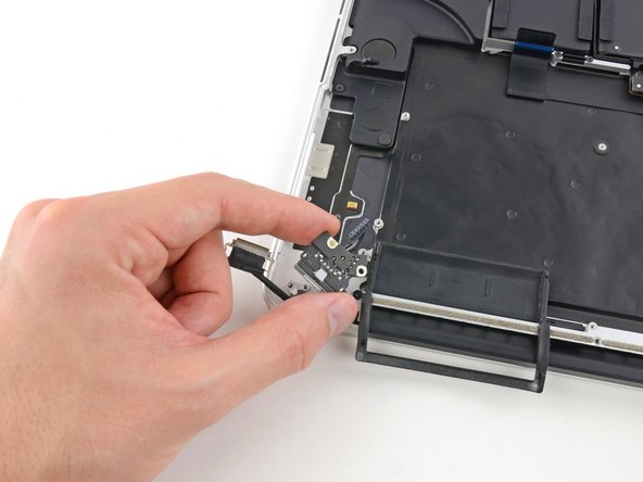

    1. MacBook Pro 15" Retina Display Mid 2014 MagSafe DC-In Board Replacement, MagSafe DC-In Board: crwdns2935265:033crwdnd2935265:01crwdnd2935265:02crwdne2935265:0 MacBook Pro 15" Retina Display Mid 2014 MagSafe DC-In Board Replacement, MagSafe DC-In Board: crwdns2935265:033crwdnd2935265:02crwdnd2935265:02crwdne2935265:0
      • Rotate the device 180 degrees to more easily access the rest of the internal components.
      • Remove the two 2.5 mm T5 Torx screws securing the MagSafe DC-In board to the upper case.
      • Slide the MagSafe DC-In board towards the right to free it from its recess within the upper case.
      • Lift and remove the MagSafe DC-In board out of the upper case assembly.
