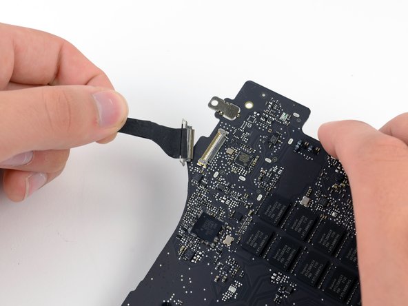

  34. MacBook Pro 15" Retina Display Mid 2014 Logic Board Replacement, Logic Board: crwdns2935265:034crwdnd2935265:01crwdnd2935265:02crwdne2935265:0 MacBook Pro 15" Retina Display Mid 2014 Logic Board Replacement, Logic Board: crwdns2935265:034crwdnd2935265:02crwdnd2935265:02crwdne2935265:0
    • Use the tip of a spudger to flip up the metal retaining flap on the HDMI data transfer cable.
    • Gently pull the HDMI data transfer cable straight out of its socket on the logic board.
  35. MacBook Pro 15" Retina Display Mid 2014 Logic Board Replacement: crwdns2935265:035crwdnd2935265:01crwdnd2935265:01crwdne2935265:0
    • Logic board remains.
