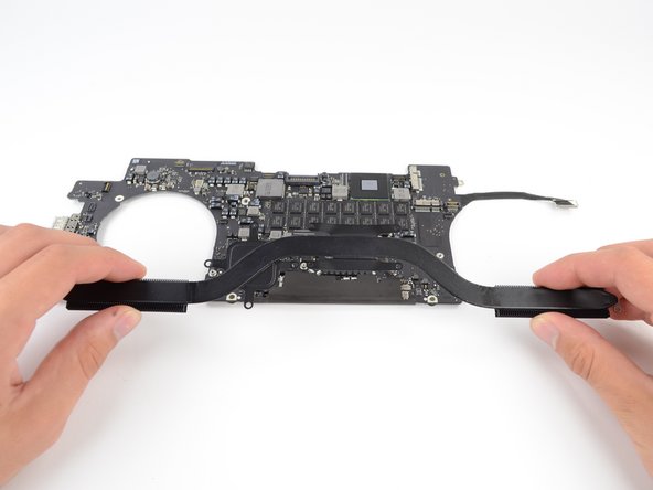

    1. MacBook Pro 15" Retina Display Mid 2012 Logic Board Replacement, Heat Sink: crwdns2935265:034crwdnd2935265:01crwdnd2935265:02crwdne2935265:0 MacBook Pro 15" Retina Display Mid 2012 Logic Board Replacement, Heat Sink: crwdns2935265:034crwdnd2935265:02crwdnd2935265:02crwdne2935265:0
      • Remove the following eight screws securing the heat sink to the logic board:
      • Two 2.4 mm T5 screws
      • Six 3.4 mm T5 screws
      • Grip both ends of the heat sink and lift it up from the logic board.
      • When installing the new heat sink, do not forget to replace the thermal paste underneath the heat sink.

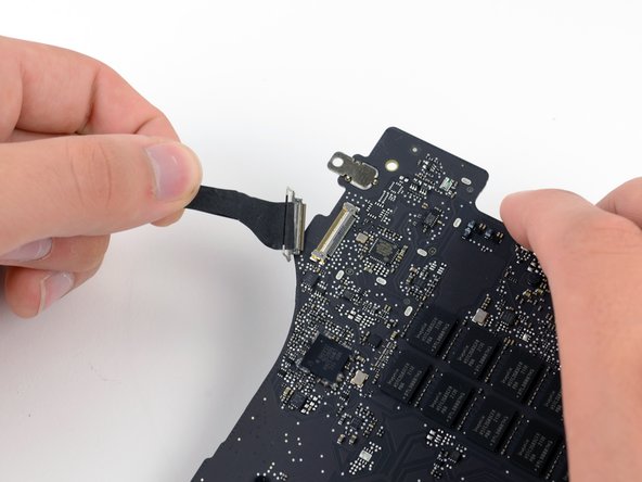

    1. MacBook Pro 15" Retina Display Mid 2012 Logic Board Replacement, Logic Board: crwdns2935265:035crwdnd2935265:01crwdnd2935265:02crwdne2935265:0 MacBook Pro 15" Retina Display Mid 2012 Logic Board Replacement, Logic Board: crwdns2935265:035crwdnd2935265:02crwdnd2935265:02crwdne2935265:0
      • Use the tip of a spudger to flip up the metal retaining flap on the HDMI data transfer cable.
      • Gently pull the HDMI data transfer cable straight out of its socket on the logic board.
    2. MacBook Pro 15" Retina Display Mid 2012 Logic Board Replacement: crwdns2935265:036crwdnd2935265:01crwdnd2935265:01crwdne2935265:0
      • Logic board remains.
