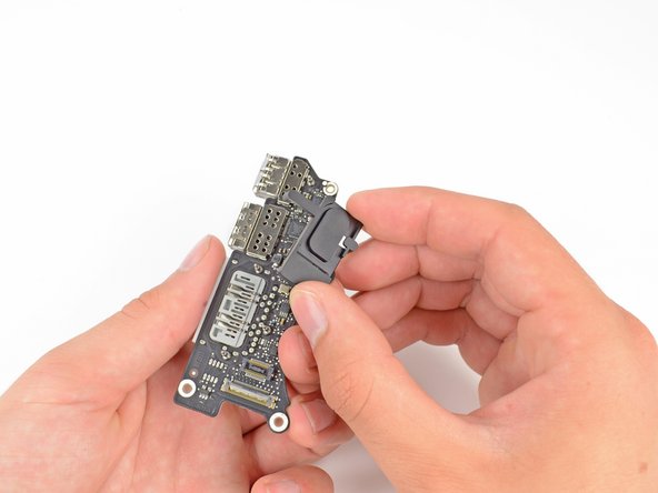

  18. MacBook Pro 15" Retina Display Mid 2012 I/O Board Replacement: crwdns2935265:018crwdnd2935265:01crwdnd2935265:02crwdne2935265:0 MacBook Pro 15" Retina Display Mid 2012 I/O Board Replacement: crwdns2935265:018crwdnd2935265:02crwdnd2935265:02crwdne2935265:0
    • With the flat of a spudger, release the clip on the right side of the plastic I/O cover.
    • After releasing the clip, you can easily lift the cover off of the board.
