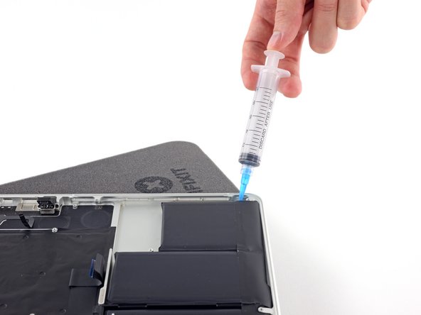

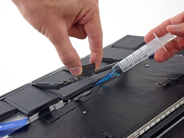

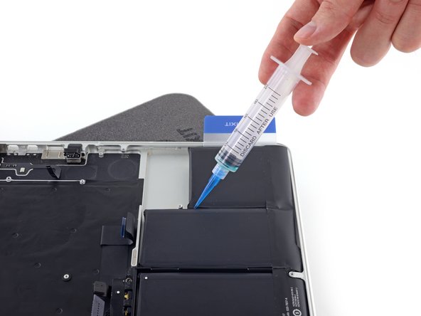

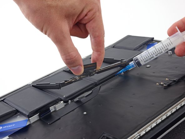

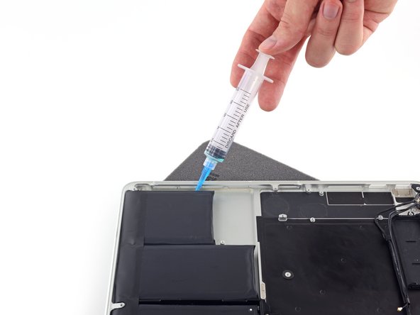

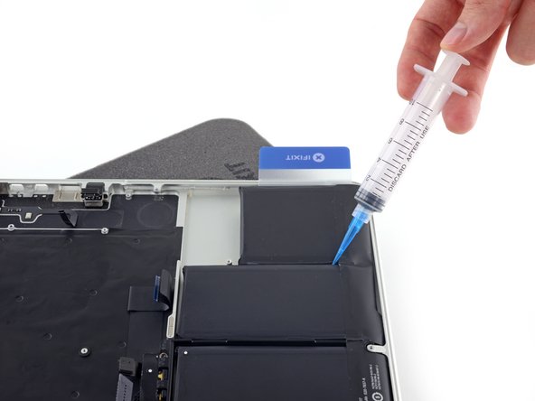

    1. MacBook Pro 15" Retina Display Mid 2012 Battery Replacement (Legacy), Battery: crwdns2935265:036crwdnd2935265:01crwdnd2935265:01crwdne2935265:0
      • Remove the two 3.9 mm T5 Torx screws securing the battery board.

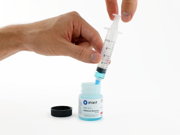

    2. MacBook Pro 15" Retina Display Mid 2012 Battery Replacement (Legacy): crwdns2935265:037crwdnd2935265:01crwdnd2935265:01crwdne2935265:0
      • The liquid adhesive remover provided in your kit can affect the antireflective coating on your MacBook Pro's display.
      • To protect your display, place a sheet of aluminum foil between the display and keyboard and leave it there while you work.

    5. MacBook Pro 15" Retina Display Mid 2012 Battery Replacement (Legacy): crwdns2935265:040crwdnd2935265:01crwdnd2935265:02crwdne2935265:0 MacBook Pro 15" Retina Display Mid 2012 Battery Replacement (Legacy): crwdns2935265:040crwdnd2935265:02crwdnd2935265:02crwdne2935265:0
      • Open your container of adhesive remover.
      • Fill the syringe included in your kit with a small amount (approximately 1-2 milliliters) of adhesive remover.
      • It's best to fill the syringe with no more than about 1-2 milliliters of adhesive remover at a time, so as to avoid accidentally applying too much.
      • Refill your syringe as needed throughout the rest of this procedure.
    6. MacBook Pro 15" Retina Display Mid 2012 Battery Replacement (Legacy): crwdns2935265:041crwdnd2935265:01crwdnd2935265:02crwdne2935265:0 MacBook Pro 15" Retina Display Mid 2012 Battery Replacement (Legacy): crwdns2935265:041crwdnd2935265:02crwdnd2935265:02crwdne2935265:0
      • Apply a small amount of adhesive remover (approximately 1 ml) evenly along the elevated edge of the outer right battery cell.
      • Wait 2-3 minutes for the liquid adhesive remover to penetrate underneath the battery cell before you proceed to the next step.

    9. MacBook Pro 15" Retina Display Mid 2012 Battery Replacement (Legacy): crwdns2935265:044crwdnd2935265:01crwdnd2935265:03crwdne2935265:0 MacBook Pro 15" Retina Display Mid 2012 Battery Replacement (Legacy): crwdns2935265:044crwdnd2935265:02crwdnd2935265:03crwdne2935265:0 MacBook Pro 15" Retina Display Mid 2012 Battery Replacement (Legacy): crwdns2935265:044crwdnd2935265:03crwdnd2935265:03crwdne2935265:0
      • Apply a small amount of adhesive remover (approximately 1 ml) evenly along the elevated edge of the next battery cell.
    10. MacBook Pro 15" Retina Display Mid 2012 Battery Replacement (Legacy): crwdns2935265:045crwdnd2935265:01crwdnd2935265:03crwdne2935265:0 MacBook Pro 15" Retina Display Mid 2012 Battery Replacement (Legacy): crwdns2935265:045crwdnd2935265:02crwdnd2935265:03crwdne2935265:0 MacBook Pro 15" Retina Display Mid 2012 Battery Replacement (Legacy): crwdns2935265:045crwdnd2935265:03crwdnd2935265:03crwdne2935265:0
      • Slide one corner of your plastic card underneath the second battery cell.
      • Push the card underneath the second battery cell, and slide it side to side to separate the adhesive underneath.
      • Leave the plastic card underneath both battery cells (or flip them over) to prevent them from re-adhering as you proceed to the next step.
    11. MacBook Pro 15" Retina Display Mid 2012 Battery Replacement (Legacy): crwdns2935265:046crwdnd2935265:01crwdnd2935265:03crwdne2935265:0 MacBook Pro 15" Retina Display Mid 2012 Battery Replacement (Legacy): crwdns2935265:046crwdnd2935265:02crwdnd2935265:03crwdne2935265:0 MacBook Pro 15" Retina Display Mid 2012 Battery Replacement (Legacy): crwdns2935265:046crwdnd2935265:03crwdnd2935265:03crwdne2935265:0
      • It's time to switch sides. Remove your book or foam block and place it under the opposite side of your MacBook Pro.
      • Repeat the procedure from the prior steps to separate the two battery cells on this side:
      • Apply your adhesive remover to the elevated edge of the outer battery cell, and wait 2-3 minutes for it to penetrate.

    14. MacBook Pro 15" Retina Display Mid 2012 Battery Replacement (Legacy): crwdns2935265:049crwdnd2935265:01crwdnd2935265:03crwdne2935265:0 MacBook Pro 15" Retina Display Mid 2012 Battery Replacement (Legacy): crwdns2935265:049crwdnd2935265:02crwdnd2935265:03crwdne2935265:0 MacBook Pro 15" Retina Display Mid 2012 Battery Replacement (Legacy): crwdns2935265:049crwdnd2935265:03crwdnd2935265:03crwdne2935265:0
      • While lifting the plastic battery frame out of the way, apply a small amount (about 1-2 ml) of adhesive remover underneath the top edge of the two remaining battery cells.
      • Wait 2-3 minutes for the adhesive remover to penetrate before you continue.
