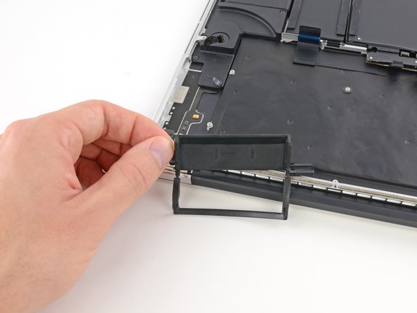

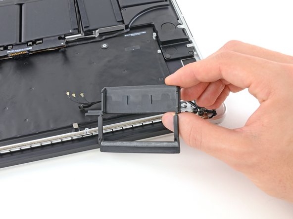

  9. MacBook Pro 15" Retina Display Late 2013 Upper Case Assembly Replacement, Rubber Hinge Covers: crwdns2935265:09crwdnd2935265:01crwdnd2935265:02crwdne2935265:0 MacBook Pro 15" Retina Display Late 2013 Upper Case Assembly Replacement, Rubber Hinge Covers: crwdns2935265:09crwdnd2935265:02crwdnd2935265:02crwdne2935265:0
    • Use the flat end of a spudger to pry the rubber hinge covers up off the left and right hinges.

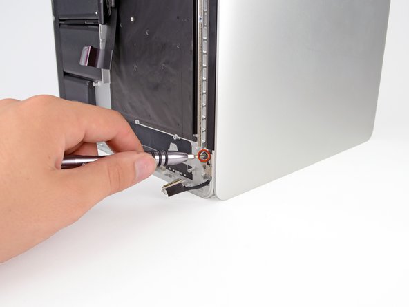

  10. MacBook Pro 15" Retina Display Late 2013 Upper Case Assembly Replacement, Display Assembly Screws: crwdns2935265:010crwdnd2935265:01crwdnd2935265:02crwdne2935265:0 MacBook Pro 15" Retina Display Late 2013 Upper Case Assembly Replacement, Display Assembly Screws: crwdns2935265:010crwdnd2935265:02crwdnd2935265:02crwdne2935265:0
    • Remove the two 3.1 mm T5 Torx screws securing the aluminum hinge covers to the upper case.
    • Remove the two aluminum hinge brackets from the MacBook Pro.

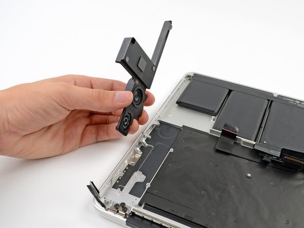

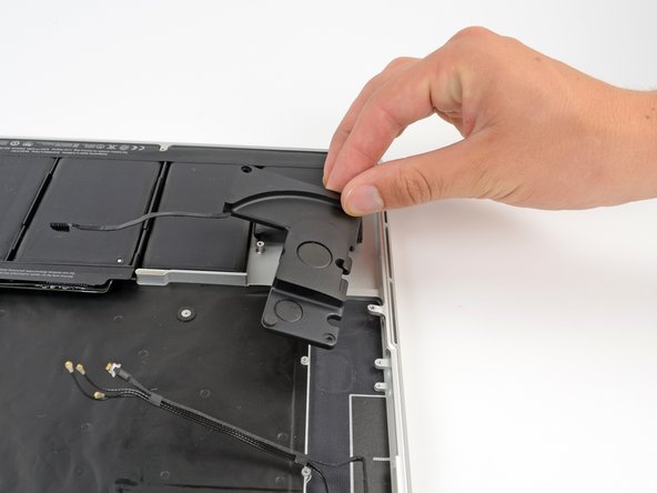

  34. MacBook Pro 15" Retina Display Late 2013 Upper Case Assembly Replacement, Upper Case Assembly: crwdns2935265:034crwdnd2935265:01crwdnd2935265:03crwdne2935265:0 MacBook Pro 15" Retina Display Late 2013 Upper Case Assembly Replacement, Upper Case Assembly: crwdns2935265:034crwdnd2935265:02crwdnd2935265:03crwdne2935265:0 MacBook Pro 15" Retina Display Late 2013 Upper Case Assembly Replacement, Upper Case Assembly: crwdns2935265:034crwdnd2935265:03crwdnd2935265:03crwdne2935265:0
    • Remove the single 2.6 mm T5 Torx screw securing the left rubber hinge cover in place.
    • Slide the hinge cover out of its bezel, then lift it up and out of the device.
    • The screw in the right hinge cover should already have been removed.
    • Slide the right cover out of its bezel, then lift it out of the device.

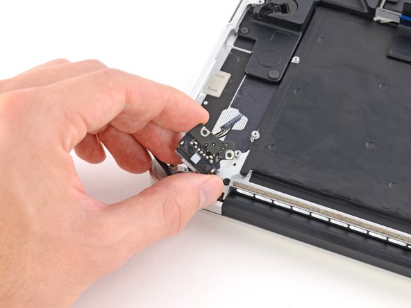

  35. MacBook Pro 15" Retina Display Late 2013 Upper Case Assembly Replacement: crwdns2935265:035crwdnd2935265:01crwdnd2935265:03crwdne2935265:0 MacBook Pro 15" Retina Display Late 2013 Upper Case Assembly Replacement: crwdns2935265:035crwdnd2935265:02crwdnd2935265:03crwdne2935265:0 MacBook Pro 15" Retina Display Late 2013 Upper Case Assembly Replacement: crwdns2935265:035crwdnd2935265:03crwdnd2935265:03crwdne2935265:0
    • Insert the edge of a plastic opening tool underneath the upper microphone.
    • Slide the blade of a plastic opening tool along the bottom of the upper microphone, releasing the adhesive.
    • Be careful when releasing the adhesive holding the cable down, as these cables have been known to tear easily.
    • In a similar manner, release the adhesive underneath the lower microphone.

  36. MacBook Pro 15" Retina Display Late 2013 Upper Case Assembly Replacement: crwdns2935265:036crwdnd2935265:01crwdnd2935265:02crwdne2935265:0 MacBook Pro 15" Retina Display Late 2013 Upper Case Assembly Replacement: crwdns2935265:036crwdnd2935265:02crwdnd2935265:02crwdne2935265:0
    • Remove the two 4.0 mm T5 Torx screws securing the MagSafe DC-In board to the upper case.
    • Depending on your model, the DC-In board may not be secured to the upper case.
    • Slide the MagSafe DC-In board towards the right to free it from its recess within the upper case.
    • Lift and remove the MagSafe DC-In board out of the upper case assembly.
  37. MacBook Pro 15" Retina Display Late 2013 Upper Case Assembly Replacement: crwdns2935265:037crwdnd2935265:01crwdnd2935265:02crwdne2935265:0 MacBook Pro 15" Retina Display Late 2013 Upper Case Assembly Replacement: crwdns2935265:037crwdnd2935265:02crwdnd2935265:02crwdne2935265:0
    • Remove the following three screws securing the left speaker to the upper case:
    • One 5.6 mm T5 Torx screw
    • One 6.9 mm T5 Torx screw
    • One 2.6 mm T5 Torx screw
    • Lift the left speaker out of the upper case and set it aside.
  38. MacBook Pro 15" Retina Display Late 2013 Upper Case Assembly Replacement: crwdns2935265:038crwdnd2935265:01crwdnd2935265:02crwdne2935265:0 MacBook Pro 15" Retina Display Late 2013 Upper Case Assembly Replacement: crwdns2935265:038crwdnd2935265:02crwdnd2935265:02crwdne2935265:0
    • Remove the following three screws securing the right speaker to the upper case:
    • Remove the right speaker from the MacBook Pro.
  39. MacBook Pro 15" Retina Display Late 2013 Upper Case Assembly Replacement: crwdns2935265:039crwdnd2935265:01crwdnd2935265:01crwdne2935265:0
    • Remove four out of the six 5.3 mm T8 Torx screws securing the display to the upper case.
    • We purposely have you leave two screws attaching the display to the upper case to aid in future steps.
  40. MacBook Pro 15" Retina Display Late 2013 Upper Case Assembly Replacement: crwdns2935265:040crwdnd2935265:01crwdnd2935265:02crwdne2935265:0 MacBook Pro 15" Retina Display Late 2013 Upper Case Assembly Replacement: crwdns2935265:040crwdnd2935265:02crwdnd2935265:02crwdne2935265:0
    • Open the device between 90 and 100 degrees, then rest it on its side.
    • While supporting both halves of the device with one hand, unscrew the upper 5.3 mm T8 Torx screw.
    • Repeat the same process for the identical bottom screw.
    • Be sure to hold the display and upper case together with one hand. Failure to do so may cause the freed display/upper case to fall, potentially damaging each component.
