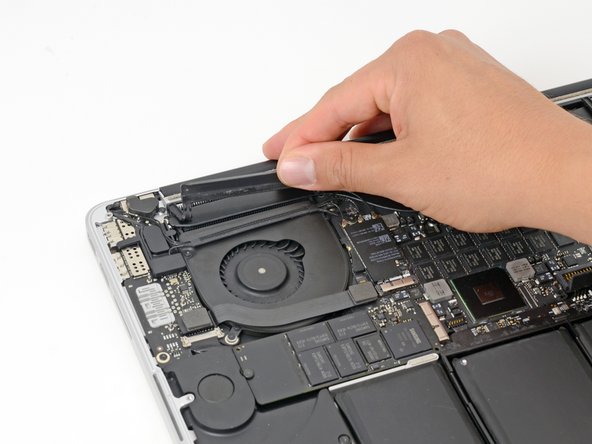

  5. MacBook Pro 15" Retina Display Late 2013 Heat Sink Replacement, Heat Sink: crwdns2935265:05crwdnd2935265:01crwdnd2935265:03crwdne2935265:0 MacBook Pro 15" Retina Display Late 2013 Heat Sink Replacement, Heat Sink: crwdns2935265:05crwdnd2935265:02crwdnd2935265:03crwdne2935265:0 MacBook Pro 15" Retina Display Late 2013 Heat Sink Replacement, Heat Sink: crwdns2935265:05crwdnd2935265:03crwdnd2935265:03crwdne2935265:0
    • Insert the flat end of a spudger underneath the rubber heat sink cover on the right fan.
    • Slide the spudger underneath the length of the cover, releasing the adhesive.
    • Lift the cover and rotate it off of the heat sink.

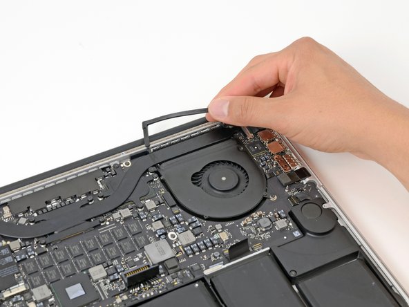

  6. MacBook Pro 15" Retina Display Late 2013 Heat Sink Replacement: crwdns2935265:06crwdnd2935265:01crwdnd2935265:03crwdne2935265:0 MacBook Pro 15" Retina Display Late 2013 Heat Sink Replacement: crwdns2935265:06crwdnd2935265:02crwdnd2935265:03crwdne2935265:0 MacBook Pro 15" Retina Display Late 2013 Heat Sink Replacement: crwdns2935265:06crwdnd2935265:03crwdnd2935265:03crwdne2935265:0
    • In the same manner described above, release the adhesive and flip back the heat sink cover on the left fan.
