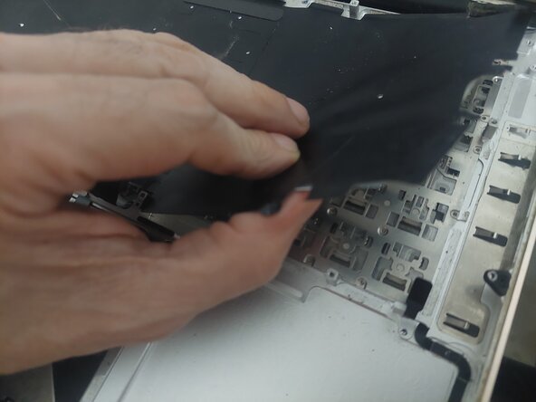

    • We have to remove the backlight carefully as not to damage it, if you are replacing this component then you can simply pull it off.
    • The backlight consists of 3 layers, the very fragile backlight covering, a clear plastic layer and a very fragile keyboard layout template. We DO NOT want to damage these in any way if we are to use them again, so ultimate care is needed. They are stuck together but with plenty of care they can be separated.
    • Using a sharp small craft knife or similar, very carefully lift up the surrounding edge of the backlight by running the blade underneath where the adhesive is located, as we do not want to tear this extremely fragile component.
    • Some may suggest to use a heat gun to soften any adhesive but this will more than likely deform the backlight from the heat, rendering it useless.
    • Once we have a fair sized area lifted we can very gently pull away the backlight using extra care not to tear it. We can use the strength of the middle plastic sheet to assist in lifting it away. Once removed put it to the side as it will be used again in a later stage.
    • We can gently brush or wipe off any stains or debris that may have built up over time using a soft brush or cloth with some alcohol making the part nice and clean ready for re-installation.

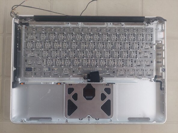

  3. MacBook Pro 13" Unibody Mid 2012 Keyboard Replacement, Remove ALL of the screws: crwdns2935265:03crwdnd2935265:01crwdnd2935265:02crwdne2935265:0 MacBook Pro 13" Unibody Mid 2012 Keyboard Replacement, Remove ALL of the screws: crwdns2935265:03crwdnd2935265:02crwdnd2935265:02crwdne2935265:0
    • Now for the fun part, removing all of the tiny screws.
    • 1st we will remove the 3 screws that secure the power button.
    • Then we will remove all of the 80 or so tiny screws that secure the keyboard to the case.

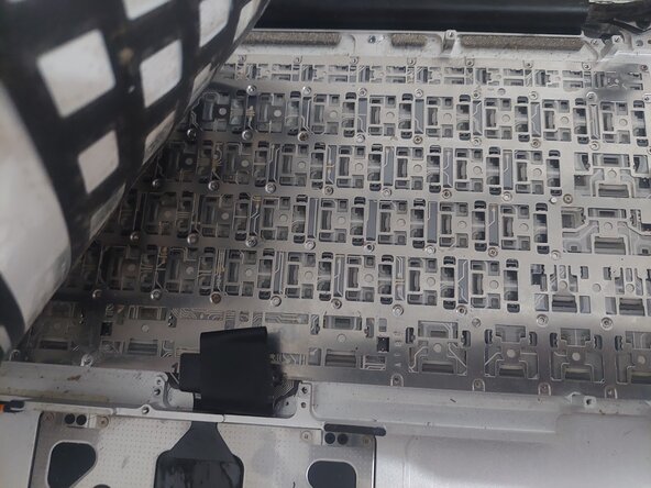

  4. MacBook Pro 13" Unibody Mid 2012 Keyboard Replacement, Removing the keyboard: crwdns2935265:04crwdnd2935265:01crwdnd2935265:01crwdne2935265:0
    • Once we have removed ll the screws we can lift out the keyboard.
    • Pay attention the the power button and carefully wiggle it out of its slot on the case, there is a grounding wire nearby that we do not want to tear away from it's soldering point.
  5. MacBook Pro 13" Unibody Mid 2012 Keyboard Replacement, Remove any remaining debris or dirt: crwdns2935265:05crwdnd2935265:01crwdnd2935265:01crwdne2935265:0
    • Now is a good time to get a cloth and give a good clean out of the key holes on the casing as they are prone to collect dirt or debris from sticky fingers in the past.
