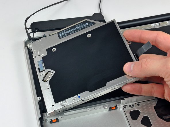

  26. MacBook Pro 13" Unibody Mid 2010 Upper Case Replacement: crwdns2935265:026crwdnd2935265:01crwdnd2935265:02crwdne2935265:0 MacBook Pro 13" Unibody Mid 2010 Upper Case Replacement: crwdns2935265:026crwdnd2935265:02crwdnd2935265:02crwdne2935265:0
    • Remove the three 2.5 mm Phillips screws securing the optical drive to the upper case.
    • Lift the optical drive from its right edge and pull it out of the computer.

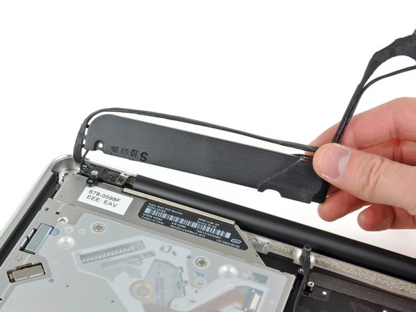

    • Use the tip of a spudger to pry the right speaker up off the adhesive securing it to the upper case.
  29. MacBook Pro 13" Unibody Mid 2010 Upper Case Replacement: crwdns2935265:029crwdnd2935265:01crwdnd2935265:01crwdne2935265:0
    • Lift the subwoofer and right speaker assembly out of the upper case.

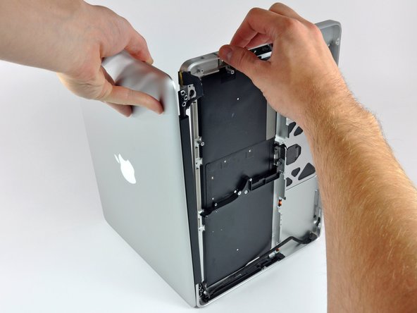

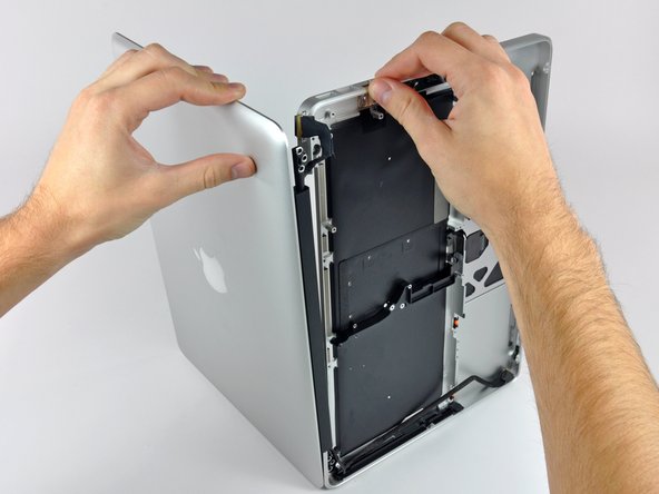

  31. MacBook Pro 13" Unibody Mid 2010 Upper Case Replacement: crwdns2935265:031crwdnd2935265:01crwdnd2935265:01crwdne2935265:0
    • Open your MacBook so the display is perpendicular to the upper case.
    • Place your opened MacBook on a table as pictured.
    • While holding the display and upper case together with your left hand, remove the T8 Torx screw from the lower display bracket.
  32. MacBook Pro 13" Unibody Mid 2010 Upper Case Replacement: crwdns2935265:032crwdnd2935265:01crwdnd2935265:01crwdne2935265:0
    • Be sure to hold the display and upper case together with your left hand. Failure to do so may cause the freed display/upper case to fall, potentially damaging each component.
    • Remove the last remaining T8 Torx screw securing the display to the upper case.
  33. MacBook Pro 13" Unibody Mid 2010 Upper Case Replacement: crwdns2935265:033crwdnd2935265:01crwdnd2935265:03crwdne2935265:0 MacBook Pro 13" Unibody Mid 2010 Upper Case Replacement: crwdns2935265:033crwdnd2935265:02crwdnd2935265:03crwdne2935265:0 MacBook Pro 13" Unibody Mid 2010 Upper Case Replacement: crwdns2935265:033crwdnd2935265:03crwdnd2935265:03crwdne2935265:0
    • Grab the upper case with your right hand and rotate it slightly toward the top of the display so the upper display bracket clears the edge of the upper case.
    • Rotate the display slightly away from the upper case.
    • Lift the display up and away from the upper case, minding any brackets or cables that may get caught.
