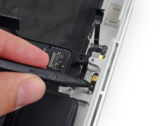

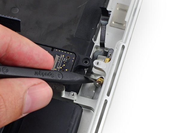

    7. MacBook Pro 13" Retina Display Mid 2014 Dual Microphone Assembly Replacement: crwdns2935265:039crwdnd2935265:01crwdnd2935265:03crwdne2935265:0 MacBook Pro 13" Retina Display Mid 2014 Dual Microphone Assembly Replacement: crwdns2935265:039crwdnd2935265:02crwdnd2935265:03crwdne2935265:0 MacBook Pro 13" Retina Display Mid 2014 Dual Microphone Assembly Replacement: crwdns2935265:039crwdnd2935265:03crwdnd2935265:03crwdne2935265:0
      • Insert the tip of a spudger underneath the connector end of the microphone ribbon cable and slide it toward the screw post to free that half from the upper case.
      • If the microphone is very resistant to prying, try heating it with an iOpener. Heating it will soften the adhesive and minimize the risk of tearing the cable.
    8. MacBook Pro 13" Retina Display Mid 2014 Dual Microphone Assembly Replacement: crwdns2935265:040crwdnd2935265:01crwdnd2935265:03crwdne2935265:0 MacBook Pro 13" Retina Display Mid 2014 Dual Microphone Assembly Replacement: crwdns2935265:040crwdnd2935265:02crwdnd2935265:03crwdne2935265:0 MacBook Pro 13" Retina Display Mid 2014 Dual Microphone Assembly Replacement: crwdns2935265:040crwdnd2935265:03crwdnd2935265:03crwdne2935265:0
      • Insert the tip of a spudger under the battery-side portion of the microphone ribbon cable and slide it toward the screw post to free it from the upper case.
    9. MacBook Pro 13" Retina Display Mid 2014 Dual Microphone Assembly Replacement: crwdns2935265:041crwdnd2935265:01crwdnd2935265:02crwdne2935265:0 MacBook Pro 13" Retina Display Mid 2014 Dual Microphone Assembly Replacement: crwdns2935265:041crwdnd2935265:02crwdnd2935265:02crwdne2935265:0
      • Pull the dual microphone cable assembly up and toward the logic board recess to remove it from the upper case.
      • Be very careful not to snag the cable on the screw post in the case or the battery contact board.
