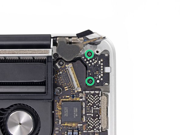

  5. MacBook Pro 13" Retina Display Late 2012 Upper Case Replacement: crwdns2935265:05crwdnd2935265:01crwdnd2935265:01crwdne2935265:0
    • Remove the following screws securing the battery connector board to the logic board:
    • Two 2.8 mm T6 Torx screws
    • One 7.0 mm T6 Torx shouldered screw

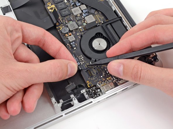

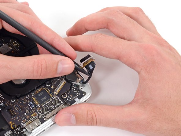

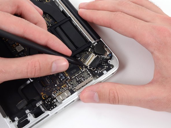

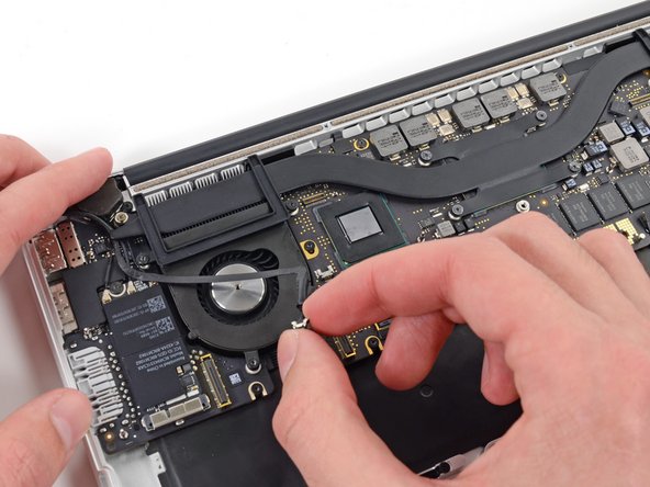

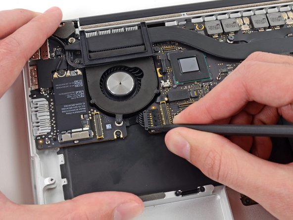

  10. MacBook Pro 13" Retina Display Late 2012 Upper Case Replacement, I/O Board Data Cable: crwdns2935265:010crwdnd2935265:01crwdnd2935265:02crwdne2935265:0 MacBook Pro 13" Retina Display Late 2012 Upper Case Replacement, I/O Board Data Cable: crwdns2935265:010crwdnd2935265:02crwdnd2935265:02crwdne2935265:0
    • Use the flat end of a spudger to pry the right side of the I/O board data cable connector up off its socket on the I/O board.
    • When prying the I/O board data cable connector from its socket, make sure to pry the connector itself and not the socket. Prying the socket may cause irreversible damage to the I/O board.
  11. MacBook Pro 13" Retina Display Late 2012 Upper Case Replacement: crwdns2935265:011crwdnd2935265:01crwdnd2935265:02crwdne2935265:0 MacBook Pro 13" Retina Display Late 2012 Upper Case Replacement: crwdns2935265:011crwdnd2935265:02crwdnd2935265:02crwdne2935265:0
    • Wedge the flat end of a spudger beneath the left side of the I/O board data cable connector.
    • Gently twist the spudger to disconnect the I/O board data cable connector from its socket on the logic board.

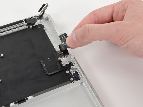

  12. MacBook Pro 13" Retina Display Late 2012 Upper Case Replacement: crwdns2935265:012crwdnd2935265:01crwdnd2935265:01crwdne2935265:0
    • Lift and remove the I/O board data cable from the MacBook Pro.

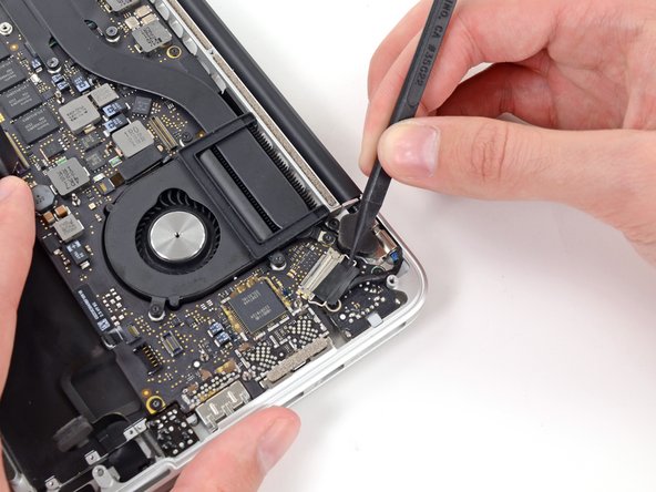

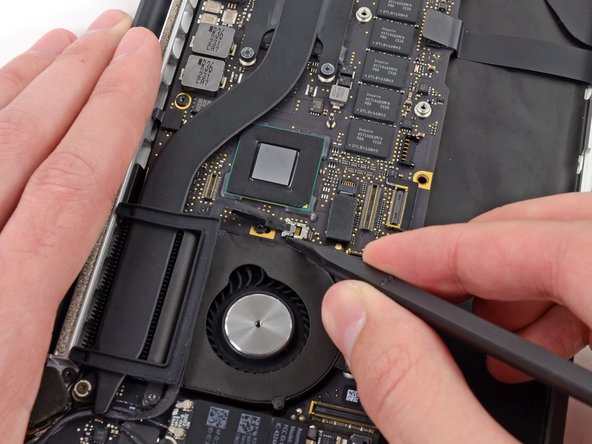

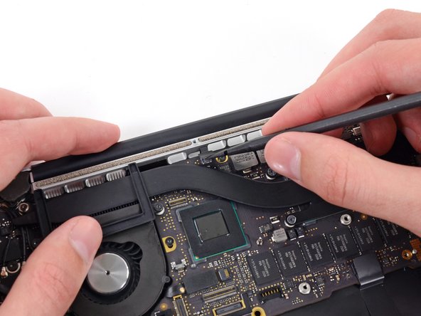

  13. MacBook Pro 13" Retina Display Late 2012 Upper Case Replacement, Right Speaker: crwdns2935265:013crwdnd2935265:01crwdnd2935265:03crwdne2935265:0 MacBook Pro 13" Retina Display Late 2012 Upper Case Replacement, Right Speaker: crwdns2935265:013crwdnd2935265:02crwdnd2935265:03crwdne2935265:0 MacBook Pro 13" Retina Display Late 2012 Upper Case Replacement, Right Speaker: crwdns2935265:013crwdnd2935265:03crwdnd2935265:03crwdne2935265:0
    • Use the flat end of a spudger to pry the SSD cable connector up from its socket on the logic board.
    • Move the SSD cable connector out of the way.
  14. MacBook Pro 13" Retina Display Late 2012 Upper Case Replacement: crwdns2935265:014crwdnd2935265:01crwdnd2935265:02crwdne2935265:0 MacBook Pro 13" Retina Display Late 2012 Upper Case Replacement: crwdns2935265:014crwdnd2935265:02crwdnd2935265:02crwdne2935265:0
    • Wedge the pointed end of a spudger beneath the right speaker cable connector.
    • Gently pry the right speaker cable connector up off from its socket on the logic board.
    • Be sure you are prying up on the connector, not the socket itself.

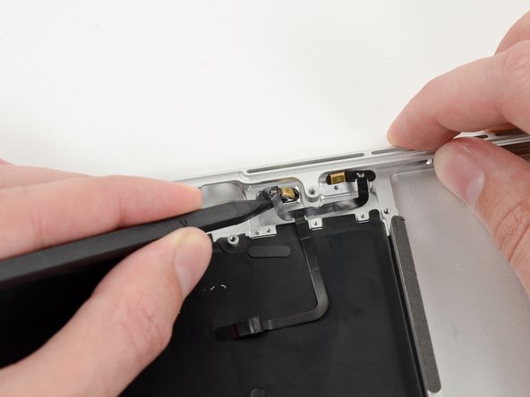

  17. MacBook Pro 13" Retina Display Late 2012 Upper Case Replacement, Left Speaker: crwdns2935265:017crwdnd2935265:01crwdnd2935265:03crwdne2935265:0 MacBook Pro 13" Retina Display Late 2012 Upper Case Replacement, Left Speaker: crwdns2935265:017crwdnd2935265:02crwdnd2935265:03crwdne2935265:0 MacBook Pro 13" Retina Display Late 2012 Upper Case Replacement, Left Speaker: crwdns2935265:017crwdnd2935265:03crwdnd2935265:03crwdne2935265:0
    • Use the flat end of a spudger to pry the headphone jack cable connector straight up off its socket on the logic board.
    • Gently bend the headphone jack cable to 90° up from the logic board.
    • Bending the headphone jack cable will allow you to disconnect the left speaker cable connector without having the headphone jack cable in the way.

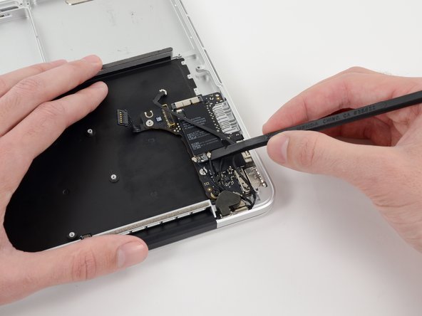

  23. MacBook Pro 13" Retina Display Late 2012 Upper Case Replacement, Battery: crwdns2935265:023crwdnd2935265:01crwdnd2935265:02crwdne2935265:0 MacBook Pro 13" Retina Display Late 2012 Upper Case Replacement, Battery: crwdns2935265:023crwdnd2935265:02crwdnd2935265:02crwdne2935265:0
    • Remove three 2.2 mm T5 Torx screws from each side of the battery (six screws total).
  24. MacBook Pro 13" Retina Display Late 2012 Upper Case Replacement: crwdns2935265:024crwdnd2935265:01crwdnd2935265:01crwdne2935265:0
    • The liquid adhesive remover provided in your kit can affect the antireflective coating on your MacBook Pro's display.
    • To protect your display, place a sheet of aluminum foil between the display and keyboard and leave it there while you work.
  25. MacBook Pro 13" Retina Display Late 2012 Upper Case Replacement: crwdns2935265:025crwdnd2935265:01crwdnd2935265:02crwdne2935265:0 MacBook Pro 13" Retina Display Late 2012 Upper Case Replacement: crwdns2935265:025crwdnd2935265:02crwdnd2935265:02crwdne2935265:0

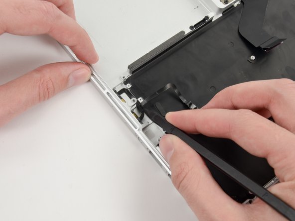

  32. MacBook Pro 13" Retina Display Late 2012 Upper Case Replacement: crwdns2935265:032crwdnd2935265:01crwdnd2935265:03crwdne2935265:0 MacBook Pro 13" Retina Display Late 2012 Upper Case Replacement: crwdns2935265:032crwdnd2935265:02crwdnd2935265:03crwdne2935265:0 MacBook Pro 13" Retina Display Late 2012 Upper Case Replacement: crwdns2935265:032crwdnd2935265:03crwdnd2935265:03crwdne2935265:0
    • Grasp the battery cells and gently move (but do not remove) them from their recess in the upper case.
    • Leave the battery cells resting on top of the upper case as shown in the third picture.

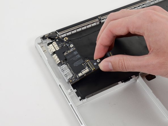

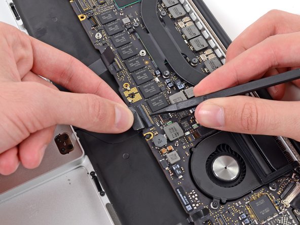

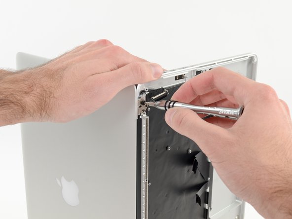

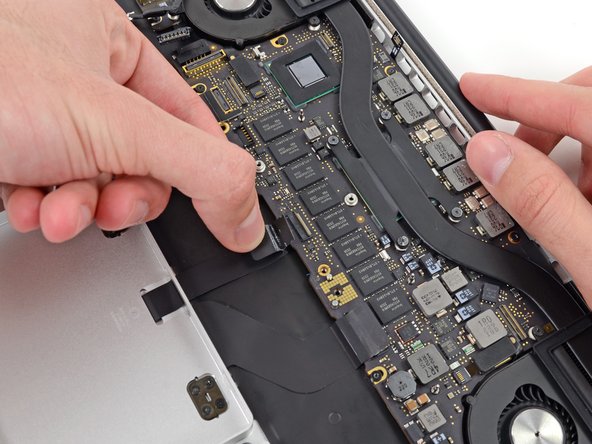

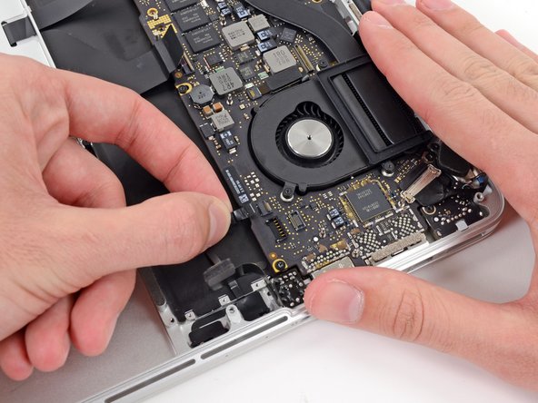

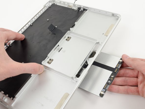

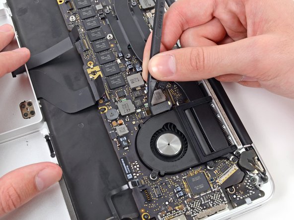

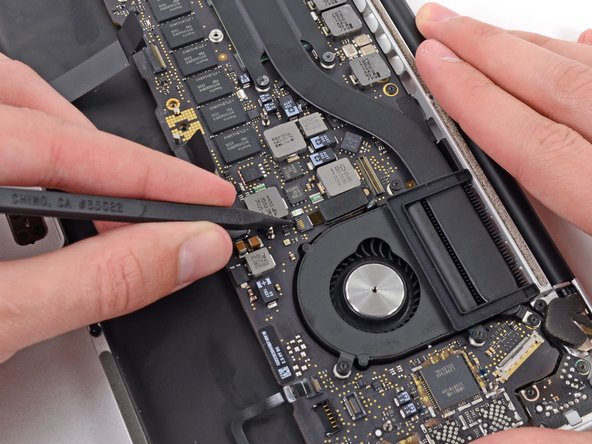

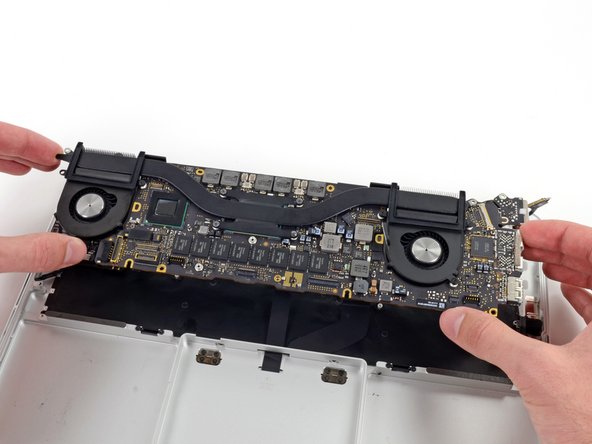

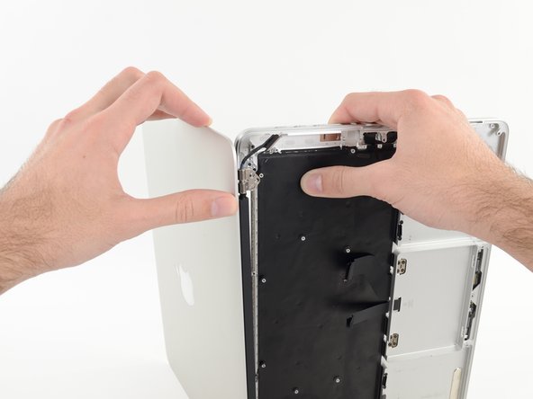

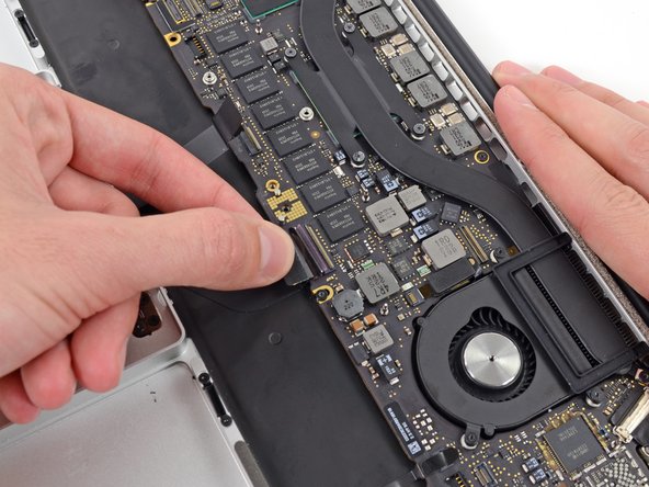

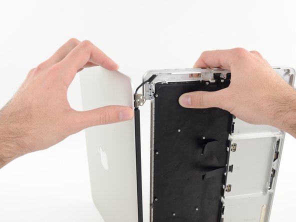

  35. MacBook Pro 13" Retina Display Late 2012 Upper Case Replacement, Logic Board Assembly: crwdns2935265:035crwdnd2935265:01crwdnd2935265:02crwdne2935265:0 MacBook Pro 13" Retina Display Late 2012 Upper Case Replacement, Logic Board Assembly: crwdns2935265:035crwdnd2935265:02crwdnd2935265:02crwdne2935265:0
    • Use the tip of a spudger to push the edges of the I/O board connector straight out of its socket on the logic board.
    • It is recommended to carefully push on both sides of the connector to "walk" it out of its socket.

    • Use the tip of a spudger to push the iSight camera cable connector straight away from its socket on the logic board.
  37. MacBook Pro 13" Retina Display Late 2012 Upper Case Replacement: crwdns2935265:037crwdnd2935265:01crwdnd2935265:02crwdne2935265:0 MacBook Pro 13" Retina Display Late 2012 Upper Case Replacement: crwdns2935265:037crwdnd2935265:02crwdnd2935265:02crwdne2935265:0
    • Move the iSight camera cable aside.

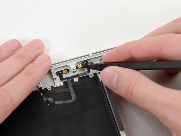

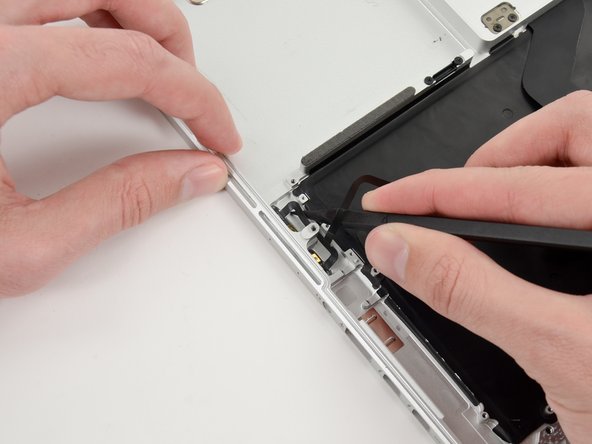

    • Wedge the flat end of a spudger underneath the keyboard backlight connector and the logic board.
    • Gently twist the flat end of a spudger upwards to pry the keyboard backlight connector up off its socket on the logic board.

    • Use the tip of a spudger to flip up the retaining flap on the trackpad ribbon cable ZIF socket.
    • Grasp the plastic pull tab and pull the trackpad ribbon cable out of its socket.
  40. MacBook Pro 13" Retina Display Late 2012 Upper Case Replacement: crwdns2935265:040crwdnd2935265:01crwdnd2935265:03crwdne2935265:0 MacBook Pro 13" Retina Display Late 2012 Upper Case Replacement: crwdns2935265:040crwdnd2935265:02crwdnd2935265:03crwdne2935265:0 MacBook Pro 13" Retina Display Late 2012 Upper Case Replacement: crwdns2935265:040crwdnd2935265:03crwdnd2935265:03crwdne2935265:0
    • Use the tip of a spudger to flip up the retaining flap on the keyboard ribbon cable ZIF socket.
    • Grasp the plastic pull tab and pull the keyboard ribbon cable out of its socket.
  41. MacBook Pro 13" Retina Display Late 2012 Upper Case Replacement: crwdns2935265:041crwdnd2935265:01crwdnd2935265:03crwdne2935265:0 MacBook Pro 13" Retina Display Late 2012 Upper Case Replacement: crwdns2935265:041crwdnd2935265:02crwdnd2935265:03crwdne2935265:0 MacBook Pro 13" Retina Display Late 2012 Upper Case Replacement: crwdns2935265:041crwdnd2935265:03crwdnd2935265:03crwdne2935265:0
    • Use the tip of a spudger to flip up the retaining flap on the microphone ribbon cable ZIF socket.
    • Grasp the plastic pull tab and pull the microphone ribbon cable out of its socket.
  42. MacBook Pro 13" Retina Display Late 2012 Upper Case Replacement: crwdns2935265:042crwdnd2935265:01crwdnd2935265:02crwdne2935265:0 MacBook Pro 13" Retina Display Late 2012 Upper Case Replacement: crwdns2935265:042crwdnd2935265:02crwdnd2935265:02crwdne2935265:0
    • Use the tip of a spudger to rotate the pull tab secured to the display data cable lock toward the DC-In side of the computer.
  43. MacBook Pro 13" Retina Display Late 2012 Upper Case Replacement: crwdns2935265:043crwdnd2935265:01crwdnd2935265:03crwdne2935265:0 MacBook Pro 13" Retina Display Late 2012 Upper Case Replacement: crwdns2935265:043crwdnd2935265:02crwdnd2935265:03crwdne2935265:0 MacBook Pro 13" Retina Display Late 2012 Upper Case Replacement: crwdns2935265:043crwdnd2935265:03crwdnd2935265:03crwdne2935265:0
    • Gently push the edges of the display data cable connector away from its socket on the logic board.
    • It is recommended "walk" the connector out of its socket. Simply push the top and bottom corners of the connector and carefully "walk it out" of its socket.
    • Pull, but do not remove, the display data cable connector out of its socket and carefully move it out of the way.
  44. MacBook Pro 13" Retina Display Late 2012 Upper Case Replacement: crwdns2935265:044crwdnd2935265:01crwdnd2935265:03crwdne2935265:0 MacBook Pro 13" Retina Display Late 2012 Upper Case Replacement: crwdns2935265:044crwdnd2935265:02crwdnd2935265:03crwdne2935265:0 MacBook Pro 13" Retina Display Late 2012 Upper Case Replacement: crwdns2935265:044crwdnd2935265:03crwdnd2935265:03crwdne2935265:0
    • Use the tip of a spudger to flip up the retaining flap on the left fan ribbon cable ZIF socket.
    • Carefully pull the left fan ribbon cable out of its socket.
  45. MacBook Pro 13" Retina Display Late 2012 Upper Case Replacement: crwdns2935265:045crwdnd2935265:01crwdnd2935265:01crwdne2935265:0
    • Move the left fan ribbon cable aside to reveal a hidden screw securing the logic board assembly to the upper case.
  46. MacBook Pro 13" Retina Display Late 2012 Upper Case Replacement: crwdns2935265:046crwdnd2935265:01crwdnd2935265:02crwdne2935265:0 MacBook Pro 13" Retina Display Late 2012 Upper Case Replacement: crwdns2935265:046crwdnd2935265:02crwdnd2935265:02crwdne2935265:0

    • Remove two more screws, from the MagSafe DC-In board in the upper right corner (second image).
    • Two 3.4 mm T5 Torx screws
  47. MacBook Pro 13" Retina Display Late 2012 Upper Case Replacement: crwdns2935265:047crwdnd2935265:01crwdnd2935265:02crwdne2935265:0 MacBook Pro 13" Retina Display Late 2012 Upper Case Replacement: crwdns2935265:047crwdnd2935265:02crwdnd2935265:02crwdne2935265:0
    • Carefully lift the logic board assembly from its left side and work it out of the upper case, minding any cables and the I/O ports that may get caught during removal.
    • Pull the right I/O port side of the logic board away from the side of the upper case and remove the logic board assembly.
  48. MacBook Pro 13" Retina Display Late 2012 Upper Case Replacement, I/O Board: crwdns2935265:048crwdnd2935265:01crwdnd2935265:03crwdne2935265:0 MacBook Pro 13" Retina Display Late 2012 Upper Case Replacement, I/O Board: crwdns2935265:048crwdnd2935265:02crwdnd2935265:03crwdne2935265:0 MacBook Pro 13" Retina Display Late 2012 Upper Case Replacement, I/O Board: crwdns2935265:048crwdnd2935265:03crwdnd2935265:03crwdne2935265:0
    • Use the flat end of a spudger to pry and disconnect the three antenna cable connectors from the AirPort board.
    • The three cables are coded with black sleeves of different lengths. During reassembly:
    • Connect the long-sleeved cable to the center socket.
    • The short-sleeved cable connects next to the screw.
    • The remaining cable has no sleeve, and connects in the last empty socket, next to the fan.
  49. MacBook Pro 13" Retina Display Late 2012 Upper Case Replacement: crwdns2935265:049crwdnd2935265:01crwdnd2935265:01crwdne2935265:0
    • Remove the following two screws securing the I/O board to the upper case:
    • One 3.53 mm T5 Torx screw
    • One 4.89 mm T8 Torx standoff screw
  50. MacBook Pro 13" Retina Display Late 2012 Upper Case Replacement: crwdns2935265:050crwdnd2935265:01crwdnd2935265:02crwdne2935265:0 MacBook Pro 13" Retina Display Late 2012 Upper Case Replacement: crwdns2935265:050crwdnd2935265:02crwdnd2935265:02crwdne2935265:0
    • Carefully pull and remove the I/O board away from its recess in the upper case.
  51. MacBook Pro 13" Retina Display Late 2012 Upper Case Replacement, Headphone Jack Assembly: crwdns2935265:051crwdnd2935265:01crwdnd2935265:01crwdne2935265:0
    • Remove the two 3.4 mm T5 Torx screws securing the headphone jack to the upper case.
  52. MacBook Pro 13" Retina Display Late 2012 Upper Case Replacement: crwdns2935265:052crwdnd2935265:01crwdnd2935265:02crwdne2935265:0 MacBook Pro 13" Retina Display Late 2012 Upper Case Replacement: crwdns2935265:052crwdnd2935265:02crwdnd2935265:02crwdne2935265:0
    • Lift and remove the headphone jack out of the upper case.
  53. MacBook Pro 13" Retina Display Late 2012 Upper Case Replacement, Display Assembly: crwdns2935265:053crwdnd2935265:01crwdnd2935265:02crwdne2935265:0 MacBook Pro 13" Retina Display Late 2012 Upper Case Replacement, Display Assembly: crwdns2935265:053crwdnd2935265:02crwdnd2935265:02crwdne2935265:0

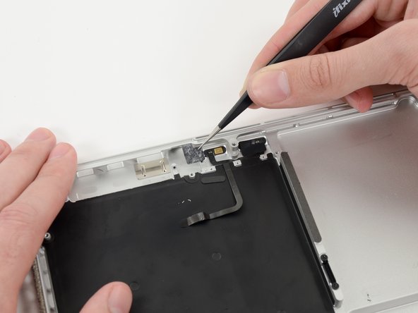

    • Use a pair of tweezers to lift the rubber hinge covers up off the right and left display hinges.
  54. MacBook Pro 13" Retina Display Late 2012 Upper Case Replacement: crwdns2935265:054crwdnd2935265:01crwdnd2935265:02crwdne2935265:0 MacBook Pro 13" Retina Display Late 2012 Upper Case Replacement: crwdns2935265:054crwdnd2935265:02crwdnd2935265:02crwdne2935265:0

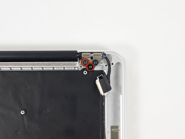

    • Remove the 3.2 mm T5 Torx screws (one on each side) securing the aluminum hinge brackets to the upper case.

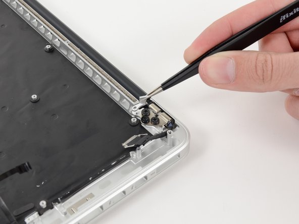

  55. MacBook Pro 13" Retina Display Late 2012 Upper Case Replacement: crwdns2935265:055crwdnd2935265:01crwdnd2935265:02crwdne2935265:0 MacBook Pro 13" Retina Display Late 2012 Upper Case Replacement: crwdns2935265:055crwdnd2935265:02crwdnd2935265:02crwdne2935265:0
    • Use a pair of tweezers to lift aluminum hinge brackets off the right and left display hinges.

  57. MacBook Pro 13" Retina Display Late 2012 Upper Case Replacement: crwdns2935265:057crwdnd2935265:01crwdnd2935265:02crwdne2935265:0 MacBook Pro 13" Retina Display Late 2012 Upper Case Replacement: crwdns2935265:057crwdnd2935265:02crwdnd2935265:02crwdne2935265:0
    • Open the MacBook Pro approximately 110 degrees, and place it sideways on the table, as shown.
    • While holding the display and upper case together with your left hand, remove the remaining T8 Torx screw from the lower display bracket.
    • Be sure to hold the display and upper case together with your left hand. Failure to do so may cause the freed display/upper case to fall, potentially damaging each component.
    • Remove the last remaining T8 Torx screw securing the display to the upper case.
  58. MacBook Pro 13" Retina Display Late 2012 Upper Case Replacement: crwdns2935265:058crwdnd2935265:01crwdnd2935265:03crwdne2935265:0 MacBook Pro 13" Retina Display Late 2012 Upper Case Replacement: crwdns2935265:058crwdnd2935265:02crwdnd2935265:03crwdne2935265:0 MacBook Pro 13" Retina Display Late 2012 Upper Case Replacement: crwdns2935265:058crwdnd2935265:03crwdnd2935265:03crwdne2935265:0
    • Grip both halves of the device, one in each hand.
    • Gently push forward on the bottom half of the device to detach it from the display assembly.
    • Carefully set each component aside, making sure to set down the lower half keyboard-side down.

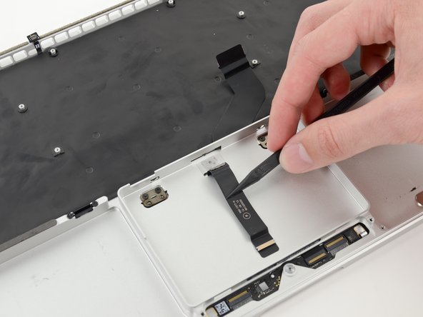

  60. MacBook Pro 13" Retina Display Late 2012 Upper Case Replacement: crwdns2935265:060crwdnd2935265:01crwdnd2935265:02crwdne2935265:0 MacBook Pro 13" Retina Display Late 2012 Upper Case Replacement: crwdns2935265:060crwdnd2935265:02crwdnd2935265:02crwdne2935265:0
    • Wedge the spudger between the trackpad ribbon cable and the upper case.
    • Run the spudger along the bottom to release the trackpad ribbon cable from the adhesive securing it to the upper case.
  61. MacBook Pro 13" Retina Display Late 2012 Upper Case Replacement: crwdns2935265:061crwdnd2935265:01crwdnd2935265:02crwdne2935265:0 MacBook Pro 13" Retina Display Late 2012 Upper Case Replacement: crwdns2935265:061crwdnd2935265:02crwdnd2935265:02crwdne2935265:0
    • Insert the tip of a spudger in between the trackpad ribbon cable and the upper case.
    • Carefully thread the trackpad ribbon cable out of the notch near the top of the SSD assembly cavity.
  62. MacBook Pro 13" Retina Display Late 2012 Upper Case Replacement: crwdns2935265:062crwdnd2935265:01crwdnd2935265:02crwdne2935265:0 MacBook Pro 13" Retina Display Late 2012 Upper Case Replacement: crwdns2935265:062crwdnd2935265:02crwdnd2935265:02crwdne2935265:0
    • Once the trackpad is free of the upper case, guide the trackpad ribbon cable through the slot cut in the upper case.
    • Remove the trackpad from the upper case.
