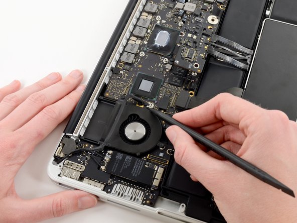

    1. MacBook Pro 13" Retina Display Late 2012 Logic Board Replacement, Logic Board Assembly: crwdns2935265:023crwdnd2935265:01crwdnd2935265:03crwdne2935265:0 MacBook Pro 13" Retina Display Late 2012 Logic Board Replacement, Logic Board Assembly: crwdns2935265:023crwdnd2935265:02crwdnd2935265:03crwdne2935265:0 MacBook Pro 13" Retina Display Late 2012 Logic Board Replacement, Logic Board Assembly: crwdns2935265:023crwdnd2935265:03crwdnd2935265:03crwdne2935265:0
      • Use the tip of a spudger to push the edges of the I/O board connector straight out of its socket on the logic board.
      • It is recommended to carefully push on both sides of the connector to "walk" it out of its socket.

      • Wedge the flat end of a spudger underneath the keyboard backlight connector and the logic board.
      • Gently twist the flat end of a spudger upwards to pry the keyboard backlight connector up off its socket on the logic board.
