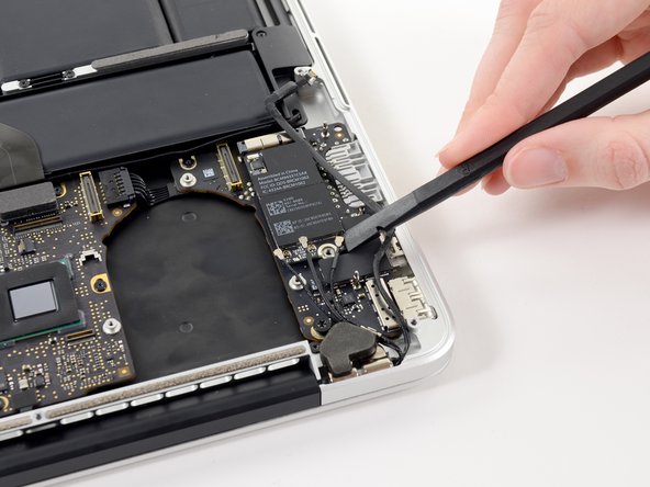

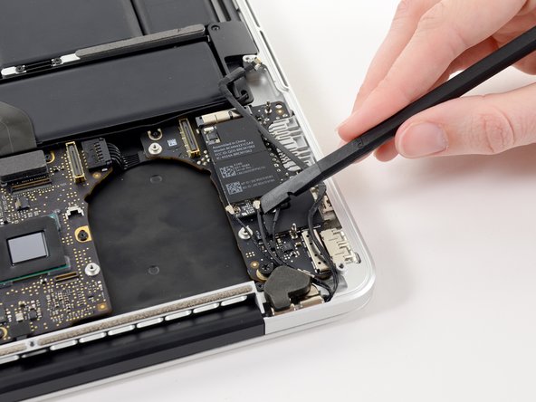

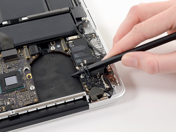

  18. MacBook Pro 13" Retina Display Late 2012 I/O Board Replacement, AirPort Board Assembly: crwdns2935265:018crwdnd2935265:01crwdnd2935265:01crwdne2935265:0
    • Remove the single 2.7 mm T5 Torx screw securing the AirPort board to the I/O board.
  19. MacBook Pro 13" Retina Display Late 2012 I/O Board Replacement: crwdns2935265:019crwdnd2935265:01crwdnd2935265:03crwdne2935265:0 MacBook Pro 13" Retina Display Late 2012 I/O Board Replacement: crwdns2935265:019crwdnd2935265:02crwdnd2935265:03crwdne2935265:0 MacBook Pro 13" Retina Display Late 2012 I/O Board Replacement: crwdns2935265:019crwdnd2935265:03crwdnd2935265:03crwdne2935265:0
    • Use the flat end of a spudger to pry and disconnect the three antenna cable connectors from the AirPort board.
    • The three cables are coded with black sleeves of different lengths. During reassembly:
    • Connect the long-sleeved cable to the center socket.
    • The short-sleeved cable connects next to the screw.
    • The remaining cable has no sleeve, and connects in the last empty socket, next to the fan.

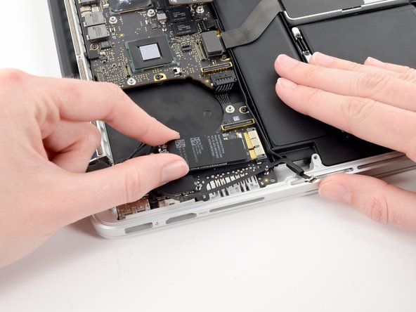

  21. MacBook Pro 13" Retina Display Late 2012 I/O Board Replacement: crwdns2935265:021crwdnd2935265:01crwdnd2935265:02crwdne2935265:0 MacBook Pro 13" Retina Display Late 2012 I/O Board Replacement: crwdns2935265:021crwdnd2935265:02crwdnd2935265:02crwdne2935265:0
    • Pull the AirPort board straight out of its socket on the I/O board.

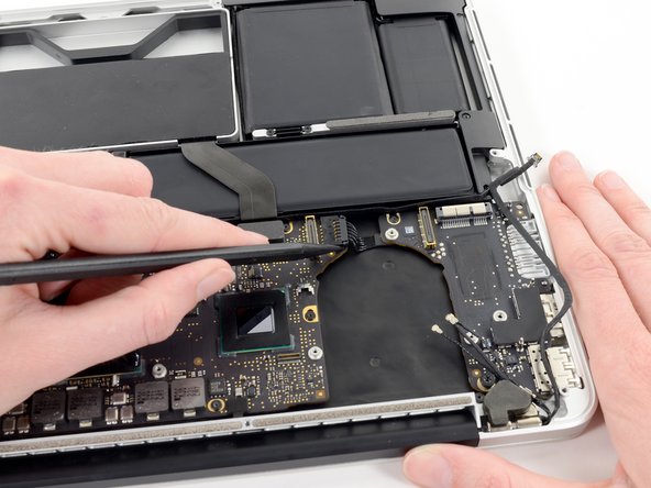

  22. MacBook Pro 13" Retina Display Late 2012 I/O Board Replacement, I/O Board: crwdns2935265:022crwdnd2935265:01crwdnd2935265:02crwdne2935265:0 MacBook Pro 13" Retina Display Late 2012 I/O Board Replacement, I/O Board: crwdns2935265:022crwdnd2935265:02crwdnd2935265:02crwdne2935265:0
    • Use the tip of a spudger to push the edges of the I/O board power connector straight out of its socket on the logic board.
    • It is recommended to carefully push on both sides of the connector to "walk" it out of its socket.
  23. MacBook Pro 13" Retina Display Late 2012 I/O Board Replacement: crwdns2935265:023crwdnd2935265:01crwdnd2935265:01crwdne2935265:0
    • Pull the I/O board connector straight out of its socket on the logic board.
  24. MacBook Pro 13" Retina Display Late 2012 I/O Board Replacement: crwdns2935265:024crwdnd2935265:01crwdnd2935265:01crwdne2935265:0

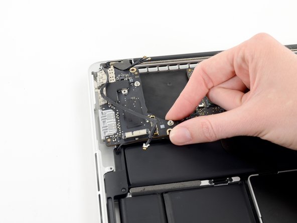

    • Remove the following two screws securing the I/O board to the upper case:
    • One 3.5 mm T5 Torx screw
    • One 4.9 mm T8 Torx screw
  25. MacBook Pro 13" Retina Display Late 2012 I/O Board Replacement: crwdns2935265:025crwdnd2935265:01crwdnd2935265:02crwdne2935265:0 MacBook Pro 13" Retina Display Late 2012 I/O Board Replacement: crwdns2935265:025crwdnd2935265:02crwdnd2935265:02crwdne2935265:0
    • Carefully pull and remove the I/O board away from its recess in the upper case.
