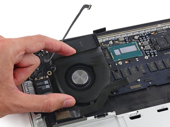

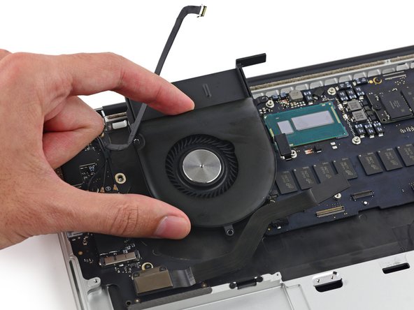

    9. MacBook Pro 13" Retina Display Early 2015 Upper Case Replacement: crwdns2935265:058crwdnd2935265:01crwdnd2935265:03crwdne2935265:0 MacBook Pro 13" Retina Display Early 2015 Upper Case Replacement: crwdns2935265:058crwdnd2935265:02crwdnd2935265:03crwdne2935265:0 MacBook Pro 13" Retina Display Early 2015 Upper Case Replacement: crwdns2935265:058crwdnd2935265:03crwdnd2935265:03crwdne2935265:0
      • Lift the end of the fan from the heat sink cavity and pull it up and out toward the hinge of the laptop to remove it.
