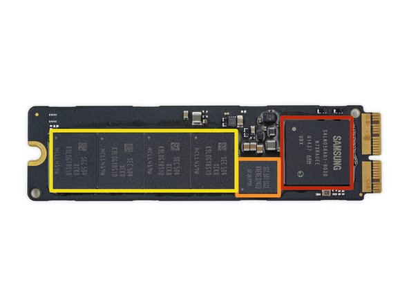

    • This looks familiar... The all-new and twice-as-fast flash memory has the exact same ICs as the one found in our recent teardown of the MacBook Air 13":
    • Samsung S4LN058A01 PCIe 3.0 x4 AHCI flash controller
    • Samsung K4E4E324ED 512 MB LPDDR3 DRAM
    • 8 x Samsung K9LDGY8S1D-XCK0 16 GB flash storage (128 GB total)
    • Just like its MacBook Air brother, this SSD benchmarks at significantly faster speeds than the previous generation.

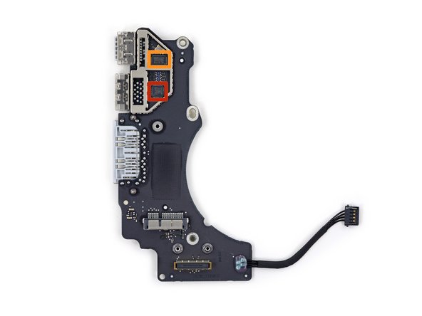

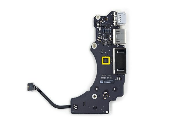

    • The I/O board looks unchanged, but what about the onboard chips? Looks like some of them have swapped sides:
    • Parade Technology PS8401A HDMI Jitter Cleaning Repeater
    • Genesys Logic GL3219 SDXC Card Reader Controller
    • NXP Semiconductors PCA9501 8-bit I/O Expander with an On-Board 2-kbit EEPROM
