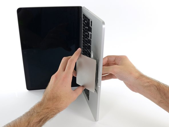

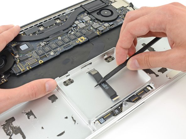

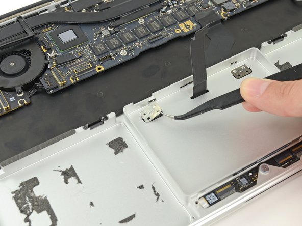

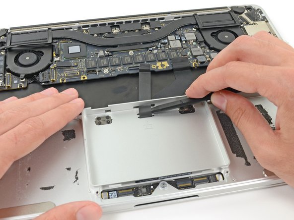

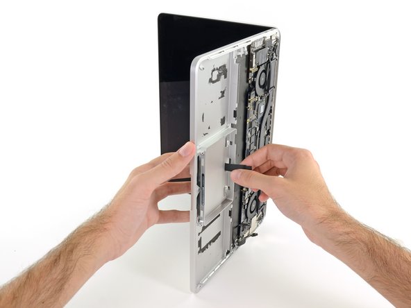

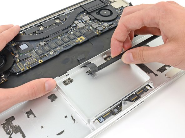

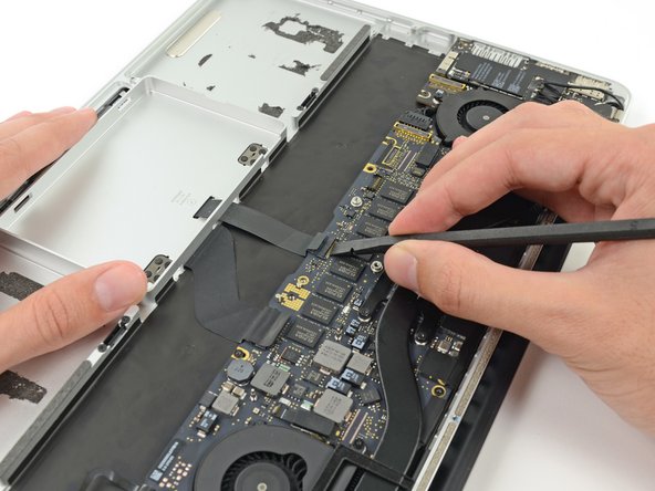

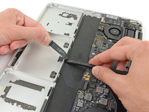

  35. MacBook Pro 13" Retina Display Early 2013 Trackpad Replacement, Trackpad: crwdns2935265:035crwdnd2935265:01crwdnd2935265:02crwdne2935265:0 MacBook Pro 13" Retina Display Early 2013 Trackpad Replacement, Trackpad: crwdns2935265:035crwdnd2935265:02crwdnd2935265:02crwdne2935265:0
    • Use the flat end of a spudger to flip up the retaining flap on the trackpad ribbon cable ZIF socket.
  36. MacBook Pro 13" Retina Display Early 2013 Trackpad Replacement: crwdns2935265:036crwdnd2935265:01crwdnd2935265:02crwdne2935265:0 MacBook Pro 13" Retina Display Early 2013 Trackpad Replacement: crwdns2935265:036crwdnd2935265:02crwdnd2935265:02crwdne2935265:0
    • Grasp the plastic pull tab and pull the trackpad ribbon cable out of its socket.
  37. MacBook Pro 13" Retina Display Early 2013 Trackpad Replacement: crwdns2935265:037crwdnd2935265:01crwdnd2935265:02crwdne2935265:0 MacBook Pro 13" Retina Display Early 2013 Trackpad Replacement: crwdns2935265:037crwdnd2935265:02crwdnd2935265:02crwdne2935265:0
    • Wedge the spudger between the trackpad ribbon cable and the upper case.
    • Run the spudger along the bottom to release the trackpad ribbon cable from the adhesive securing it to the upper case.
  38. MacBook Pro 13" Retina Display Early 2013 Trackpad Replacement: crwdns2935265:038crwdnd2935265:01crwdnd2935265:02crwdne2935265:0 MacBook Pro 13" Retina Display Early 2013 Trackpad Replacement: crwdns2935265:038crwdnd2935265:02crwdnd2935265:02crwdne2935265:0
    • Insert the tip of a spudger in between the trackpad ribbon cable and the upper case inside the SSD assembly cavity to remove the last of the adhesive.
  39. MacBook Pro 13" Retina Display Early 2013 Trackpad Replacement: crwdns2935265:039crwdnd2935265:01crwdnd2935265:03crwdne2935265:0 MacBook Pro 13" Retina Display Early 2013 Trackpad Replacement: crwdns2935265:039crwdnd2935265:02crwdnd2935265:03crwdne2935265:0 MacBook Pro 13" Retina Display Early 2013 Trackpad Replacement: crwdns2935265:039crwdnd2935265:03crwdnd2935265:03crwdne2935265:0
    • Using the tip of the spudger carefully thread the trackpad ribbon cable out of the notch near the top of the SSD assembly cavity.

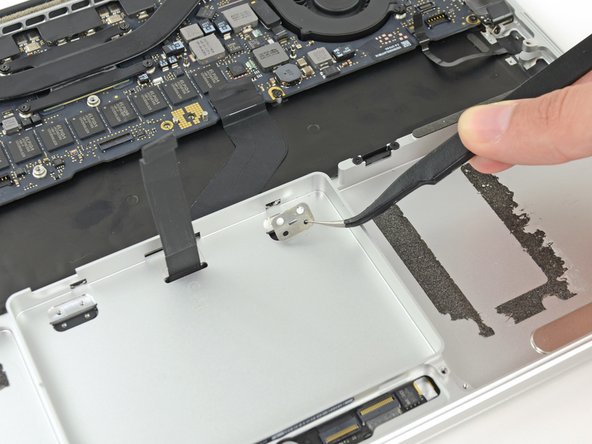

    • Remove the following screws securing the trackpad brackets to the trackpad and upper case:
    • Four 1.9 mm Phillips #000 screws
    • Four 1.4 mm Phillips #000 screws
  41. MacBook Pro 13" Retina Display Early 2013 Trackpad Replacement: crwdns2935265:041crwdnd2935265:01crwdnd2935265:03crwdne2935265:0 MacBook Pro 13" Retina Display Early 2013 Trackpad Replacement: crwdns2935265:041crwdnd2935265:02crwdnd2935265:03crwdne2935265:0 MacBook Pro 13" Retina Display Early 2013 Trackpad Replacement: crwdns2935265:041crwdnd2935265:03crwdnd2935265:03crwdne2935265:0
    • Use tweezers to remove the two trackpad mounting brackets from the upper case.
  42. MacBook Pro 13" Retina Display Early 2013 Trackpad Replacement: crwdns2935265:042crwdnd2935265:01crwdnd2935265:02crwdne2935265:0 MacBook Pro 13" Retina Display Early 2013 Trackpad Replacement: crwdns2935265:042crwdnd2935265:02crwdnd2935265:02crwdne2935265:0

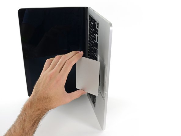

    • To avoid scratching the display, open the computer about 90º and set it on end.
    • Guide the trackpad ribbon cable through the slot cut in the upper case. This will push the trackpad up out of its recess in the top of the upper case. Guide the trackpad out with your other hand, so it doesn't fall.
  43. MacBook Pro 13" Retina Display Early 2013 Trackpad Replacement: crwdns2935265:043crwdnd2935265:01crwdnd2935265:03crwdne2935265:0 MacBook Pro 13" Retina Display Early 2013 Trackpad Replacement: crwdns2935265:043crwdnd2935265:02crwdnd2935265:03crwdne2935265:0 MacBook Pro 13" Retina Display Early 2013 Trackpad Replacement: crwdns2935265:043crwdnd2935265:03crwdnd2935265:03crwdne2935265:0
    • Gently pull the trackpad from the upper case, being careful not to snag the ribbon cable.
