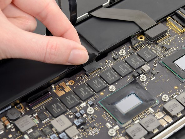

  4. MacBook Pro 13" Retina Display Early 2013 MagSafe DC-In Board Replacement, Battery Connector: crwdns2935265:04crwdnd2935265:01crwdnd2935265:01crwdne2935265:0
    • Remove the plastic cover adhered to the battery contact board.

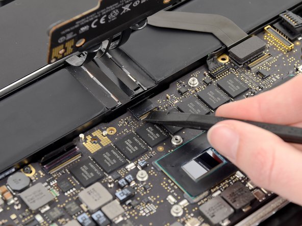

  5. MacBook Pro 13" Retina Display Early 2013 MagSafe DC-In Board Replacement: crwdns2935265:05crwdnd2935265:01crwdnd2935265:01crwdne2935265:0
    • Remove the following screws securing the battery connector board to the logic board:
    • Two 2.8 mm T6 Torx screws
    • One 7.0 mm T6 Torx shouldered screw
  6. MacBook Pro 13" Retina Display Early 2013 MagSafe DC-In Board Replacement: crwdns2935265:06crwdnd2935265:01crwdnd2935265:02crwdne2935265:0 MacBook Pro 13" Retina Display Early 2013 MagSafe DC-In Board Replacement: crwdns2935265:06crwdnd2935265:02crwdnd2935265:02crwdne2935265:0
    • Use tweezers to remove the small plastic cover located near the bottom right of the battery connector board.
  7. MacBook Pro 13" Retina Display Early 2013 MagSafe DC-In Board Replacement: crwdns2935265:07crwdnd2935265:01crwdnd2935265:01crwdne2935265:0
    • Remove the wide head 6.4 mm T6 Torx screw securing the battery connector to the logic board assembly.
  8. MacBook Pro 13" Retina Display Early 2013 MagSafe DC-In Board Replacement: crwdns2935265:08crwdnd2935265:01crwdnd2935265:02crwdne2935265:0 MacBook Pro 13" Retina Display Early 2013 MagSafe DC-In Board Replacement: crwdns2935265:08crwdnd2935265:02crwdnd2935265:02crwdne2935265:0
    • Carefully lift the battery connector board up off the logic board.
    • It is recommended to bend the battery cables just slightly, to keep the board suspended up above the logic board and out of the way.
    • Do not fold the board completely over, or crease the cables, as this may damage the battery.

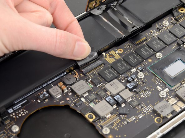

  9. MacBook Pro 13" Retina Display Early 2013 MagSafe DC-In Board Replacement, Battery Contact Board: crwdns2935265:09crwdnd2935265:01crwdnd2935265:02crwdne2935265:0 MacBook Pro 13" Retina Display Early 2013 MagSafe DC-In Board Replacement, Battery Contact Board: crwdns2935265:09crwdnd2935265:02crwdnd2935265:02crwdne2935265:0
    • Grasp the Interposer with tweezers.
    • An interposer is the name for an interface that links one electrical connection to another. In this repair, it is the board connecting the battery to logic board.
    • Lift the Interposer off the logic board and remove it.
    • Removing this board will ensure that the battery remains disconnected throughout your repair, preventing your computer from accidentally powering on. It's also a good idea to take it out so it doesn't fall out unexpectedly.

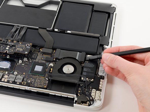

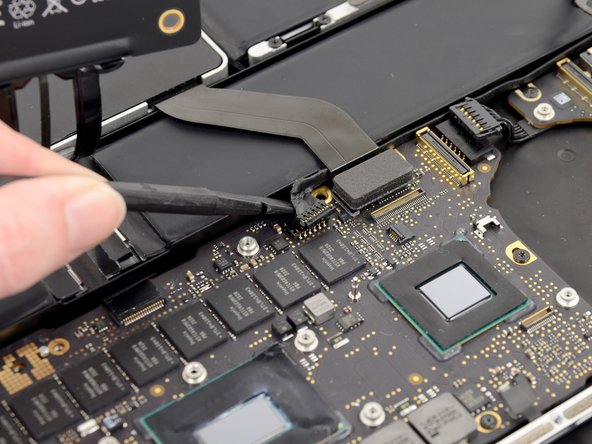

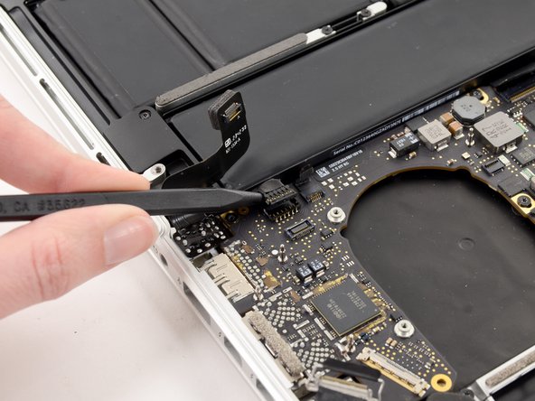

  12. MacBook Pro 13" Retina Display Early 2013 MagSafe DC-In Board Replacement, I/O Board Data Cable: crwdns2935265:012crwdnd2935265:01crwdnd2935265:02crwdne2935265:0 MacBook Pro 13" Retina Display Early 2013 MagSafe DC-In Board Replacement, I/O Board Data Cable: crwdns2935265:012crwdnd2935265:02crwdnd2935265:02crwdne2935265:0
    • Use the flat end of a spudger to pry the right side of the I/O board data cable connector up off its socket on the I/O board.
    • When prying the I/O board data cable connector from its socket, make sure to pry the connector itself and not the socket. Prying the socket may cause irreversible damage to the I/O board.
  13. MacBook Pro 13" Retina Display Early 2013 MagSafe DC-In Board Replacement: crwdns2935265:013crwdnd2935265:01crwdnd2935265:02crwdne2935265:0 MacBook Pro 13" Retina Display Early 2013 MagSafe DC-In Board Replacement: crwdns2935265:013crwdnd2935265:02crwdnd2935265:02crwdne2935265:0
    • Wedge the flat end of a spudger beneath the left side of the I/O board data cable connector.
    • Gently twist the spudger to disconnect the I/O board data cable connector from its socket on the logic board.
  14. MacBook Pro 13" Retina Display Early 2013 MagSafe DC-In Board Replacement: crwdns2935265:014crwdnd2935265:01crwdnd2935265:01crwdne2935265:0
    • Lift and remove the I/O board data cable from the MacBook Pro.

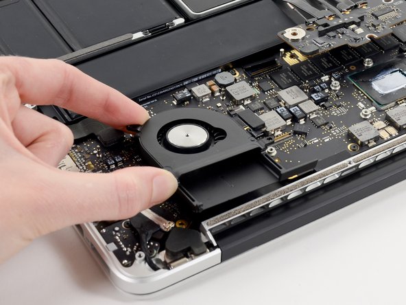

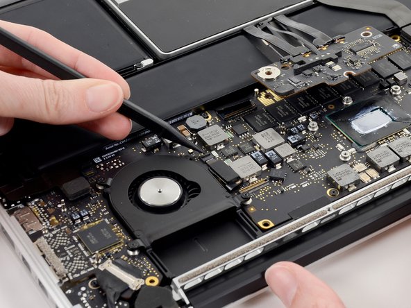

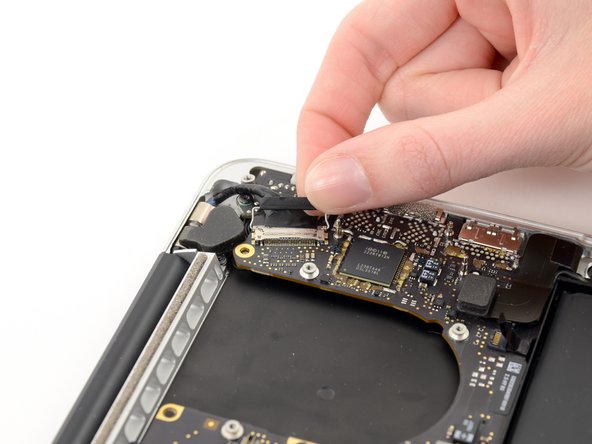

  15. MacBook Pro 13" Retina Display Early 2013 MagSafe DC-In Board Replacement, Right Fan: crwdns2935265:015crwdnd2935265:01crwdnd2935265:03crwdne2935265:0 MacBook Pro 13" Retina Display Early 2013 MagSafe DC-In Board Replacement, Right Fan: crwdns2935265:015crwdnd2935265:02crwdnd2935265:03crwdne2935265:0 MacBook Pro 13" Retina Display Early 2013 MagSafe DC-In Board Replacement, Right Fan: crwdns2935265:015crwdnd2935265:03crwdnd2935265:03crwdne2935265:0
    • Use the tip of a spudger to flip up the retaining flap on the right fan ribbon cable ZIF socket.
    • Pull the right fan ribbon cable straight out of its socket on the logic board.
  16. MacBook Pro 13" Retina Display Early 2013 MagSafe DC-In Board Replacement: crwdns2935265:016crwdnd2935265:01crwdnd2935265:01crwdne2935265:0
    • Remove the three 3.1 mm T5 Torx screws securing the right fan to the logic board assembly.
  17. MacBook Pro 13" Retina Display Early 2013 MagSafe DC-In Board Replacement: crwdns2935265:017crwdnd2935265:01crwdnd2935265:01crwdne2935265:0
    • Lift and remove the right fan out of the upper case.

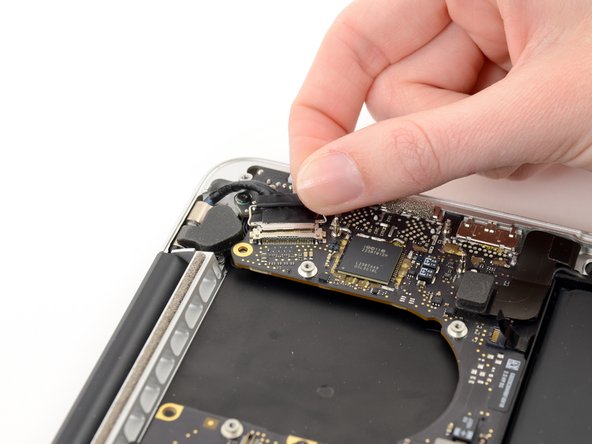

  23. MacBook Pro 13" Retina Display Early 2013 MagSafe DC-In Board Replacement: crwdns2935265:023crwdnd2935265:01crwdnd2935265:03crwdne2935265:0 MacBook Pro 13" Retina Display Early 2013 MagSafe DC-In Board Replacement: crwdns2935265:023crwdnd2935265:02crwdnd2935265:03crwdne2935265:0 MacBook Pro 13" Retina Display Early 2013 MagSafe DC-In Board Replacement: crwdns2935265:023crwdnd2935265:03crwdnd2935265:03crwdne2935265:0
    • Grab the black pull tab secured to the display data cable lock and rotate it toward the DC-In side of the computer.
    • Pull the display data cable straight out of its socket on the logic board.
    • Do not lift up on the display data cable, as its socket is very fragile. Pull the cable parallel to the face of the logic board.

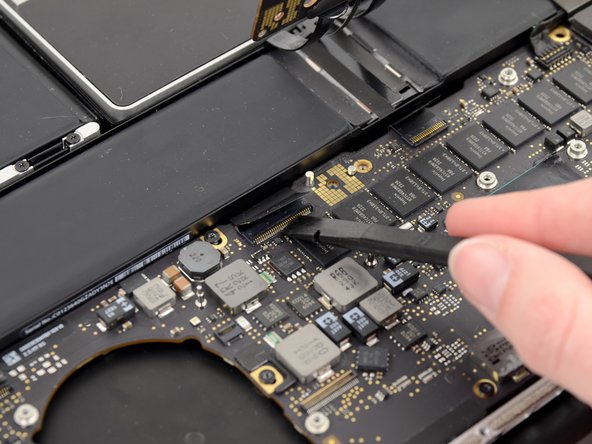

    • Use the flat end of a spudger to pry the SSD cable connector up off its socket on the logic board.
  30. MacBook Pro 13" Retina Display Early 2013 MagSafe DC-In Board Replacement: crwdns2935265:030crwdnd2935265:01crwdnd2935265:02crwdne2935265:0 MacBook Pro 13" Retina Display Early 2013 MagSafe DC-In Board Replacement: crwdns2935265:030crwdnd2935265:02crwdnd2935265:02crwdne2935265:0

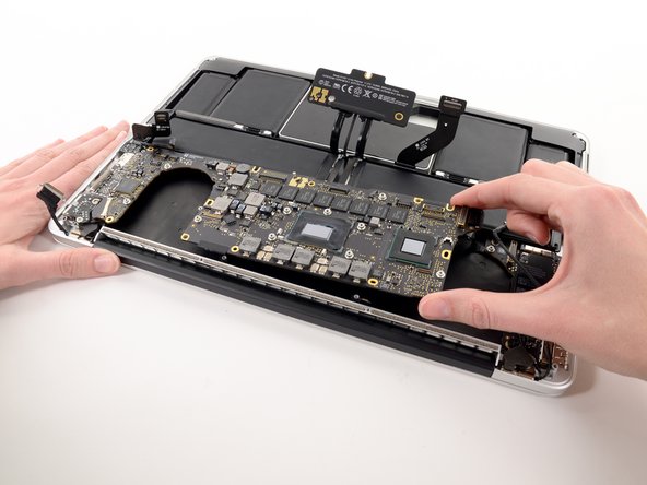

  31. MacBook Pro 13" Retina Display Early 2013 MagSafe DC-In Board Replacement: crwdns2935265:031crwdnd2935265:01crwdnd2935265:01crwdne2935265:0
    • Remove the nine 3.3 mm T5 Torx screws securing the logic board and MagSafe DC-in board to the upper case.
  32. MacBook Pro 13" Retina Display Early 2013 MagSafe DC-In Board Replacement: crwdns2935265:032crwdnd2935265:01crwdnd2935265:02crwdne2935265:0 MacBook Pro 13" Retina Display Early 2013 MagSafe DC-In Board Replacement: crwdns2935265:032crwdnd2935265:02crwdnd2935265:02crwdne2935265:0

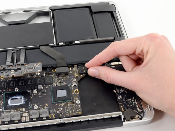

    • Carefully grasp the corner of the logic board (opposite of the I/O ports) and lift the logic board out of the upper case.

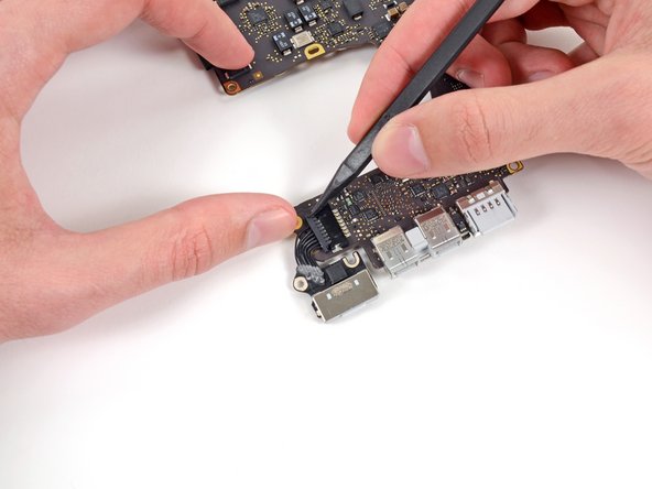

  33. MacBook Pro 13" Retina Display Early 2013 MagSafe DC-In Board Replacement, MagSafe DC-In Board: crwdns2935265:033crwdnd2935265:01crwdnd2935265:02crwdne2935265:0 MacBook Pro 13" Retina Display Early 2013 MagSafe DC-In Board Replacement, MagSafe DC-In Board: crwdns2935265:033crwdnd2935265:02crwdnd2935265:02crwdne2935265:0
    • Gently push the edges of the MagSafe cable connector away from its socket on the logic board.
    • It is recommended "walk" the connector out of its socket. Simply push the top and bottom corners of the connector and carefully "walk it out" of its socket.
  34. MacBook Pro 13" Retina Display Early 2013 MagSafe DC-In Board Replacement: crwdns2935265:034crwdnd2935265:01crwdnd2935265:01crwdne2935265:0
    • Pull the MagSafe cable connector straight out of its socket on the logic board.
