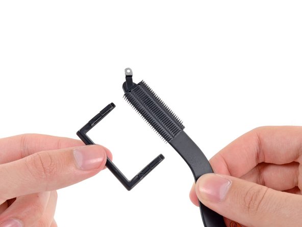

  12. MacBook Pro 13" Retina Display Early 2013 Left Fan Duct Replacement, Left Fan Duct: crwdns2935265:012crwdnd2935265:01crwdnd2935265:02crwdne2935265:0 MacBook Pro 13" Retina Display Early 2013 Left Fan Duct Replacement, Left Fan Duct: crwdns2935265:012crwdnd2935265:02crwdnd2935265:02crwdne2935265:0
    • Carefully remove the left fan duct from the edge of the heat sink.
