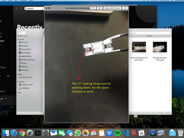

  7. MacBook Pro 13" Late 2016 Function Keys Spacebar Replacement, Middle Peg, be careful its facing the correct way.: crwdns2935265:07crwdnd2935265:01crwdnd2935265:02crwdne2935265:0 MacBook Pro 13" Late 2016 Function Keys Spacebar Replacement, Middle Peg, be careful its facing the correct way.: crwdns2935265:07crwdnd2935265:02crwdnd2935265:02crwdne2935265:0
    • Make sure that the middle-peg is in the correct direction, at the back is a "U" like symbol, it needs to be facing down.
    • Now when placing in the middle-clip, only apply small dots of glue in each corner and do-not spread it.
    • Then place on-top, the middle-clip, make sure its facing the right way.
