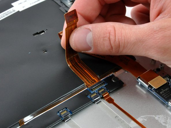

    • Use a spudger to pry the AirPort/Bluetooth and trackpad control cable connectors up off the logic board.

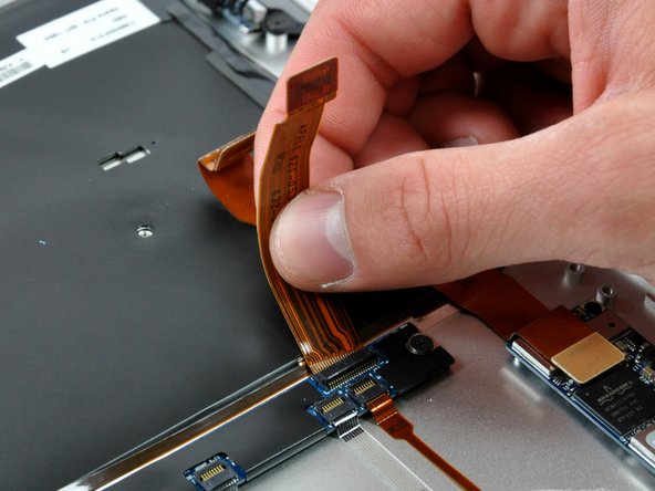

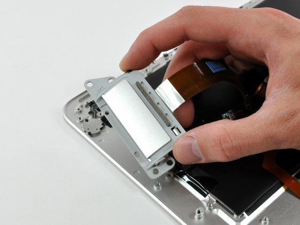

    • Use the pointed end of a spudger to flip up the retaining flap on the trackpad control cable socket.
    • Peel the trackpad control cable off the adhesive securing it to the upper case.
    • Pull the trackpad control cable out of its socket.

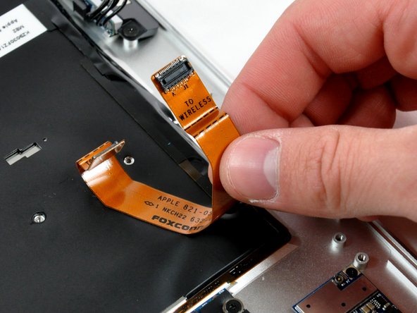

    • Use a spudger to pry the AirPort/Bluetooth cable connector up off the AirPort/Bluetooth board.
    • Peel the AirPort/Bluetooth cable off the adhesive securing it to the upper case.
