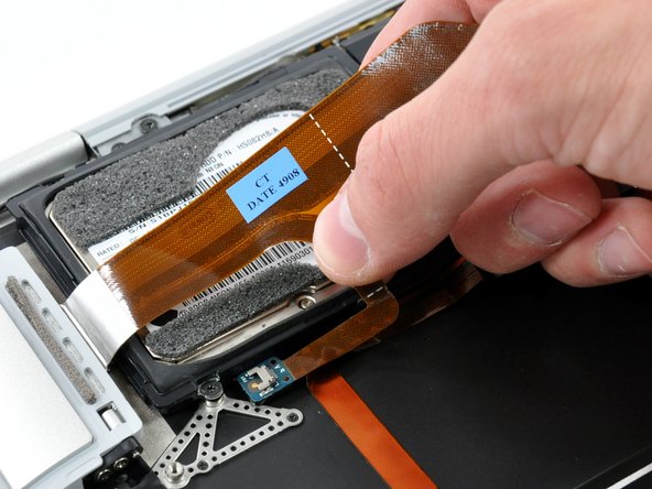

  9. MacBook Air Models A1237 and A1304 Port Hatch Assembly Replacement, Port Hatch Assembly: crwdns2935265:09crwdnd2935265:01crwdnd2935265:02crwdne2935265:0 MacBook Air Models A1237 and A1304 Port Hatch Assembly Replacement, Port Hatch Assembly: crwdns2935265:09crwdnd2935265:02crwdnd2935265:02crwdne2935265:0
    • Disconnect the port hatch ribbon cable from the logic board by pulling it straight up by its black pull tab.
    • If necessary, pull the audio out ribbon cable off the adhesive securing it to the upper case.

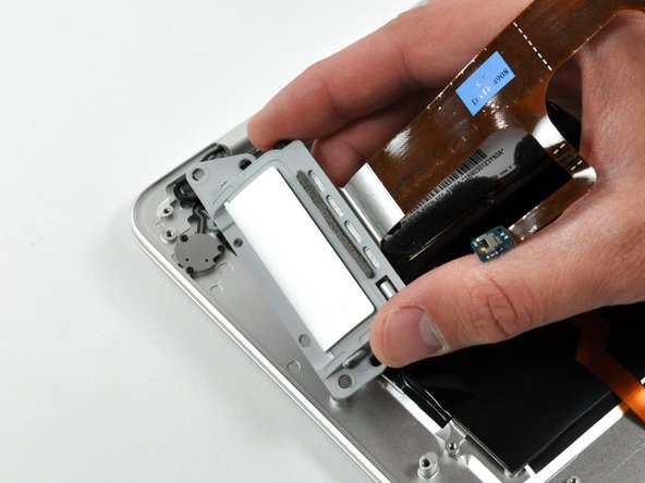

  10. MacBook Air Models A1237 and A1304 Port Hatch Assembly Replacement: crwdns2935265:010crwdnd2935265:01crwdnd2935265:02crwdne2935265:0 MacBook Air Models A1237 and A1304 Port Hatch Assembly Replacement: crwdns2935265:010crwdnd2935265:02crwdnd2935265:02crwdne2935265:0
    • Remove the four 3.2 mm Phillips screws securing the port hatch assembly to the upper case.
    • Lift the port hatch assembly out of the upper case.
