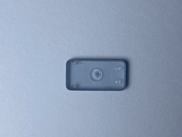

  4. MacBook Air 13" Retina Display 2020 Smaller Keys Replacement: crwdns2935265:04crwdnd2935265:01crwdnd2935265:01crwdne2935265:0
    • This piece, the rubber cap, doesn't come off often. But if it does, you can reinstall it by pressing down on the middle.
