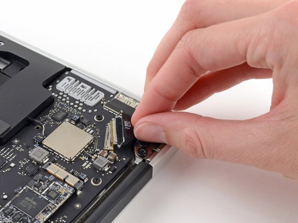

  20. MacBook Air 13" Mid 2013 Display Assembly Replacement: crwdns2935265:020crwdnd2935265:01crwdnd2935265:02crwdne2935265:0 MacBook Air 13" Mid 2013 Display Assembly Replacement: crwdns2935265:020crwdnd2935265:02crwdnd2935265:02crwdne2935265:0
    • Pull the display data cable connector straight out of its socket.
    • Make sure to pull the connector parallel to the logic board, do not lift straight up from its socket.

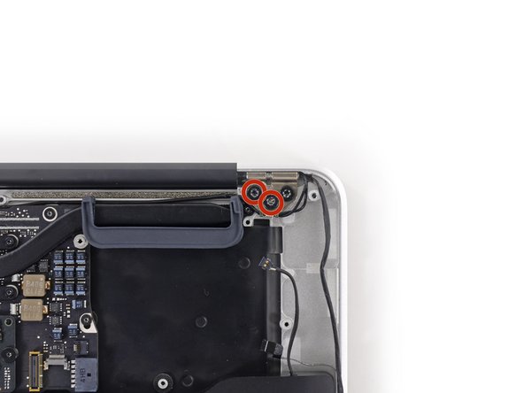

  21. MacBook Air 13" Mid 2013 Display Assembly Replacement: crwdns2935265:021crwdnd2935265:01crwdnd2935265:02crwdne2935265:0 MacBook Air 13" Mid 2013 Display Assembly Replacement: crwdns2935265:021crwdnd2935265:02crwdnd2935265:02crwdne2935265:0
    • Remove the inner four (two on each side) 4.9 mm T8 Torx screws securing the right and left display hinges to the upper case.
    • Leaving the outer screws in place for now will aid in disassembly.
