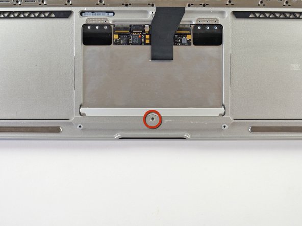

  10. MacBook Air 13" Mid 2012: loose or rattling trackpad repair: crwdns2935265:010crwdnd2935265:01crwdnd2935265:01crwdne2935265:0
    • Remove the 1.4 mm T5 Torx set screw from its tapped hole near the front edge of the upper case.
    • During reassembly, do not over-tighten the set screw, as the button will cease to click at a certain point. Adjust the set screw until the movable side of the trackpad has minimal play.

    • Reinstall trackpad by following step 8 in reverse order but only tighten the 6 screws at the trackpad (orange) firmly and leave the 6 screws of the case (red) slightly loose
    • Open the MacBook to nearly 90° so that it stands stable on its display case.
    • Check the feel of the click. Does it go back gently into rest position? Has it enough stroke?
    • If not, you might have chosen to rigid or to thick material (or both)
    • You may also try to readjust the central screw which is marked in step 10 and which you hopefully did not unscrew!

Hello, good tutorial. Today on my Macbook Air disarm the trackpad, since it was loose and it sounded when using it. The only solution and that was good for me, was to tighten the central screw, to the point that it remained firm and allowed the clicks.

Nice guide, my 5 year old machine had a loose trackpad that was making it difficult to register clicks and drags. All I had to do was step 10, not even remove the battery and the trackpad is as flush as new now 😊
Robert Dixon - crwdns2934203:0crwdne2934203:0
Thank you so much! The trackpad of my MacBook Air 11'' early 2015 was ratteling because I changed the battery. I really couldn´t find out the problem. Than I found this guide and as mentioned I just had to adjust the screw in step 10 a little bit and now it is working perfectly again.
