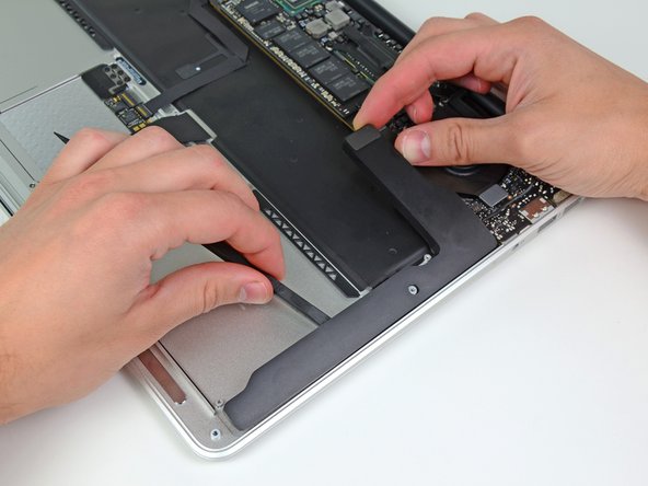

    1. MacBook Air 13" Mid 2012 Microphone Replacement, Left Speaker: crwdns2935265:06crwdnd2935265:01crwdnd2935265:01crwdne2935265:0
      • Use the flat end of a spudger to pry the left speaker cable connector up and out of its socket on the I/O board.
      • Pry up from beneath the wires.
    2. MacBook Air 13" Mid 2012 Microphone Replacement: crwdns2935265:07crwdnd2935265:01crwdnd2935265:01crwdne2935265:0
      • De-route the left speaker cable from its retaining clip on the I/O board.
    3. MacBook Air 13" Mid 2012 Microphone Replacement: crwdns2935265:08crwdnd2935265:01crwdnd2935265:03crwdne2935265:0 MacBook Air 13" Mid 2012 Microphone Replacement: crwdns2935265:08crwdnd2935265:02crwdnd2935265:03crwdne2935265:0 MacBook Air 13" Mid 2012 Microphone Replacement: crwdns2935265:08crwdnd2935265:03crwdnd2935265:03crwdne2935265:0
      • Use the flat end of a spudger to pry the left speaker off the adhesive securing it to the upper case.
      • Remove the left speaker from the upper case.

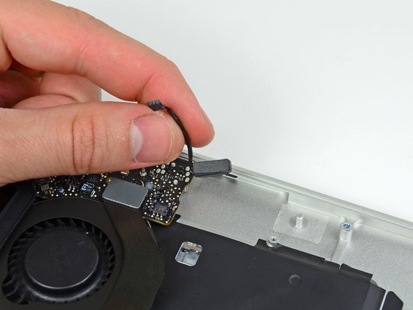

    1. MacBook Air 13" Mid 2012 Microphone Replacement, Microphone: crwdns2935265:09crwdnd2935265:01crwdnd2935265:01crwdne2935265:0
      • Use the edge of a spudger to pry the microphone connector up and out of its socket on the I/O board.
    2. MacBook Air 13" Mid 2012 Microphone Replacement: crwdns2935265:010crwdnd2935265:01crwdnd2935265:02crwdne2935265:0 MacBook Air 13" Mid 2012 Microphone Replacement: crwdns2935265:010crwdnd2935265:02crwdnd2935265:02crwdne2935265:0
      • Use the tip of a spudger to pry the microphone off the adhesive securing it to the left side of the upper case.
      • Remove the microphone from the upper case.

There is a not 2012 MBA entrails on the photos. Maybe a newer MBA (double mic).
Surgie - crwdns2934203:0crwdne2934203:0 crwdns2950251:0crwdne2950251:0
Agreed, that I/O board and the microphone connector are all wrong. Looks like they’ve reused a previous guide.
James Thorburn - crwdns2934203:0crwdne2934203:0 crwdns2950251:0crwdne2950251:0
