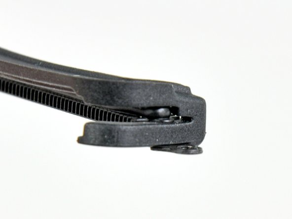

    P5 Pentalobe Screwdriver Retina MacBook Pro and Air
    $5.99
    • Before proceeding, power down your MacBook. Close the display and lay it on a soft surface, top-side down.
    • Use a P5 Pentalobe driver to remove ten screws securing the lower case, of the following lengths:

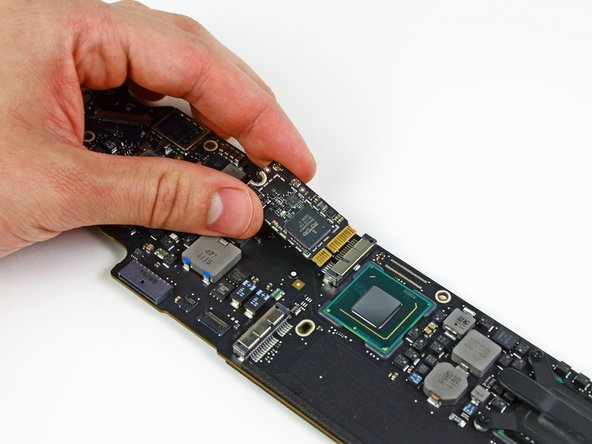

    • Remove the single 2.9 mm T5 Torx screw securing the AirPort/Bluetooth card to the logic board.
  32. MacBook Air 13" Mid 2012 Logic Board Replacement: crwdns2935265:032crwdnd2935265:01crwdnd2935265:02crwdne2935265:0 MacBook Air 13" Mid 2012 Logic Board Replacement: crwdns2935265:032crwdnd2935265:02crwdnd2935265:02crwdne2935265:0
    • Slightly lift the free end of the AirPort/Bluetooth board and pull it out of its socket on the logic board.
    • Remove the AirPort/Bluetooth board from the logic board.
