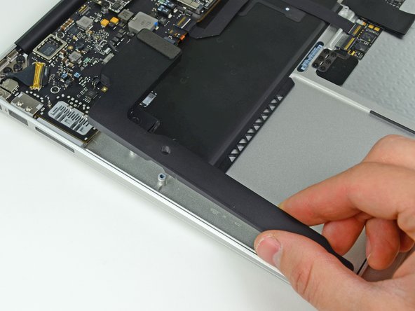

  6. MacBook Air 13" Mid 2011 Right Speaker Replacement, Right Speaker: crwdns2935265:06crwdnd2935265:01crwdnd2935265:01crwdne2935265:0
    • Use the flat end of a spudger to pry the right speaker connector up and out of its socket on the logic board.
    • Pry up from beneath the wires.

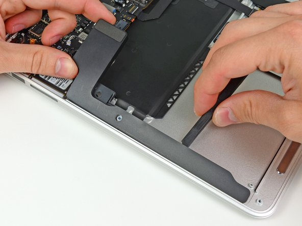

  7. MacBook Air 13" Mid 2011 Right Speaker Replacement: crwdns2935265:07crwdnd2935265:01crwdnd2935265:03crwdne2935265:0 MacBook Air 13" Mid 2011 Right Speaker Replacement: crwdns2935265:07crwdnd2935265:02crwdnd2935265:03crwdne2935265:0 MacBook Air 13" Mid 2011 Right Speaker Replacement: crwdns2935265:07crwdnd2935265:03crwdnd2935265:03crwdne2935265:0
    • Use the flat end of a spudger to pry the right speaker off the adhesive securing it to the upper case.
    • Remove the right speaker from the upper case.
