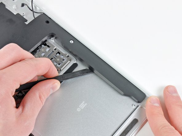

    • Remove the single 2.7 mm T5 Torx screw securing the right speaker to the upper case.
  36. MacBook Air 13" Late 2010 Upper Case Replacement: crwdns2935265:036crwdnd2935265:01crwdnd2935265:03crwdne2935265:0 MacBook Air 13" Late 2010 Upper Case Replacement: crwdns2935265:036crwdnd2935265:02crwdnd2935265:03crwdne2935265:0 MacBook Air 13" Late 2010 Upper Case Replacement: crwdns2935265:036crwdnd2935265:03crwdnd2935265:03crwdne2935265:0
    • Use the flat end of a spudger to pry the right speaker off the adhesive securing it to the upper case.
    • Remove the right speaker from the upper case.

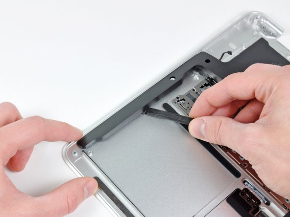

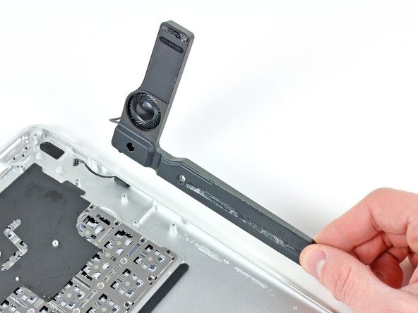

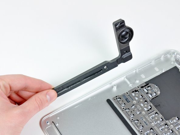

  37. MacBook Air 13" Late 2010 Upper Case Replacement: crwdns2935265:037crwdnd2935265:01crwdnd2935265:01crwdne2935265:0
    • Remove the single 2.7 mm T5 Torx screw securing the left speaker to the upper case.
  38. MacBook Air 13" Late 2010 Upper Case Replacement: crwdns2935265:038crwdnd2935265:01crwdnd2935265:03crwdne2935265:0 MacBook Air 13" Late 2010 Upper Case Replacement: crwdns2935265:038crwdnd2935265:02crwdnd2935265:03crwdne2935265:0 MacBook Air 13" Late 2010 Upper Case Replacement: crwdns2935265:038crwdnd2935265:03crwdnd2935265:03crwdne2935265:0
    • Use the flat end of a spudger to pry the left speaker off the adhesive securing it to the upper case.
    • Remove the left speaker from the upper case.

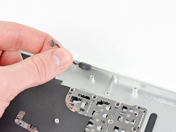

  39. MacBook Air 13" Late 2010 Upper Case Replacement: crwdns2935265:039crwdnd2935265:01crwdnd2935265:02crwdne2935265:0 MacBook Air 13" Late 2010 Upper Case Replacement: crwdns2935265:039crwdnd2935265:02crwdnd2935265:02crwdne2935265:0
    • Use the tip of a spudger to pry the microphone away from the left side of the upper case.
    • Remove the microphone from the upper case.

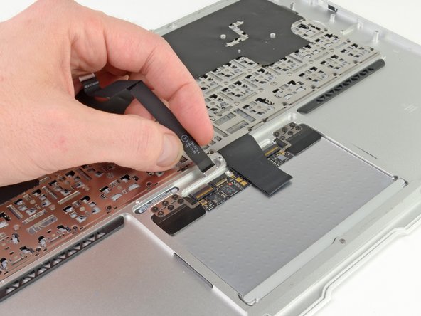

  40. MacBook Air 13" Late 2010 Upper Case Replacement: crwdns2935265:040crwdnd2935265:01crwdnd2935265:02crwdne2935265:0 MacBook Air 13" Late 2010 Upper Case Replacement: crwdns2935265:040crwdnd2935265:02crwdnd2935265:02crwdne2935265:0
    • Use the tip of a spudger or your fingernail to flip up the retaining flap on the trackpad ribbon cable ZIF socket.
    • Pull the trackpad ribbon cable straight out of its socket toward the rear edge of the Air.
  41. MacBook Air 13" Late 2010 Upper Case Replacement: crwdns2935265:041crwdnd2935265:01crwdnd2935265:03crwdne2935265:0 MacBook Air 13" Late 2010 Upper Case Replacement: crwdns2935265:041crwdnd2935265:02crwdnd2935265:03crwdne2935265:0 MacBook Air 13" Late 2010 Upper Case Replacement: crwdns2935265:041crwdnd2935265:03crwdnd2935265:03crwdne2935265:0
    • While carefully lifting the keyboard ribbon cable with one hand, use the tip of a spudger or your fingernail to flip up the retaining flap on the keyboard ribbon cable ZIF socket.
    • Pull the keyboard ribbon cable straight out of its socket toward the front edge of the Air.
