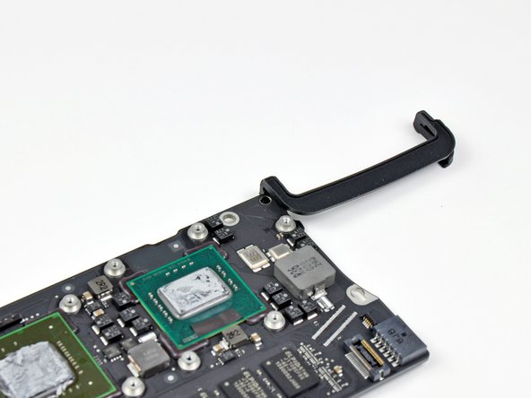

  34. MacBook Air 13" Late 2010 Logic Board Replacement: crwdns2935265:034crwdnd2935265:01crwdnd2935265:01crwdne2935265:0
    • Remove the rubber fan gasket from the logic board.
    • Logic board remains.
  35. MacBook Air 13" Late 2010 Logic Board Replacement: crwdns2935265:035crwdnd2935265:01crwdnd2935265:02crwdne2935265:0 MacBook Air 13" Late 2010 Logic Board Replacement: crwdns2935265:035crwdnd2935265:02crwdnd2935265:02crwdne2935265:0
    • These shots show how the rubber fan gasket should be installed during reassembly. Be sure not to install the gasket underneath the ear where the end of the heatsink is screwed down to the upper case.
    • Additionally, be sure the small post molded into the rubber gasket mates with the hole cut into the upper right corner of the logic board.
