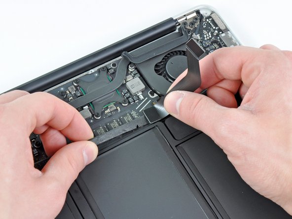

  4. MacBook Air 13" Late 2010 Display Assembly Replacement, I/O Board Cable: crwdns2935265:04crwdnd2935265:01crwdnd2935265:01crwdne2935265:0
    • Use the flat end of a spudger to pry the I/O board cable connector upward out of its socket on the I/O board.
  5. MacBook Air 13" Late 2010 Display Assembly Replacement: crwdns2935265:05crwdnd2935265:01crwdnd2935265:02crwdne2935265:0 MacBook Air 13" Late 2010 Display Assembly Replacement: crwdns2935265:05crwdnd2935265:02crwdnd2935265:02crwdne2935265:0
    • The following connector has an especially deep socket. Use care when disconnecting it.
    • Carefully peel the I/O board cable from the top of the fan.
    • While gently pulling the I/O board cable upward near its connection to the logic board, use the tip of a spudger to pry upward on alternating sides of the connector to help "walk" it out of its socket.
    • Remove the I/O board cable.

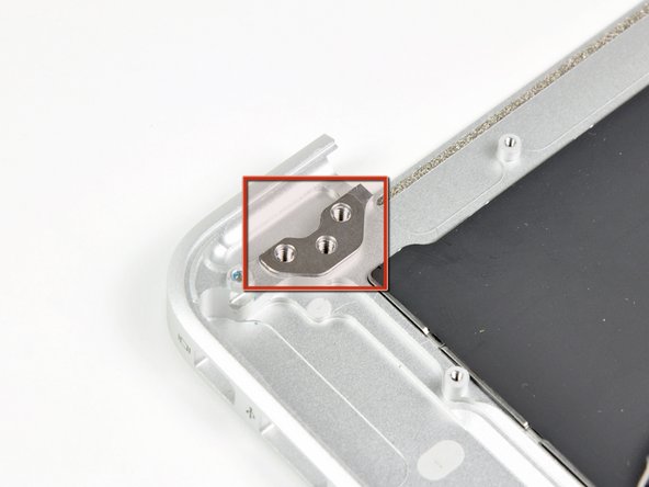

  32. MacBook Air 13" Late 2010 Display Assembly Replacement: crwdns2935265:032crwdnd2935265:01crwdnd2935265:01crwdne2935265:0
    • Open the display until it is perpendicular to the upper case and place it on a table as shown.
    • While holding the Air steady, remove the remaining 4.9 mm T8 Torx screw from the lower display bracket.
  33. MacBook Air 13" Late 2010 Display Assembly Replacement: crwdns2935265:033crwdnd2935265:01crwdnd2935265:01crwdne2935265:0
    • Before removing the last display screw, be sure to hold the display and upper case steady with your other hand. Failure to do so may allow the components to fall onto the table, causing potentially expensive damage.
    • Remove the last 4.9 mm T8 Torx screw securing the display to the upper case.
  34. MacBook Air 13" Late 2010 Display Assembly Replacement: crwdns2935265:034crwdnd2935265:01crwdnd2935265:02crwdne2935265:0 MacBook Air 13" Late 2010 Display Assembly Replacement: crwdns2935265:034crwdnd2935265:02crwdnd2935265:02crwdne2935265:0
    • Push the upper case slightly toward the display assembly, then rotate it away from the front of the display assembly.
    • Once the two display hinges have cleared the upper case, remove the display and set it aside.
    • Keep track of the shims under each of the two display brackets. When installing the display, be sure a shim is installed under each display bracket (against the upper case) as shown in the second picture.
