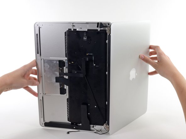

  32. MacBook Air 13" Early 2014 Upper Case Replacement: crwdns2935265:032crwdnd2935265:01crwdnd2935265:01crwdne2935265:0
    • Open the display so that it is perpendicular to the upper case and place it on a table as shown.
  33. MacBook Air 13" Early 2014 Upper Case Replacement: crwdns2935265:033crwdnd2935265:01crwdnd2935265:01crwdne2935265:0
    • While holding the Air steady, remove the remaining 4.9 mm T8 Torx screw from the display bracket.
  34. MacBook Air 13" Early 2014 Upper Case Replacement: crwdns2935265:034crwdnd2935265:01crwdnd2935265:01crwdne2935265:0
    • Flip the computer over so the last display screw is more easily accesible.
    • Before removing the final display screw, be sure to hold the display and upper case steady with your other hand. Failure to do so may allow the components to fall onto the table, causing potentially expensive damage.
    • Remove the last 4.9 mm T8 Torx screw securing the display to the upper case.

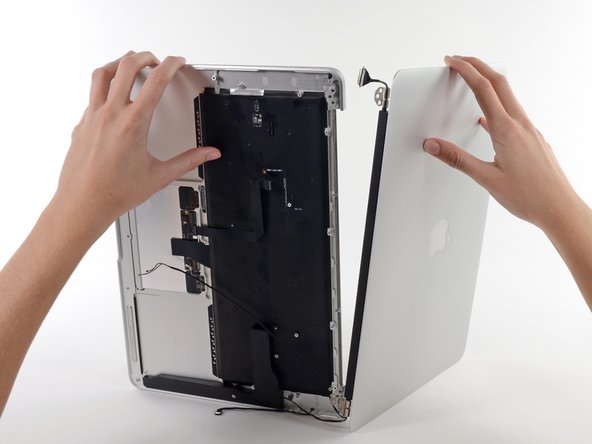

  35. MacBook Air 13" Early 2014 Upper Case Replacement: crwdns2935265:035crwdnd2935265:01crwdnd2935265:03crwdne2935265:0 MacBook Air 13" Early 2014 Upper Case Replacement: crwdns2935265:035crwdnd2935265:02crwdnd2935265:03crwdne2935265:0 MacBook Air 13" Early 2014 Upper Case Replacement: crwdns2935265:035crwdnd2935265:03crwdnd2935265:03crwdne2935265:0
    • Open the Air slowly until the hinges slide out of their notches.
    • Once the two display hinges have cleared the upper case, remove the display and set it aside.

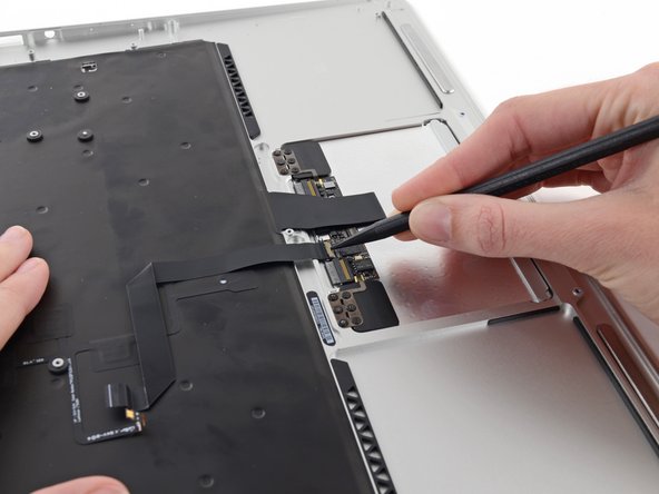

  38. MacBook Air 13" Early 2014 Upper Case Replacement, Upper Case: crwdns2935265:038crwdnd2935265:01crwdnd2935265:03crwdne2935265:0 MacBook Air 13" Early 2014 Upper Case Replacement, Upper Case: crwdns2935265:038crwdnd2935265:02crwdnd2935265:03crwdne2935265:0 MacBook Air 13" Early 2014 Upper Case Replacement, Upper Case: crwdns2935265:038crwdnd2935265:03crwdnd2935265:03crwdne2935265:0
    • Use the tip of a spudger or your fingernail to flip up the retaining flap on the trackpad ribbon cable ZIF socket.
    • Pull the trackpad ribbon cable straight out of its socket toward the rear edge of the Air.
  39. MacBook Air 13" Early 2014 Upper Case Replacement: crwdns2935265:039crwdnd2935265:01crwdnd2935265:02crwdne2935265:0 MacBook Air 13" Early 2014 Upper Case Replacement: crwdns2935265:039crwdnd2935265:02crwdnd2935265:02crwdne2935265:0
    • While carefully lifting the keyboard ribbon cable with one hand, use the tip of a spudger or your fingernail to flip up the retaining flap on the keyboard ribbon cable ZIF socket.
    • Pull the keyboard ribbon cable straight out of its socket toward the front edge of the Air.
